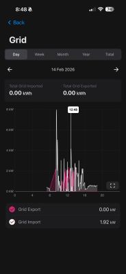

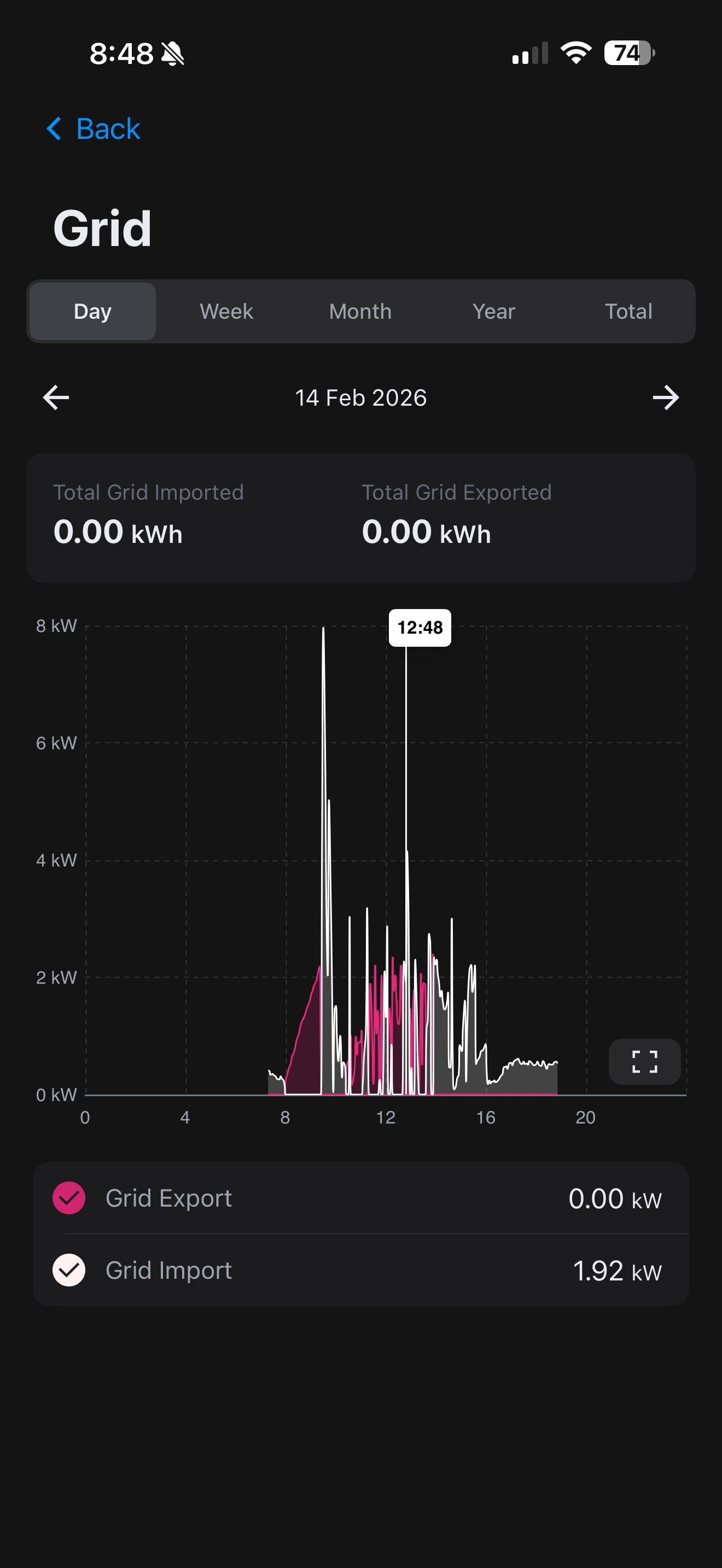

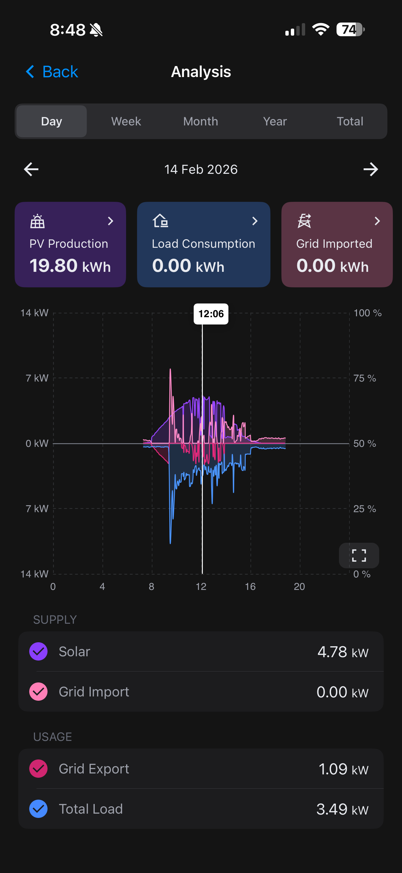

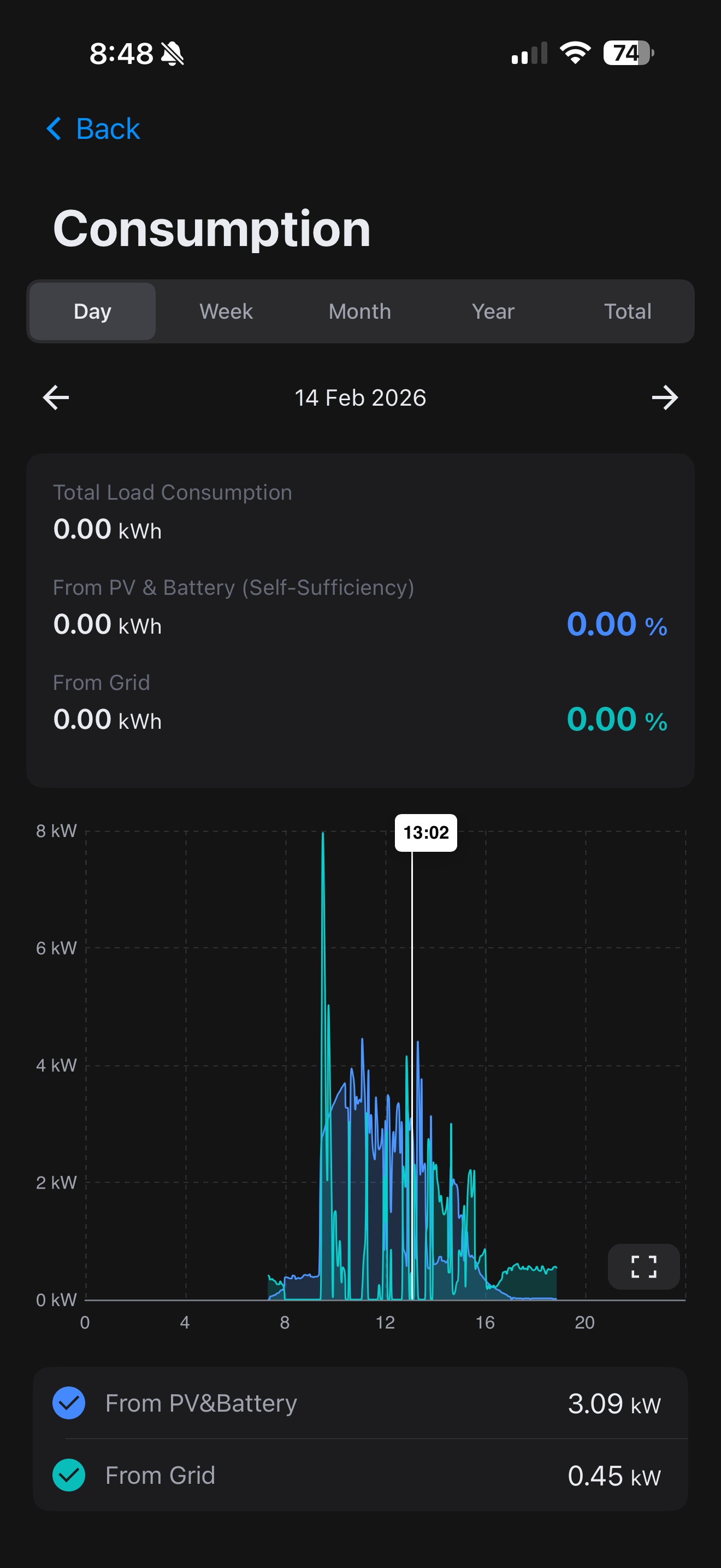

In the Fox app I can see PV production totals for the day (e.g. 19.8 kWh yesterday) and I can see real‑time / time‑stamped kW values for load, grid import and grid export on the graphs.
However, the “Consumption” and “Grid” pages show 0.00 kWh for total load, total grid import and total grid export for the day, rather than daily totals.

Yes it is a limitation of Fox solar only inverters, only the hybrids store daily, weekly statistics for load, grid use etc.. the CT clamp will have given you real time usage so you can see the actual power used, but not the totals.
If you are interested in adding a home assistant and connect it to the cloud, that can take your information and aggregate it into the totals you are looking for, which will re-create all of the statistics that Fix cloud doesn't show you.
