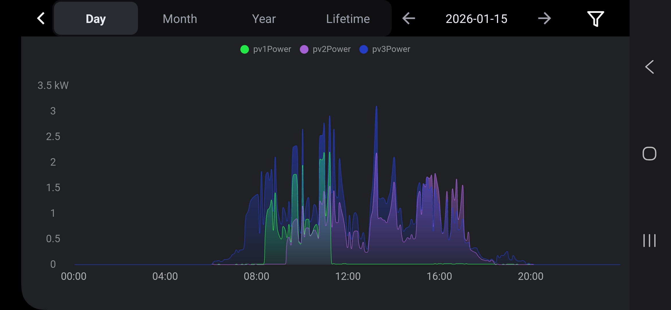

Here's an example where the 3 strings appear to be active most of the day. PV3 is always active, PV1 comes on around 8am, PV2 comes on around 10am. All 3 are generating through to dusk.

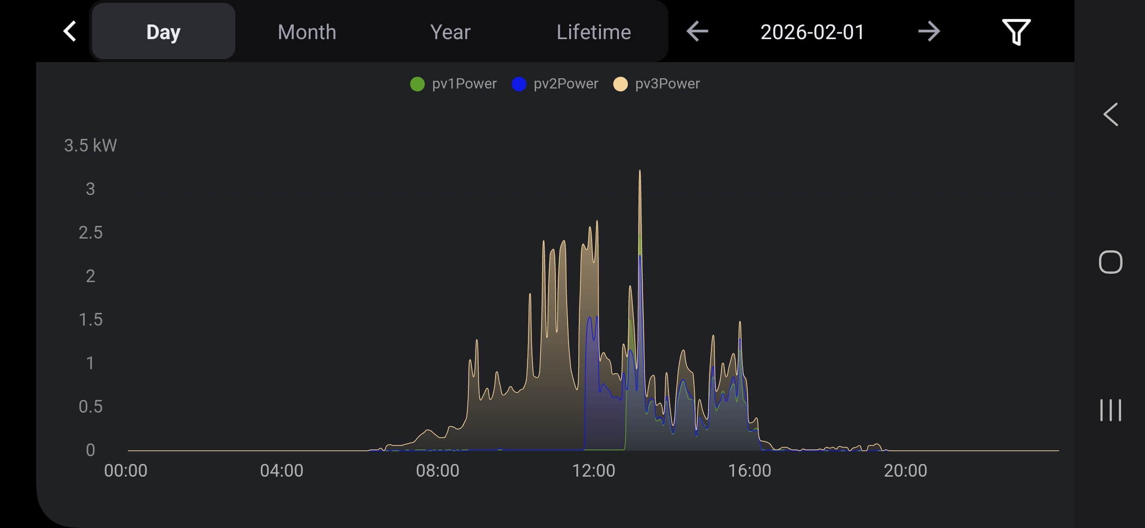

The previous day however, PV2 switches on at 12pm and PV1 at around 1pm

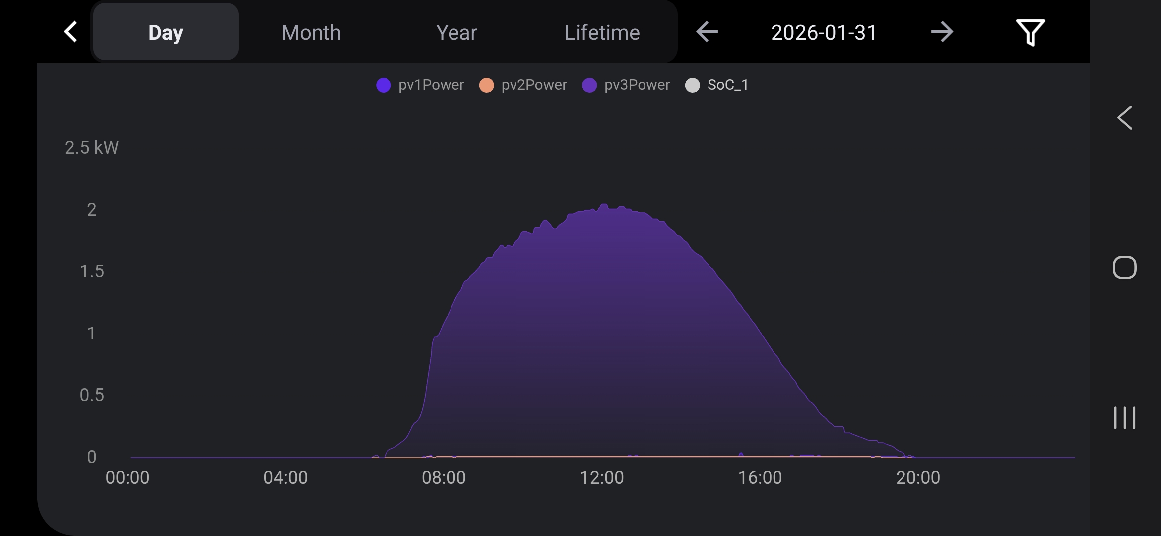

I also have some days where only PV3 switches on

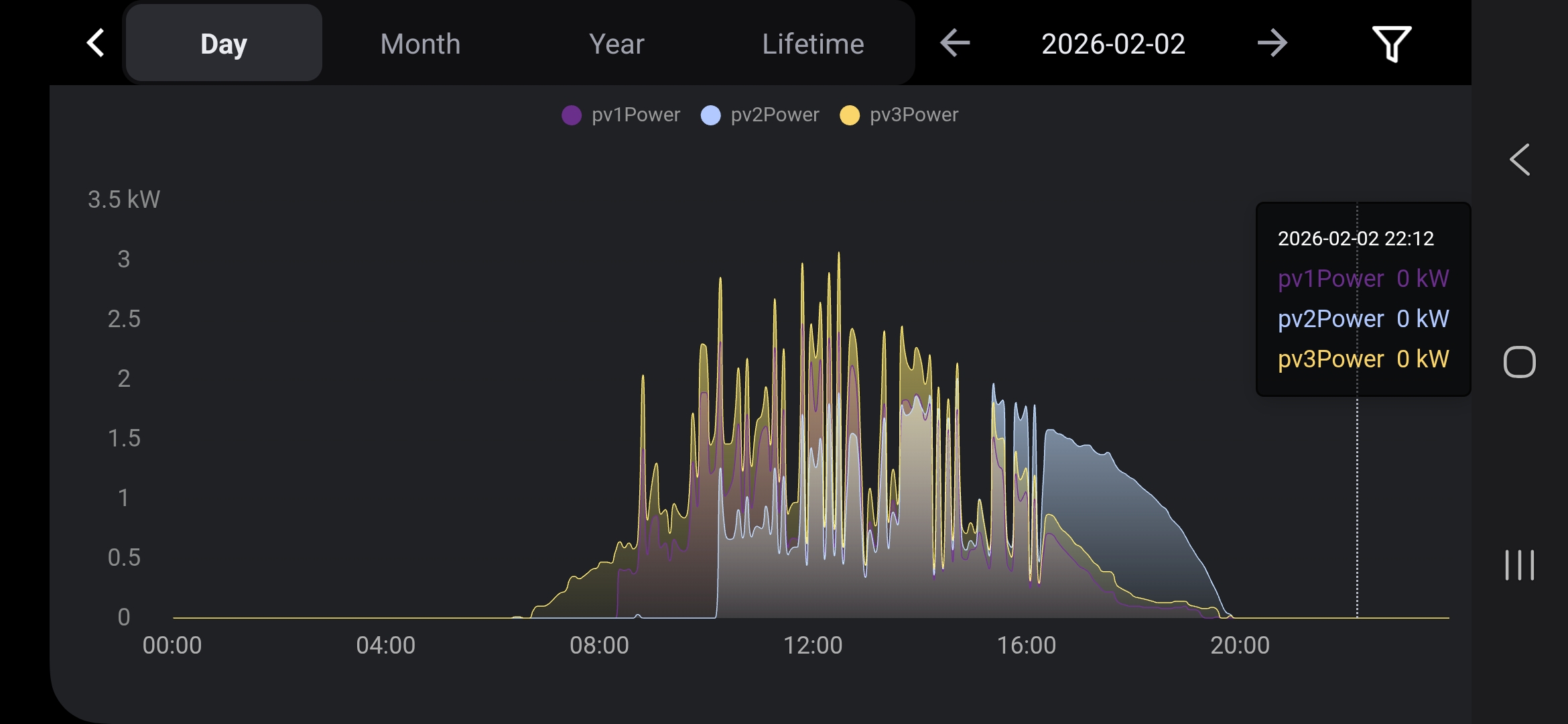

And some where the other strings get switched off intraday.
The switching off of the strings is somewhat correlated with generation exceeding consumption and the battery getting full, although it tends to lag. It's also frustrating as I should be fine to export excess power generated.

I cannot answer everything for you, but you have in theory plenty of capability with your 15kW H3 to mop up all of the solar you can produce 14x490W = 6.86 kWp of potential power.
You show a graph for PV3 that was the only string that activated, and showed a normal hump curve, and you would expect the 3 strings to show a similar output given your capacity.

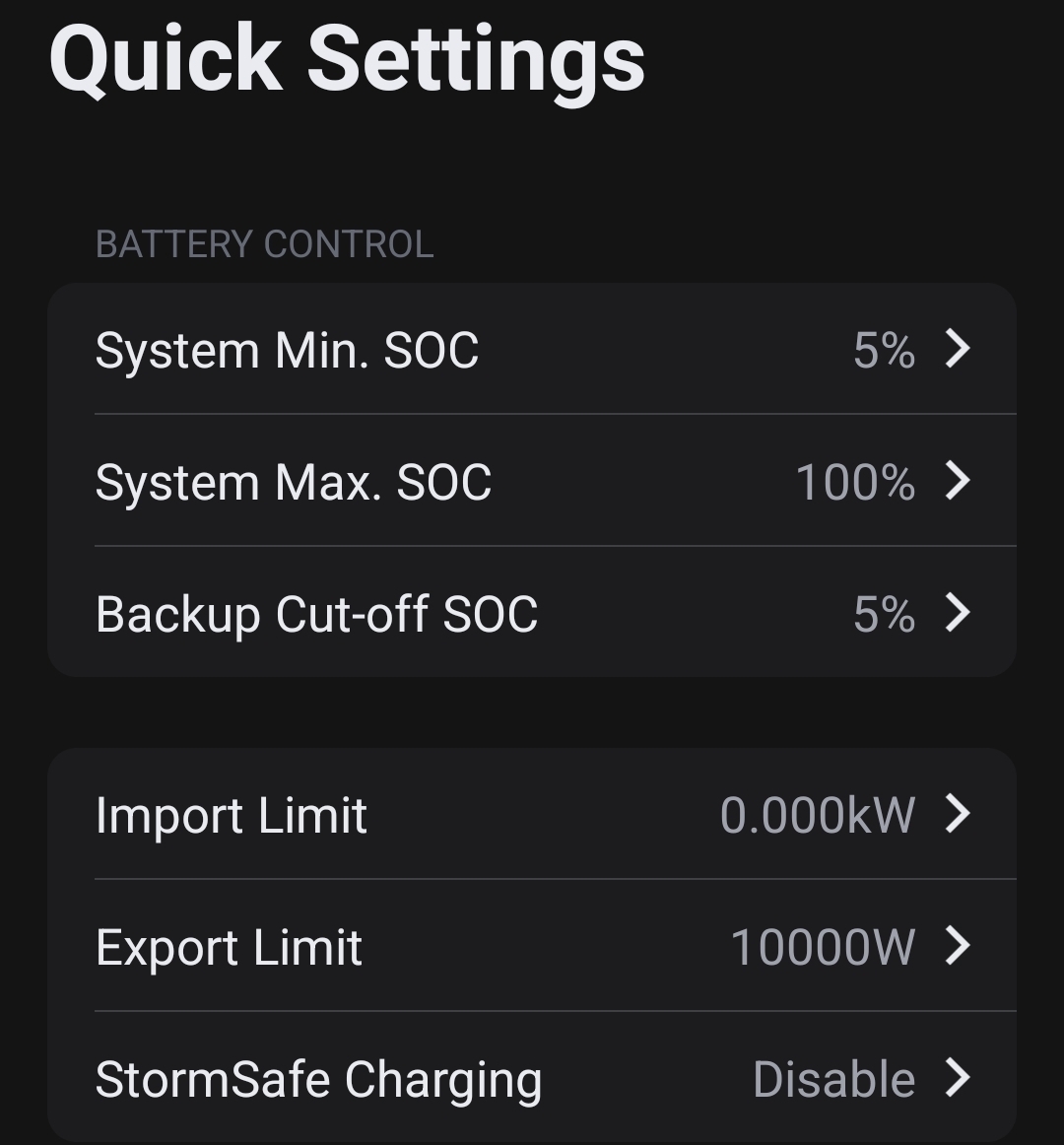

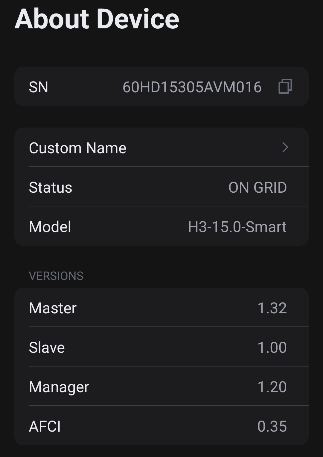

My settings (below) are pretty standard I think. Although potentially I read that the export limit can be overridden on the installer's end. Software I believe is up to date (screenshot below as well) System is only being run in self use mode, haven't played around with anyone else.

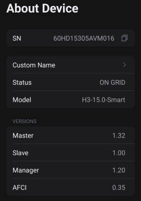

You may have to go to the Inverter screen and look at the system settings, to check Import/Export and battery values for the Current and Power.
I do see the Import power is set to 0W not seen that before.

I've checked those settings and everything looks normal to me (same as on those videos). Have set the import limit above 0W now, although I don't expect much impact from that. I'm still kind of at square one although potentially the installer will be able to better illuminate what is going on.
