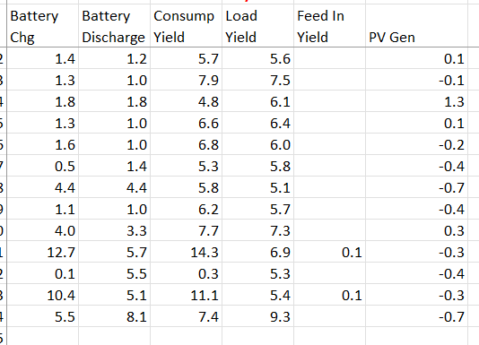

I've just had the panels, etc installed and over the past week or so have been using the above formula to see what is being generated during these winter days. However, on quite a few days I'm getting a negative number. I stated force charging the battery overnight after a few days. My stats have been as attached
How do I get negative results from the PV?
The calculation doesn't and hasn't ever worked for me. Today we generated 1.2kWh but the calculation gives -0.1kwh. It's due to losses inevitably being taken into account. This occurs when you force charge or discharge - basically any time you have a DC-AC or AC-DC conversion happening. It was so bad that October was over 50kWh under the real figure using the calculation for me. Some days were as low as -2kWh. Its totally useless.
It's why it's so annoying that Fox still don't give the PV production total.

The problem with the calculation is to get to solar generated it has to discount all the other measurable items, and the problem with that is there are losses involved in some of the conversions, so form example you get a loss when you convert AC to DC to charge the batteries and in the battery chemistry, likewise when you got from DC to AC to power the house and when solar is generated, on top of that is the power that the inverter itself uses (30-100Wh).
It can be between 1 to 2kw a day in combined losses, that's why you end up with the negatives as the formula unfairly lumps all of those losses into the solar generation line and those losses will appear higher at this time of year as the battery is charging more from grid and there is little solar.
As @Reef said the inverter does have an internal PV counter that says how much solar it generated that day (for the life of me my Foxess don't just expose this in the app i'll never know) - if you create a home assistant (a mini computer running a simple operating system) all of these things are visible and you can work out real time system losses as well, it's well worth the investment in time.
