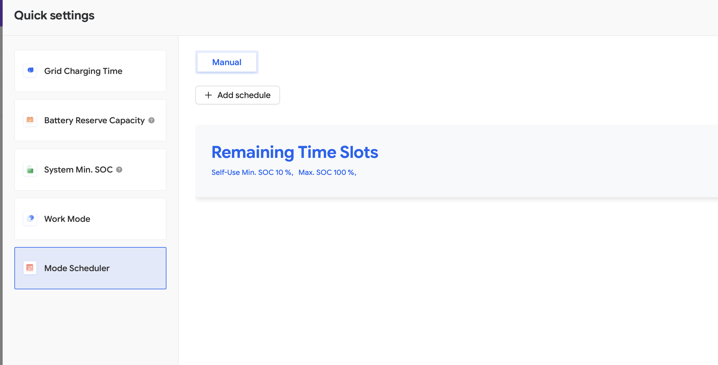

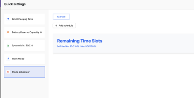

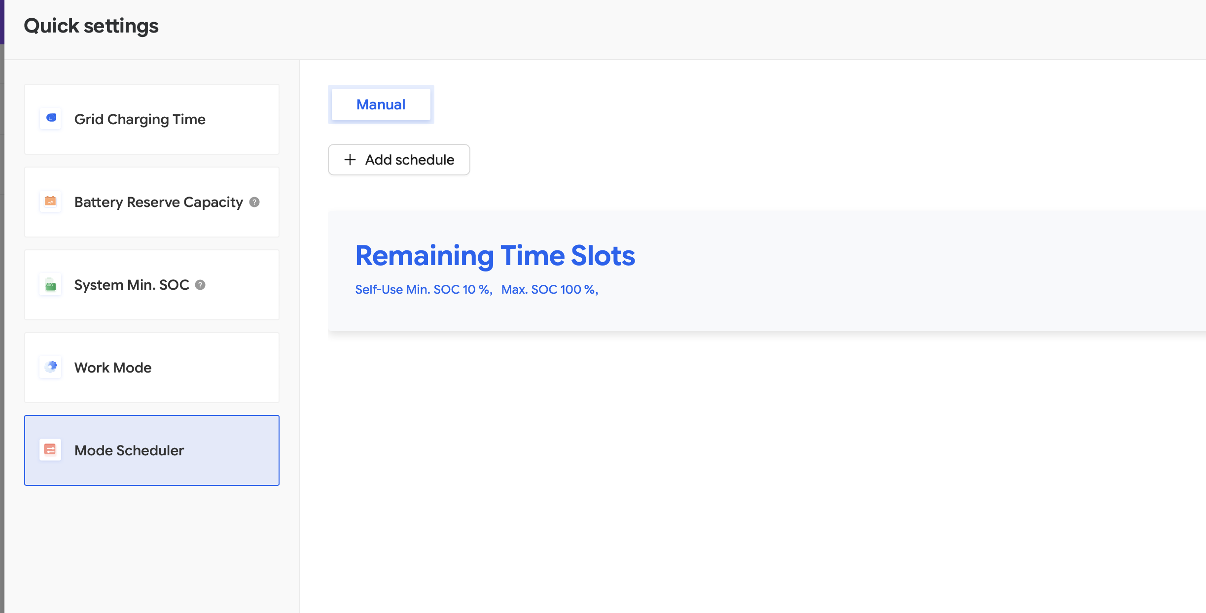

I have nothing set in Mode Scheduler but can not get the "grid charging time" to accept y off peak times, just keep getting "44098-Write failed" - the app used to work fine, I have had to use the online version on my Mac to try and do this ( as there seems to be no battery time charge control there anymore -why?) . Is the work around to use the scheduler instead? (if that works......)
This is what I see in scheduler (I cant get rid of this "remaining time slots' which may be the issue)
