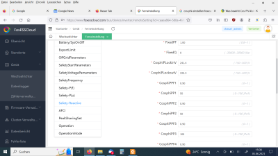

can somebody tell me how to adjust the Power Factor in Fox ESS inverters. Especially the T20-G3 Series?
In the Datasheet its mentioned that you can adjust the Power Factor from 0.8 to 1 cos phi. But there are no power factor at the settings?
Also in the manual its not mentioned how to set the power factor?
best regards
Jim
Re: How to Setup / Adjust Power Factor on Fox ESS Inverters?

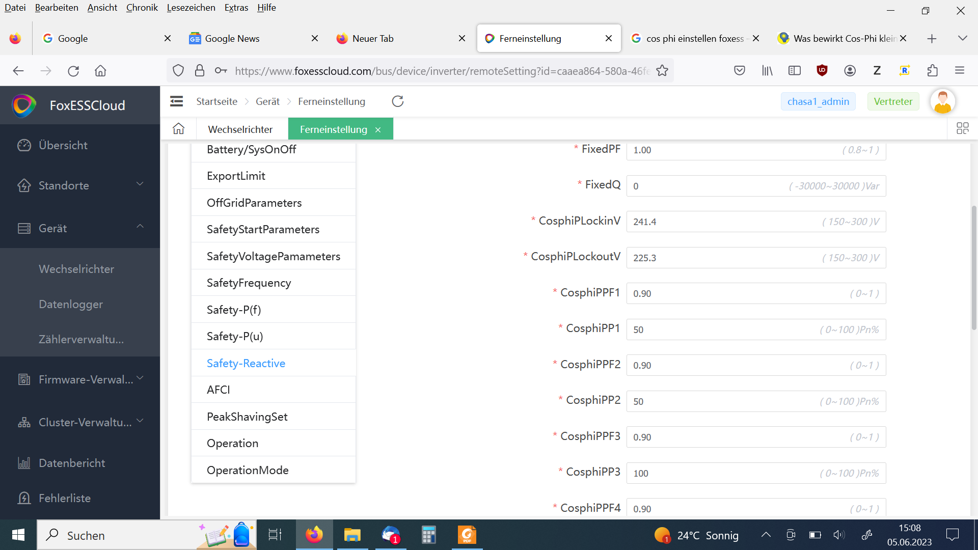

See attachement
