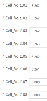

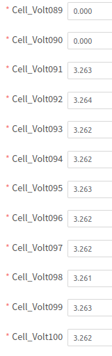

I think we need to delve a little deeper to see if we can narrow things down - the message implies that one of the cells is too low which is not easy to see - can you plot your BMS cell mv high and BMS cell mv low for that same time period, and I guess for completeness we should have a look at BMS cell temp high and low - we're looking for imbalance so it's the bigger difference between the high and low which is bad.
It would be useful if you could log onto your agent account and look at the individual cell voltages when the battery is about 50% - you'll see the cell volt from 01-16 (17,18 will be blank) - that is pack No1, it then repeats from 19-34 (35,36 blank) pack No2. etc.. when you look at it you'll have individual cell voltages (say 3.25) and they should all be within a small tolerance of that. At 50% you'd probably expect the tolerance to be no more than 20mV - do any of the cell volts stand out ? - it could be a single cell that is badly balanced or a range of cells near the floor in the coldest pack.

I'll swap the Wifi modules over later this evening when the SoC should be about right and see what I can see. Once again thanks - how the heck you would troubleshoot this as an "ordinary user" (ie without logging or visibility of the various system parameters) I have no idea. Althought I suppose you can always just do the battery balancing thing anyway and hope...

They are slightly out of balance for a pack that isn't charging, it's not a huge amount but in the scale of things 36mV can make a 10% difference in the capacity measurement.
The rest of the information you posted all looks to be fine.
I would suggest you add a sensor to track the cell imbalance, Tony has written something to do that in the sensors section so i'll go and grab it and paste it here (thanks Tony :) ) - that way you can easily see the imbalance at any time - normally you would expect about .15% but it goes up during charging (>3%) as it approaches 100%, the main thing is it should spend a lot of it's time below 0.5%
This is my battery 'im'-balance
I have heard a few people say after the latest firmware upgrade the BMS threw a Bat volt fault, but a slow charge sorted it out - so I think the next thing to do is to give the BMS a chance to re-balance the cells with that and then monitor your cell imbalance.
