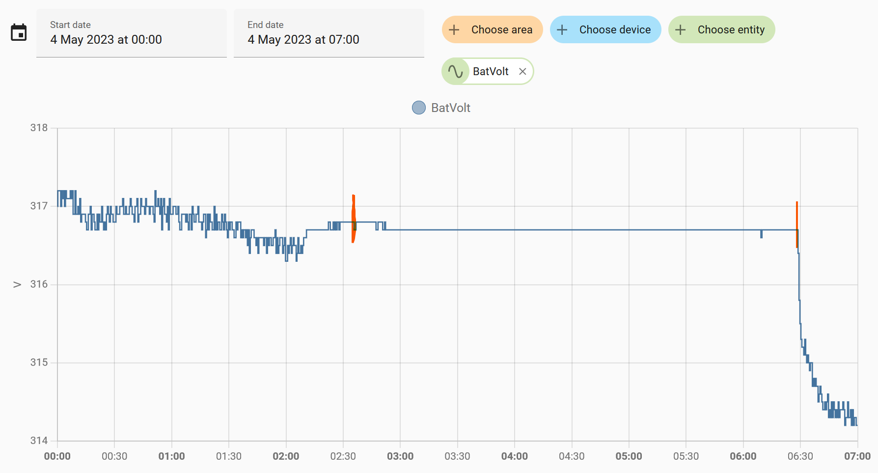

For what it's worth the battery voltage trace in Home Assistant shows no abnormalities, it simply flatlines once the BMS goes into the error state.

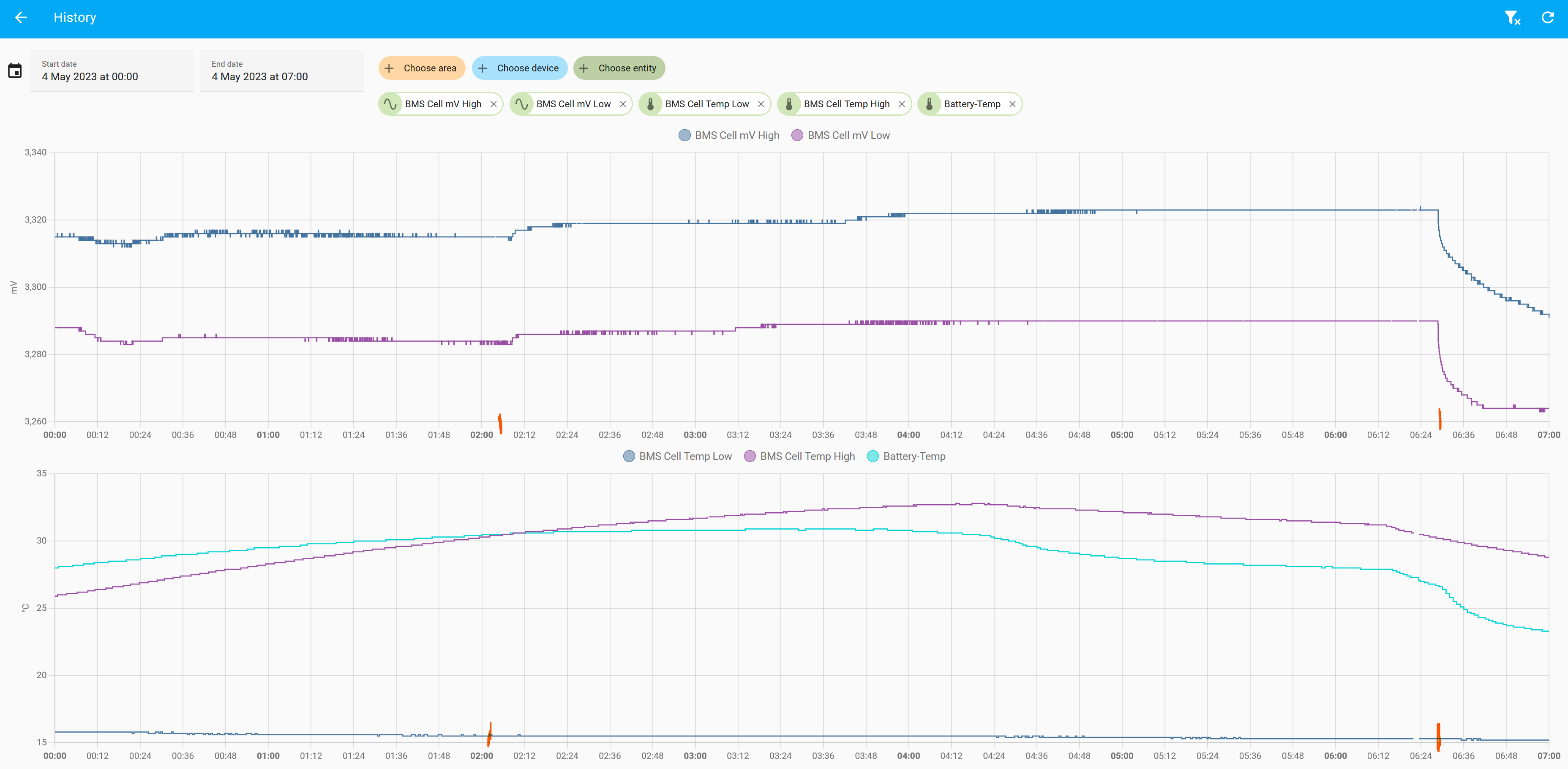

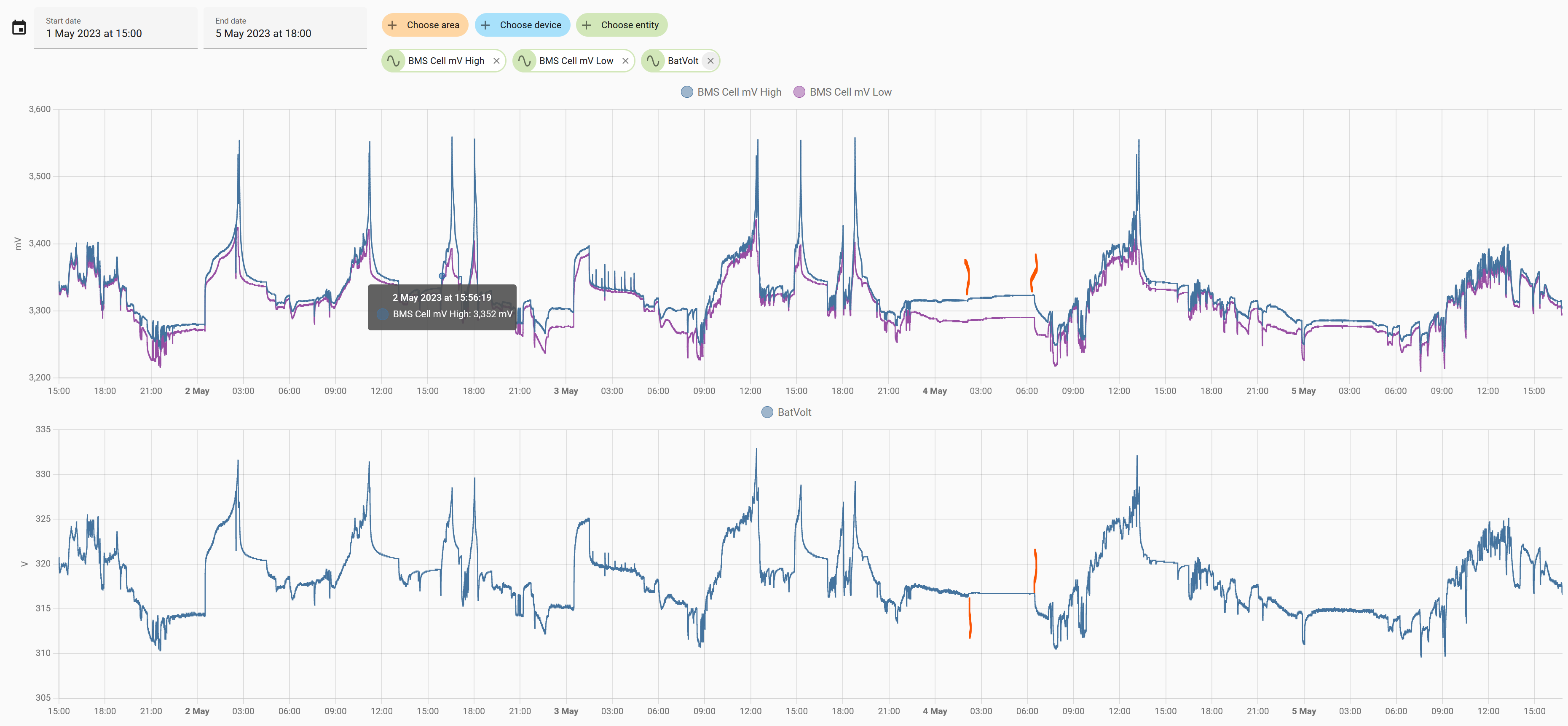

It's not obvious from that why it would throw a bat volt fault, the battery voltage for the stack looks good, translating that to cell voltages it's probably around the 3.3v point and so 60-70% soc.

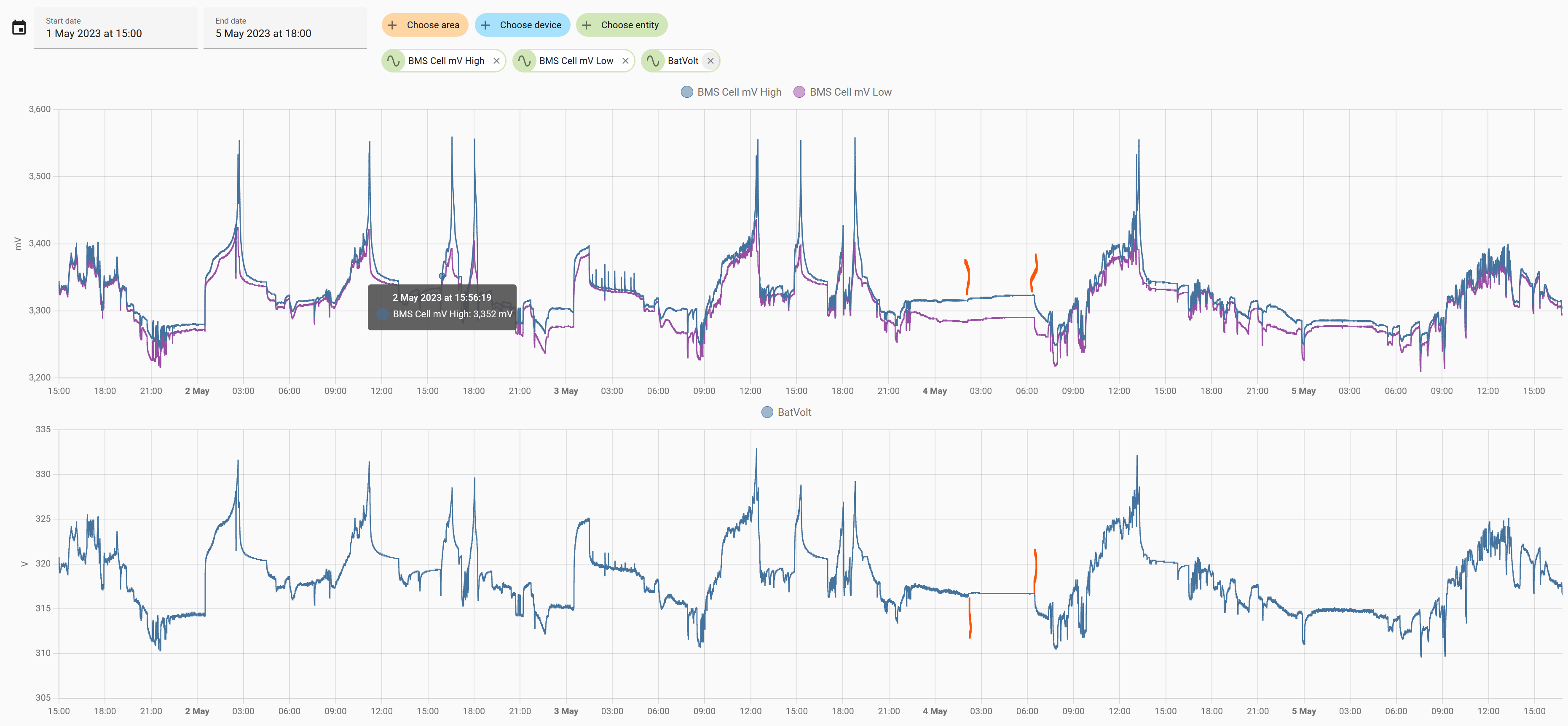

I think we need to delve a little deeper to see if we can narrow things down - the message implies that one of the cells is too low which is not easy to see - can you plot your BMS cell mv high and BMS cell mv low for that same time period, and I guess for completeness we should have a look at BMS cell temp high and low - we're looking for imbalance so it's the bigger difference between the high and low which is bad.

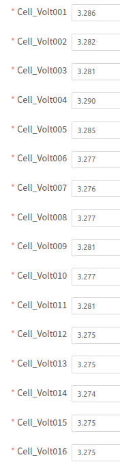

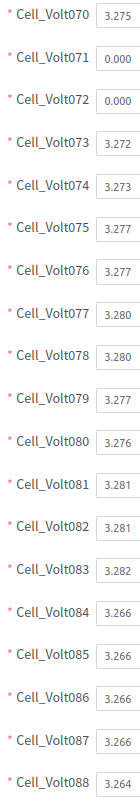

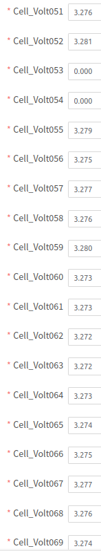

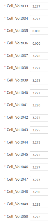

It would be useful if you could log onto your agent account and look at the individual cell voltages when the battery is about 50% - you'll see the cell volt from 01-16 (17,18 will be blank) - that is pack No1, it then repeats from 19-34 (35,36 blank) pack No2. etc.. when you look at it you'll have individual cell voltages (say 3.25) and they should all be within a small tolerance of that. At 50% you'd probably expect the tolerance to be no more than 20mV - do any of the cell volts stand out ? - it could be a single cell that is badly balanced or a range of cells near the floor in the coldest pack.
The belt and braces attempt to correct balance is to allow the batteries to discharge to 10% and leave them like that for at least a couple of hours (the charger will cycle occasionally to maintain).
The next step is to charge your batteries from grid to 80% then reduce your max charge current to 4A and grid charge to 100%, and leave it with charging on for a couple of hours after it reaches 100%.
it will take some time to do this manually, it is actually easier just to set the low charge (4A) and leave it like that for the whole night - the most important thing is giving it time to float charge when it is at 10% and 100% - this gives the batteries time to absorb charge, and for the shunts to dissipate excess cell volts all of which helps with balance.

Having read your post (for which many thanks), I was kind of hoping to see something very obvious.
At this scale, maybe not so much, but...

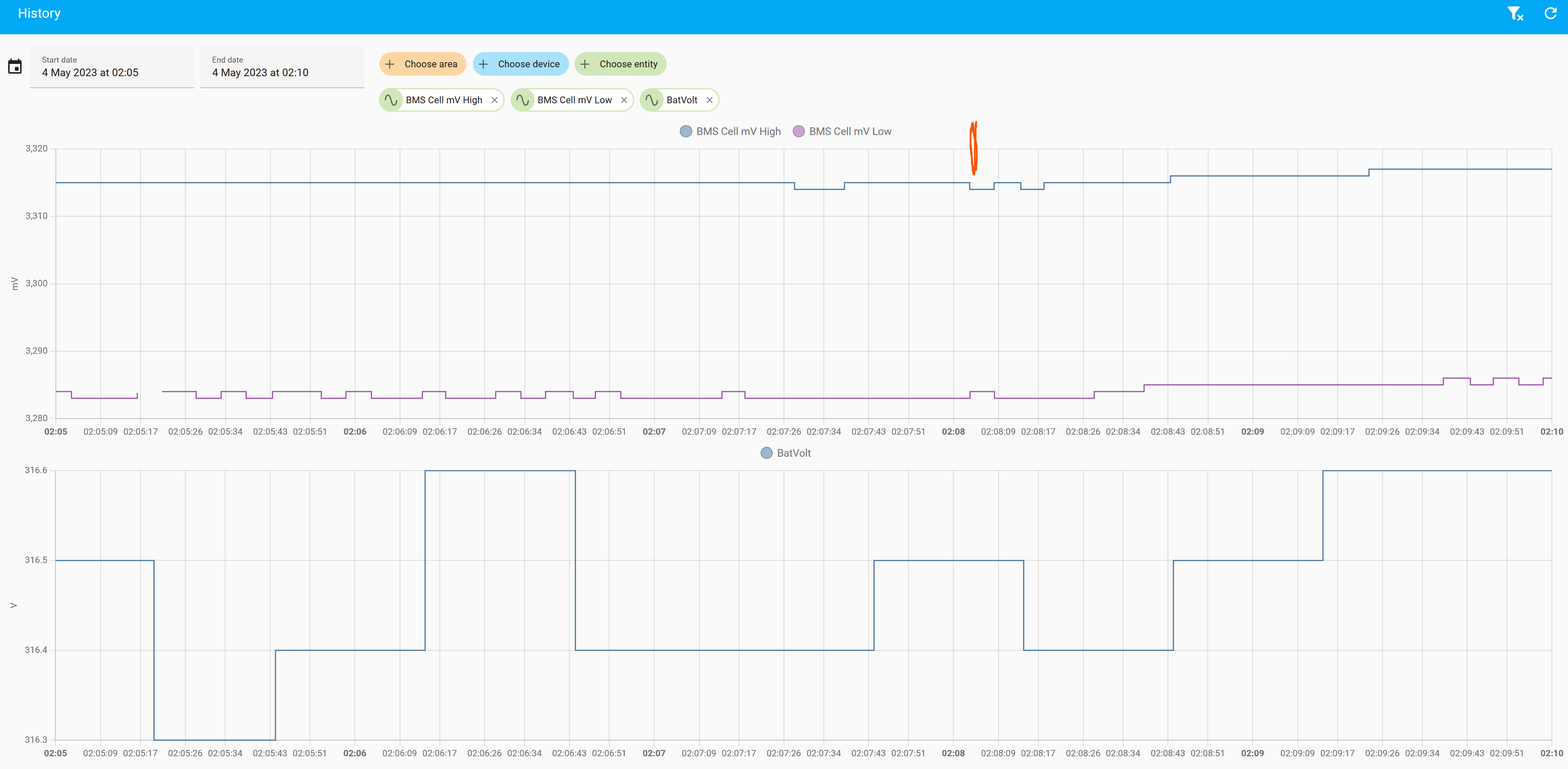

It looks like a relatively wide gap compared to the rest of the trace, at least when the battery is in a quiescent state? Right at the point of the error the difference is 30-31mV (the logging isn't frequent enough to say exactly):
I checked the SoC for the same time period and it was 71%, for reference.
I'll swap the Wifi modules over later this evening when the SoC should be about right and see what I can see. Once again thanks - how the heck you would troubleshoot this as an "ordinary user" (ie without logging or visibility of the various system parameters) I have no idea. Althought I suppose you can always just do the battery balancing thing anyway and hope...

Re: BMS weirdness

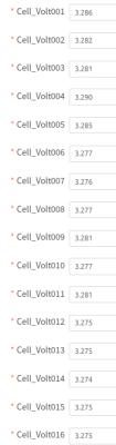

This is at 67% SoC and under ~1kW load, range of about 36mV (3297 to 3261). Certainly a wider range than the 20mV you mentioned earlier!
I'll have another look later when the SoC is lower and hopefully the load will be minimal.

They are slightly out of balance for a pack that isn't charging, it's not a huge amount but in the scale of things 36mV can make a 10% difference in the capacity measurement.
The rest of the information you posted all looks to be fine.

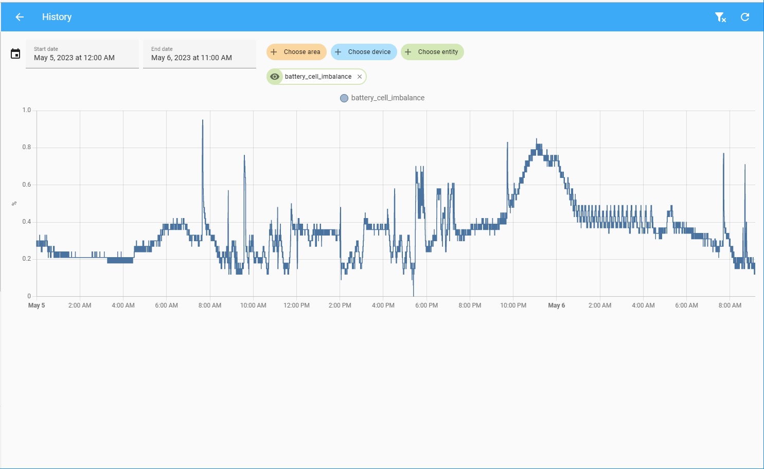

I would suggest you add a sensor to track the cell imbalance, Tony has written something to do that in the sensors section so i'll go and grab it and paste it here (thanks Tony :) ) - that way you can easily see the imbalance at any time - normally you would expect about .15% but it goes up during charging (>3%) as it approaches 100%, the main thing is it should spend a lot of it's time below 0.5%
This is my battery 'im'-balance
I have heard a few people say after the latest firmware upgrade the BMS threw a Bat volt fault, but a slow charge sorted it out - so I think the next thing to do is to give the BMS a chance to re-balance the cells with that and then monitor your cell imbalance.
