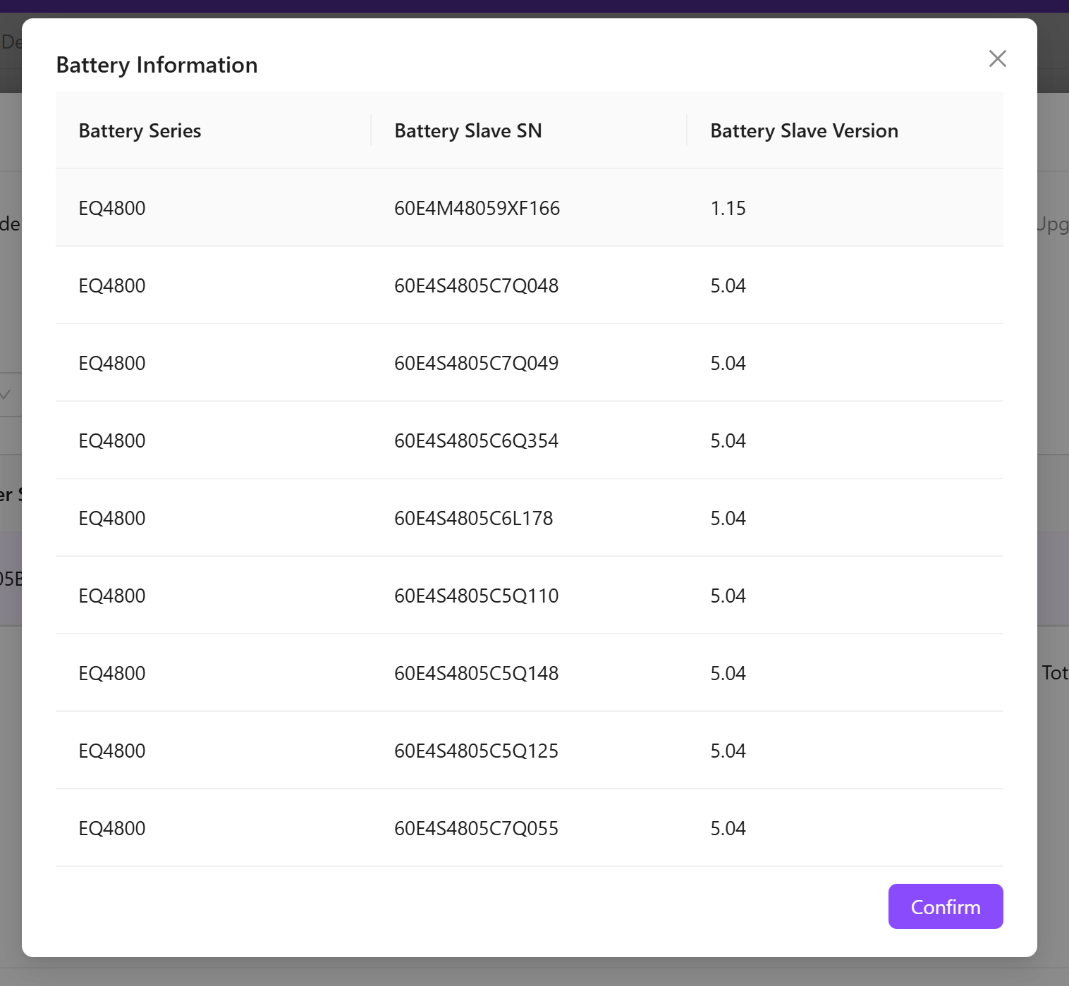

I have a full stack EQ4800 and I have noticed that the 1st module firmware version (1.15) is different to the other 8 modules (5.04). The other 8 originally had 5.02 until I requested an update to 5.04 but the 1st one stayed the same. Is this normal for the 1st module as it is physically different to the others?
The only other firmware available other than 5.04 on FoxCloud for my battery is 1.15. Should I flash that and then retry 5.04?

Your upper battery is the ‘-M’ which is the battery stack master (and has an internal slave @ 1.15), the remaining units are ‘-S’ which just contain the slave and they run a different firmware version.
So when you look at your stack you will have 1 firmware version for the slaves (BMU) and the other is the master (BCU) which is always the top battery.

Dave Foster wrote: ↑Mon Jan 19, 2026 11:06 am Your upper battery is the ‘-M’ which is the battery stack master (and has an internal slave @ 1.15)
That makes sense, thank you. So is the reason that the internal slave firmware for the stack master isn't updated like the others because the master firmware overrides it functionally?

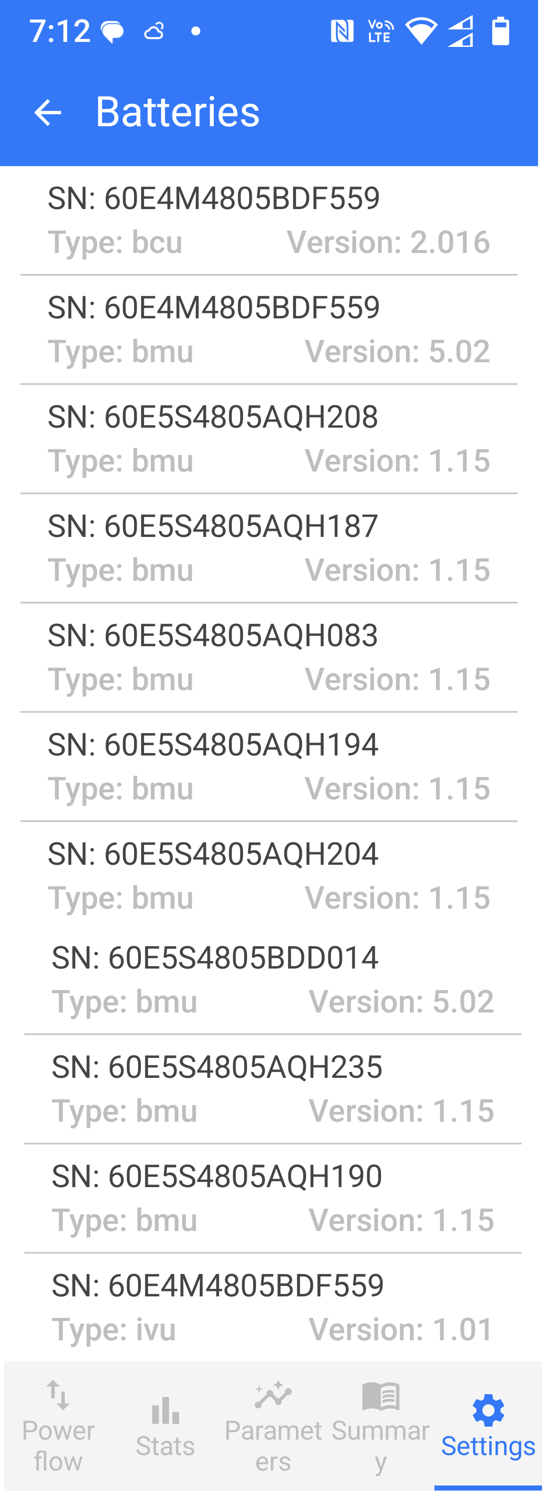

I found these stats on my EQ4800 stack in Energy Stats today, i've got bmu, bcu, even icu, various 'releases', can anyone advise what it all means and should i be contacting Fox support to get them to bring things up-to-date?
