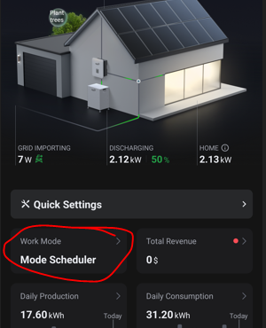

Apologies if I've posted this in the wrong place but my limited knowledge lets me think you are all talking around a similar problem I have.
I had a new in PV system with battery installed last June. We are an all electric house (apart form the wood burners) and use Night Storage Heaters charged from cheaper Off Peak electricity. After discussion with my installer in October he made changes to my FOXCloud settings so that my battery would be topped up during the night (1am to 5am) so that in the morning we have a full battery should it not be a productive PV day and have to use peak rate electricity.
In the interim period FOX Cloud app has changed and I do not recognise any of the settings to change back to the summer settings of requiring no overnight top up.
The current setting I see on the App is NORMAL / SELF USE
Can anyone guide me please to how to change the settings, TIA

I'm fairly new to all this too, but if it is the same as mine, then you will have Work Mode set to Mode Scheduler. When I schedule is not in operation then it will default to Self-Use (which is what you probably want normally). If you click on that and edit the schedule you can disable the current schedule so it isn't used. Don't delete it just disable it. Then whenever you want it again you can enable again.

Thank you for that guidance and this appears to have solved my issue - Cheers
