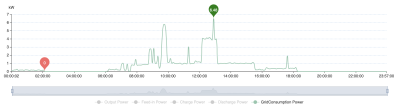

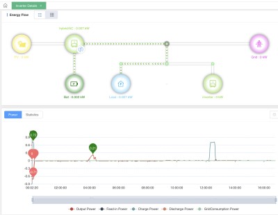

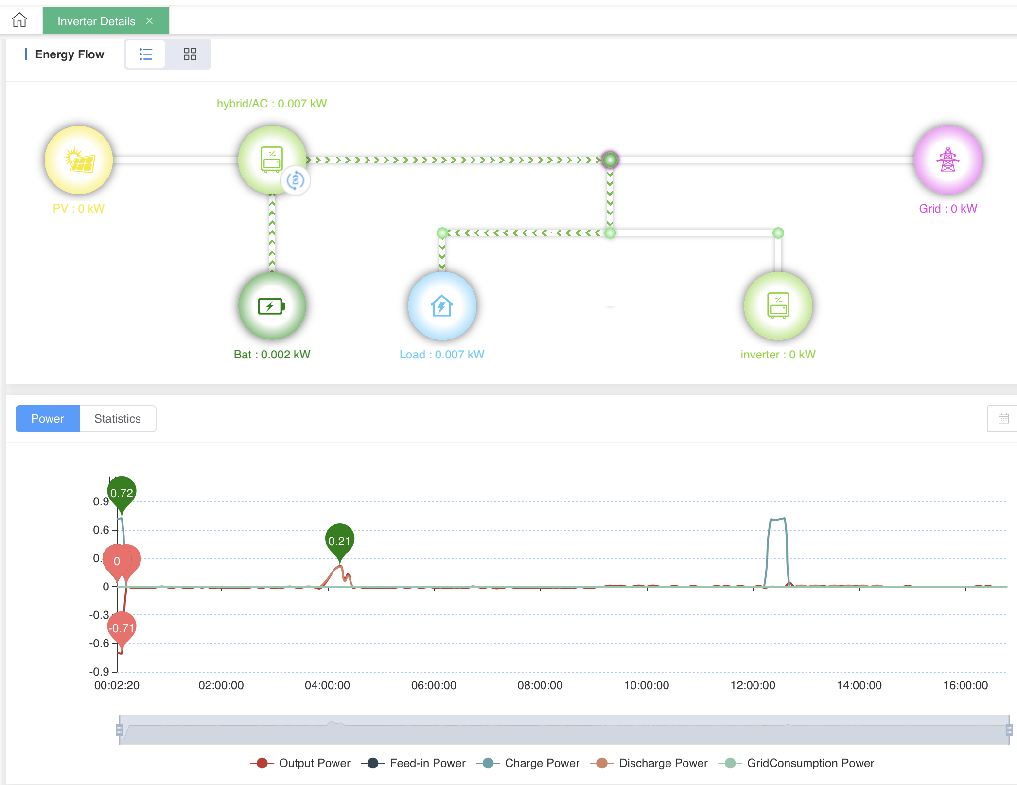

However something seems off. All the measurements seem to be flatlining.
The load of 7W is not realistic. It is showing 0W Grid usage even though I'm using it. PV isn't registering any amps even thought he PV voltage is 520V as expected.

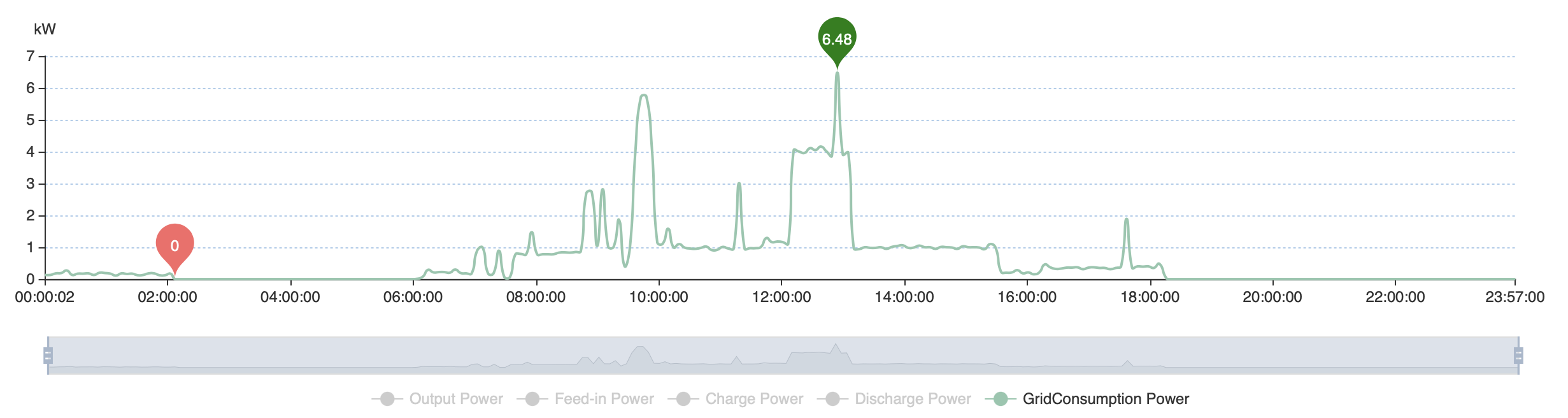

Usually the Grid Consumption line graph is very active and shows peaks of times of high usage. But now it seems to be flat-lining and doesn't seem to be showing any activity for the day. Even though I've had a normal day of usage (pool pump on, boiled kettles etc). The CT clamp does at least visually look connected as it was before.
Can someone tell me what could be wrong?

Last night we had a rolling blackout and this drained a bit of the batteries to keep the house going.
This morning I noticed some action from the PV!
It seems the PV is being used to charge the batteries, but not for powering the house. Isn't that completely weird?
Yesterday my batteries were at 100% which is why it was drawing 0 Watts from the PV.
I can see the EPS watts for the house in the Inverter screen but Grid pGrid is always 0W. Wondering if this is all related to the malfunctioning CT Clamp / Grid Consumption monitoring?

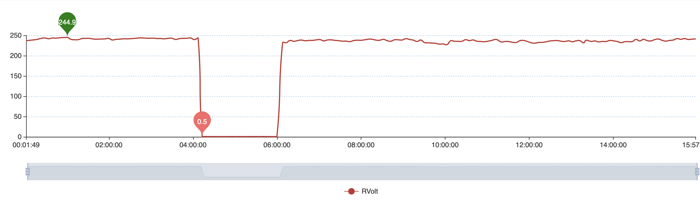

The second thing to check is your RVolt value, preferably on the website - there is a dropdown list on the lower graph which allows you to select RVolt, it helpfully displays the min and max, the maximum value is the one i’m interested in - is it high > 254V ?

Yes RVolt is constantly around the 240V mark (apart from during the rolling blackout 4am-6am).
What does RVolt represent - I've always wondered!
While we are on that, perhaps you can also help me understand what TVolt is for? These are both cryptically named.

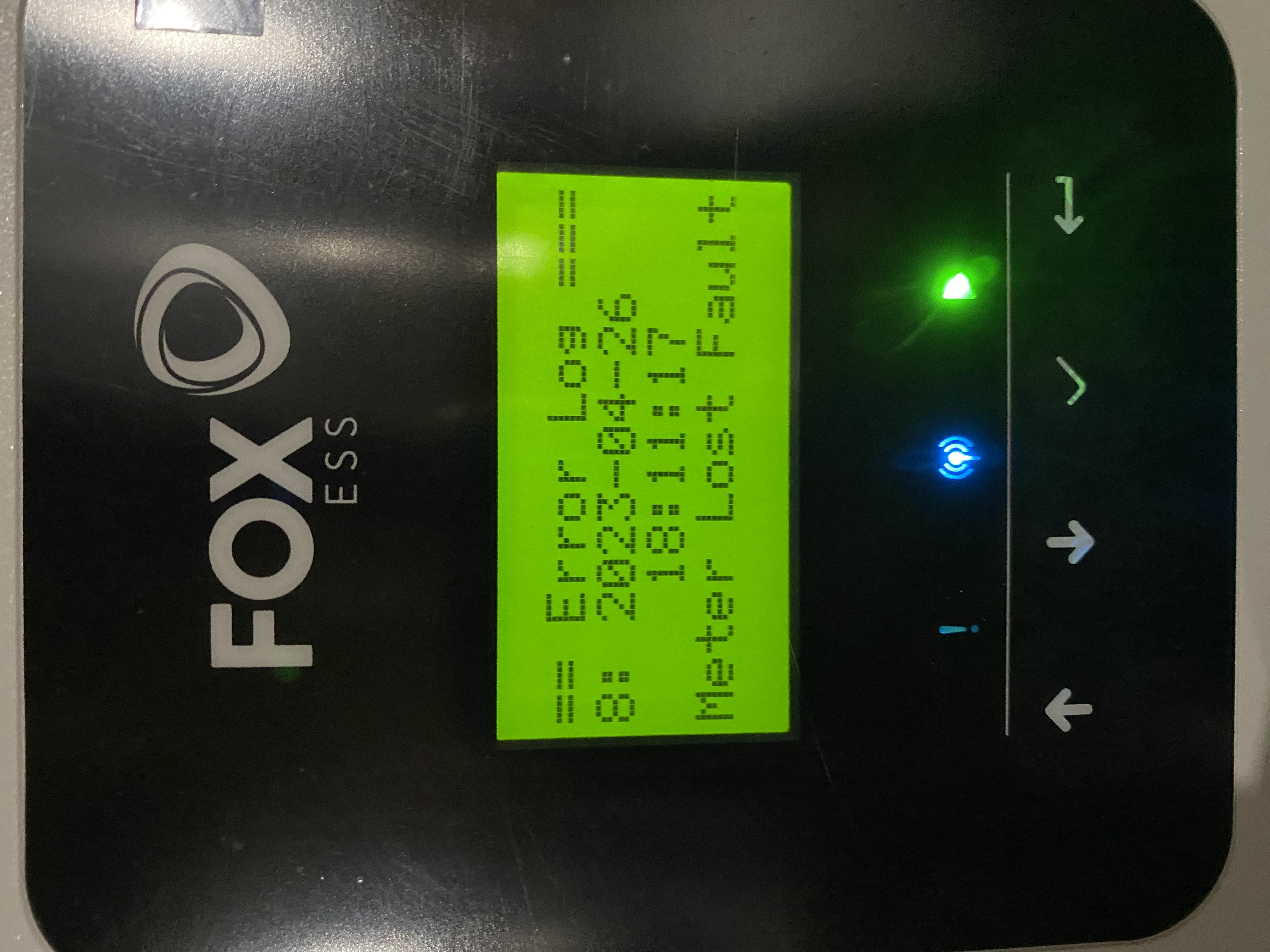

I found an error log which occurred at the exact time that my Grid Consumption line stopped working.
"Meter lost fault"
This is also the time the Installer was working on the system and hooking in the PV two days ago..
I do understand this implies that the CT clamp might have been disconnected, but don't know how to fix this...any ideas? Should I unplug it and plug it in again? I also am not sure if it was a temporary error or an ongoing error, as would it show when it was reconnected, assuming it was reconnected?

Some charts at the time of the problem 18:11.

Ok, voltage is fine - from what you have said and co-incidentally when the installer was wiring up your PV the meter (CT) was lost - I suspect as the CT wires go into the connector next to the PV connectors that the installer has disturbed the CT wires and one of the cores has broken away from the connector. This is quite common because the CT cable cores are very thin and break if the screws in the connector are over tightened, it only takes a nudge sometimes for them to break.
Next steps depends on how much you want to get involved, the easiest way is to ring your installer and let them re-terminate the cable (recommended), the more difficult way is for you to do it yourself, the connector is large and fiddly and would normally come apart with a special tool, but it can be done with a couple of flat bladed screwdrivers. - I’ll link to a thread where I posted some pictures recently so you can see what the connector looks like, the CT cable should be connected to pins 7(black core) & 8(white core).
On your comment on naming of RVolt is ‘Reference’ voltage - in this case the main grid, in 3 phase installations you have the R, then S (Secondary) and T (Tertiary)
