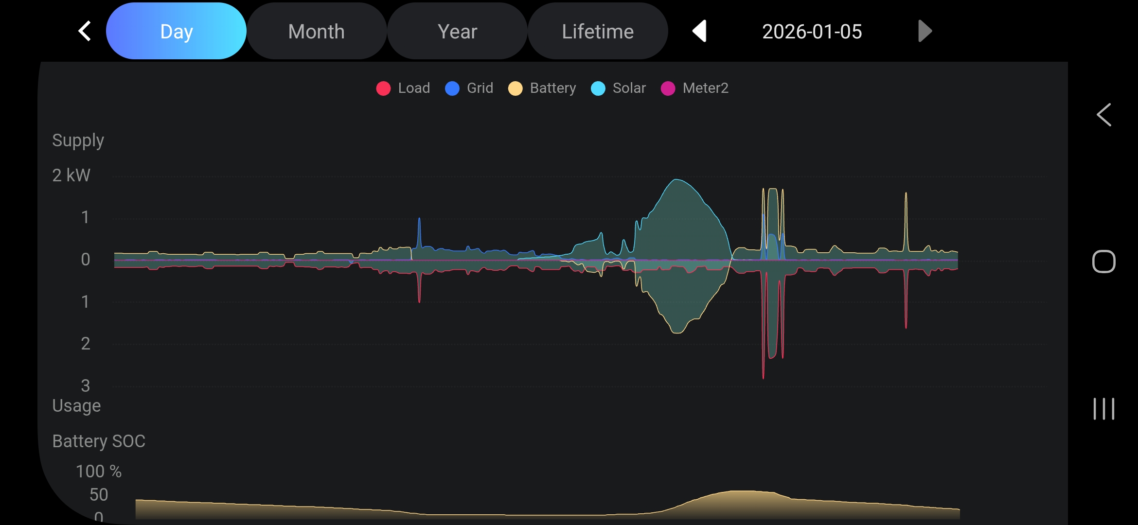

Have attached a graph, hope you can see it. Boiled a full kettle at 21.40, load didn't change. Load increased earlier when oven was on between 16.45 and 17.15 and always shows spikes when washing machine and microwave are on.

JC wrote: ↑Mon Jan 05, 2026 10:10 pm Have attached a graph, hope you can see it. Boiled a full kettle at 21.40, load didn't change. Load increased earlier when oven was on between 16.45 and 17.15 and always shows spikes when washing machine and microwave are on.
I would not say your grid CT clamp is backwards, looks like a nice fine graph to me. I am no expert though, so still need to know why your system shows different to energy supplier.
I cannot see if that bottom battery SoC line on your graph is reading 20% or 30%, but you can see it stopped dead in supplying power. Your solar then kicks in, and you can see the battery gains charge after not working at all for a few hours, you can clearly see your oven on, and the battery was supplying energy quite well. There is a spike I see, on right that looks like it was kettle, but no timeline to verify... but looks likely it was.
The graph only updates with data every 5 minutes, it’s possible a kettle boil would not show up on the graph if the last data sample was taken just before you started - it’s best to look at statistics (daily totals) for this (or apply a load for at least 6 minutes).
The trace looks correct all the phases are correct so the meter/ct is working ok and facing the correct direction - if there is a 25% difference to your utility provider I still think it may be a CT clamp with the wrong ratio, CT wiring that is excessively long (it is 10 metres standard but 20 metres is an absolute maximum).

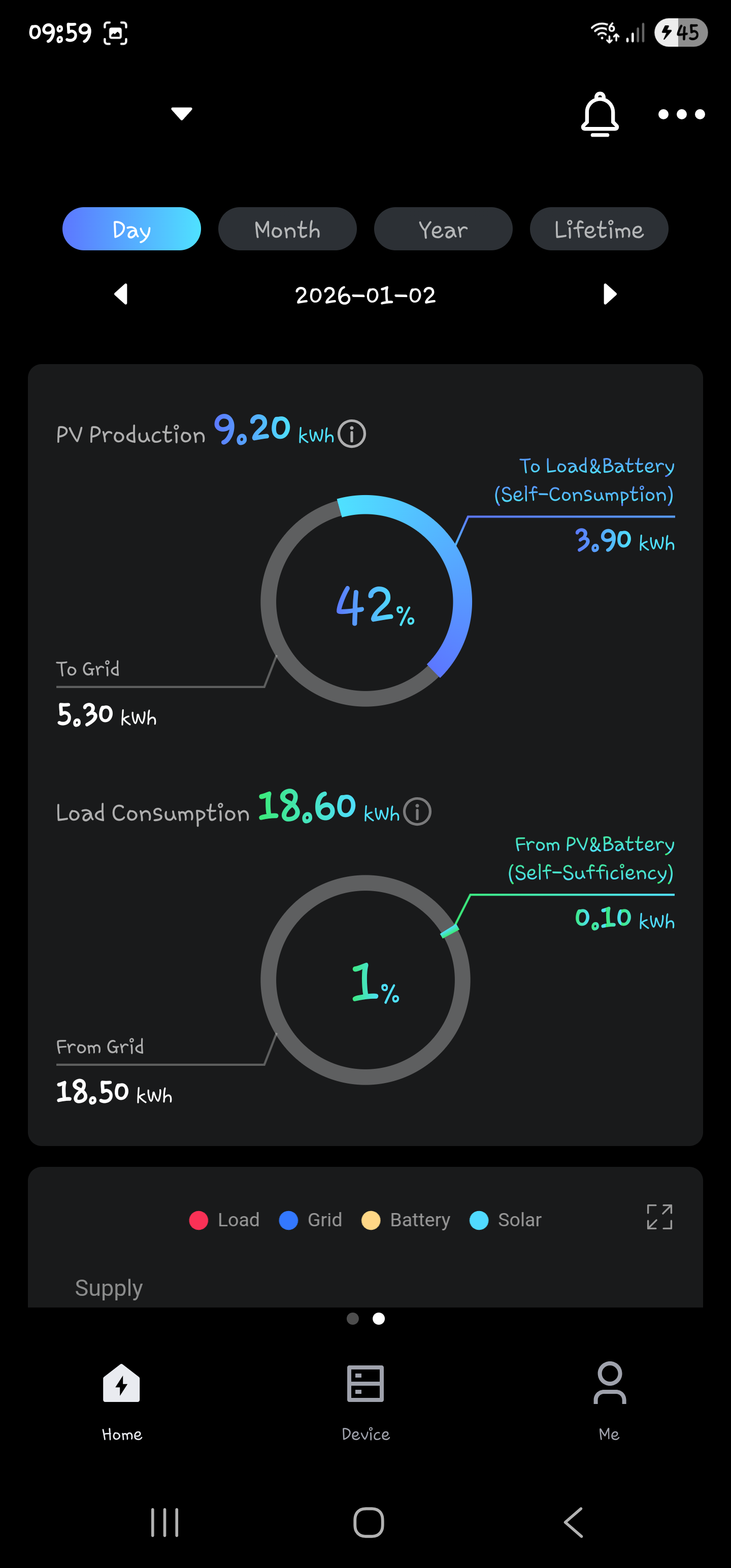

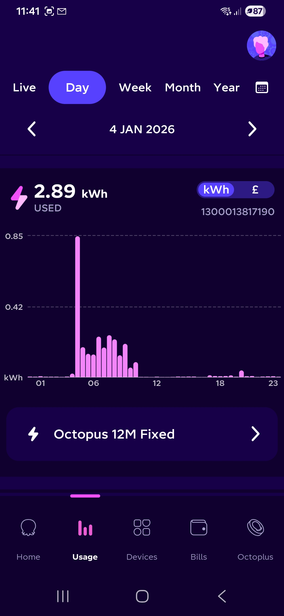

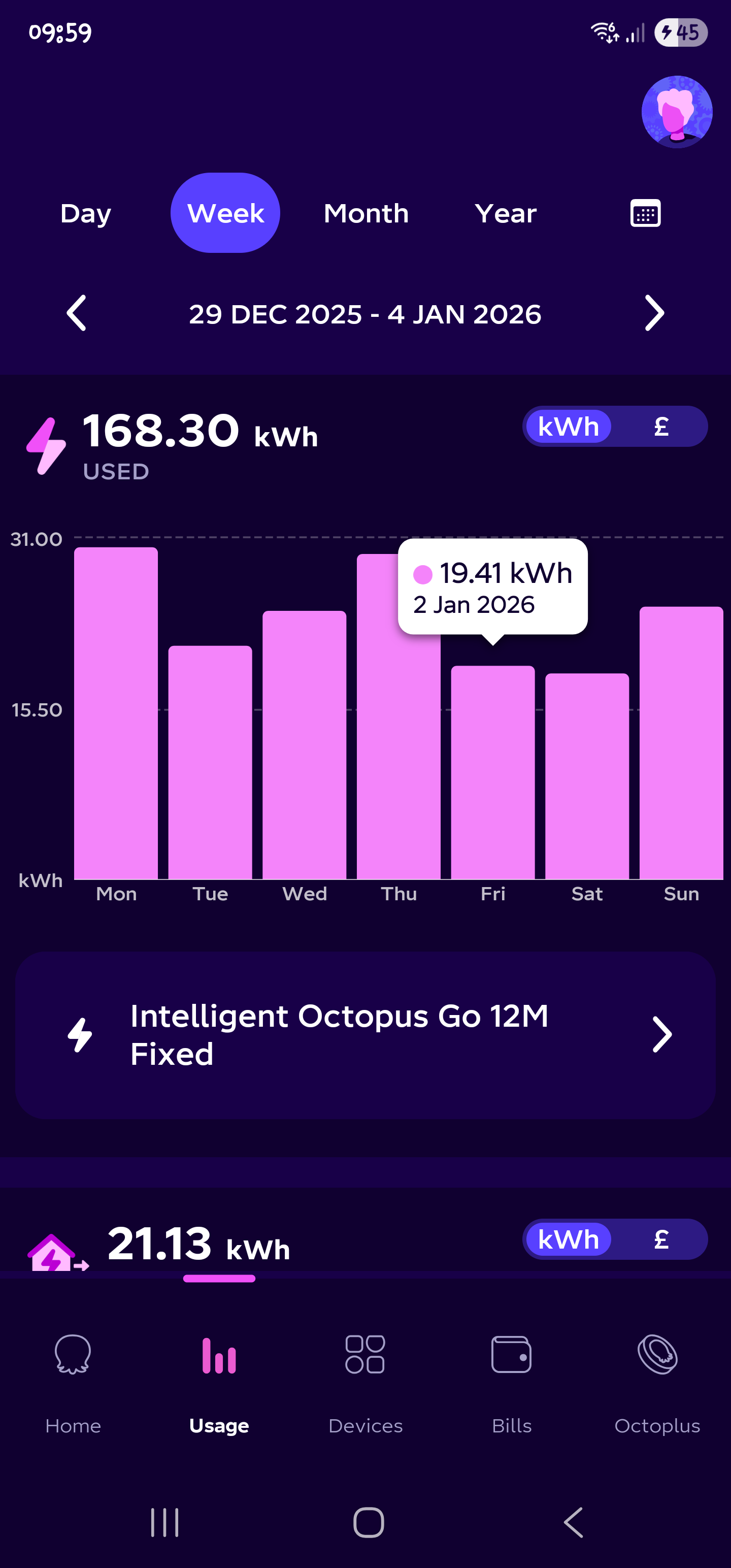

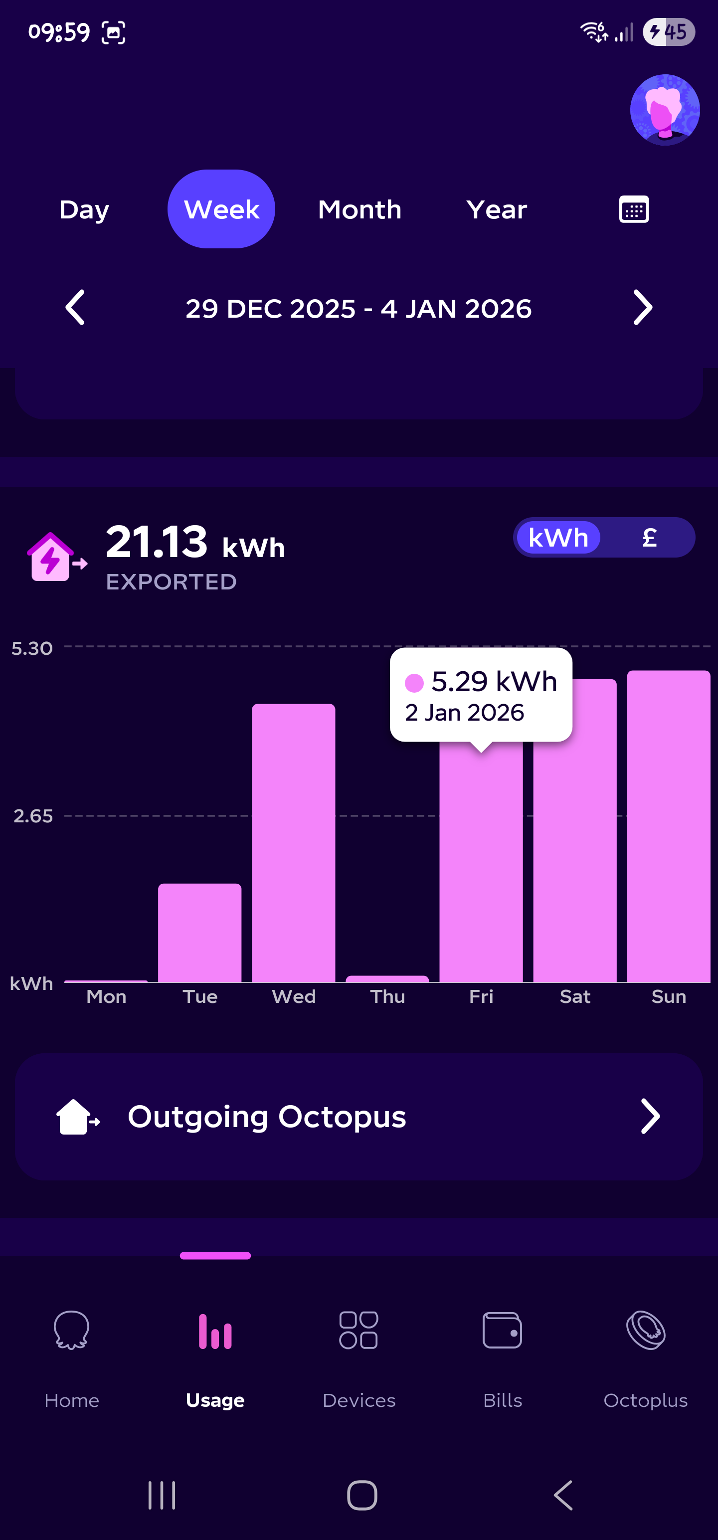

Here are some example images to show what I was looking for to check usage. Take pictures of write down values, whatever works best.
Fox Cloud 2.0 App reported usage
Import: 18.50 kWh
Export: 5.30 kWh
Octopus Import: 19.41 kWh (Zappi CT Clamp = 19.5 kWh)

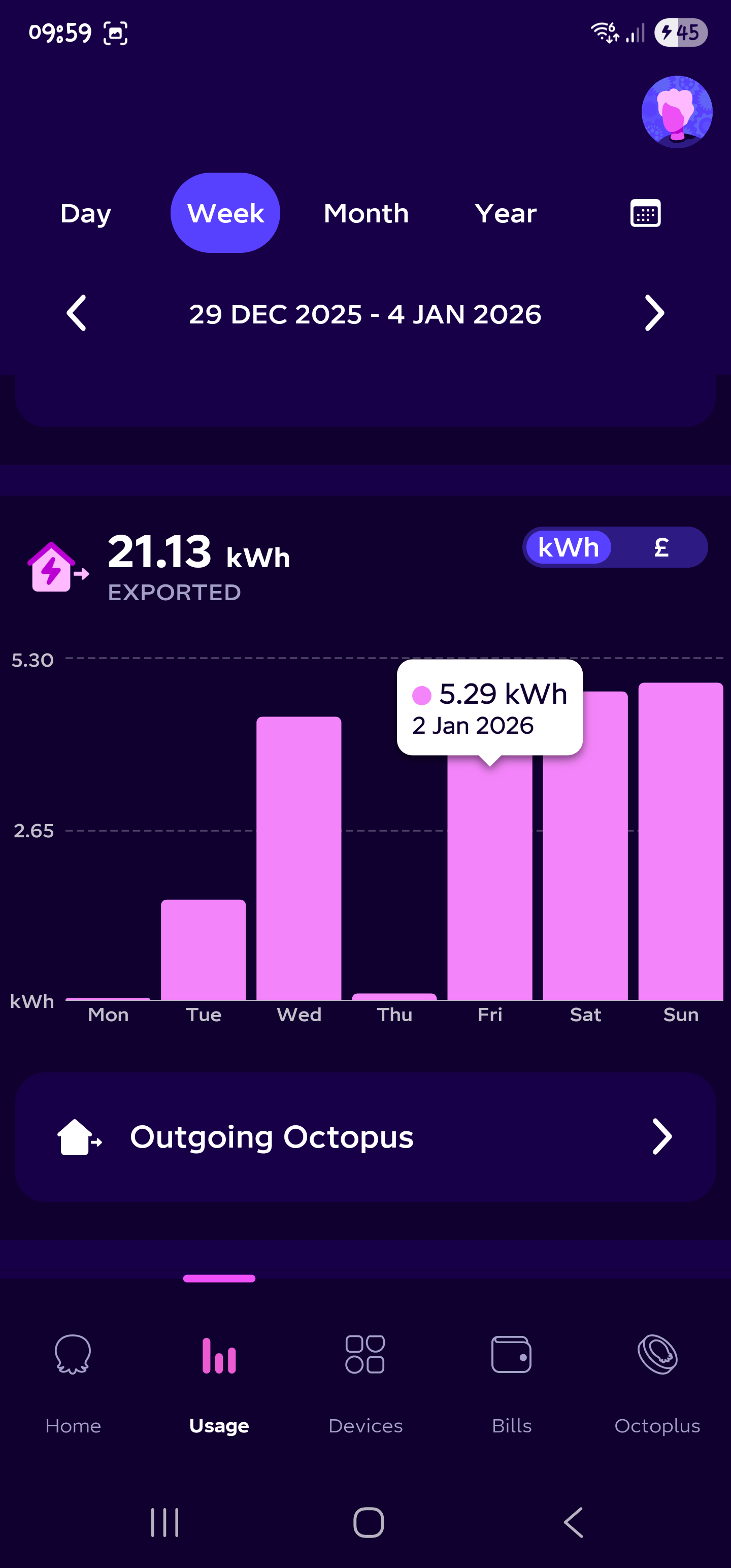

Octopus Export: 5.29 kWh (Zappi CT Clamp = 5.2 kWh)
Someone can check my math's but I think the Fox CT Clamp is reading about 5% under.

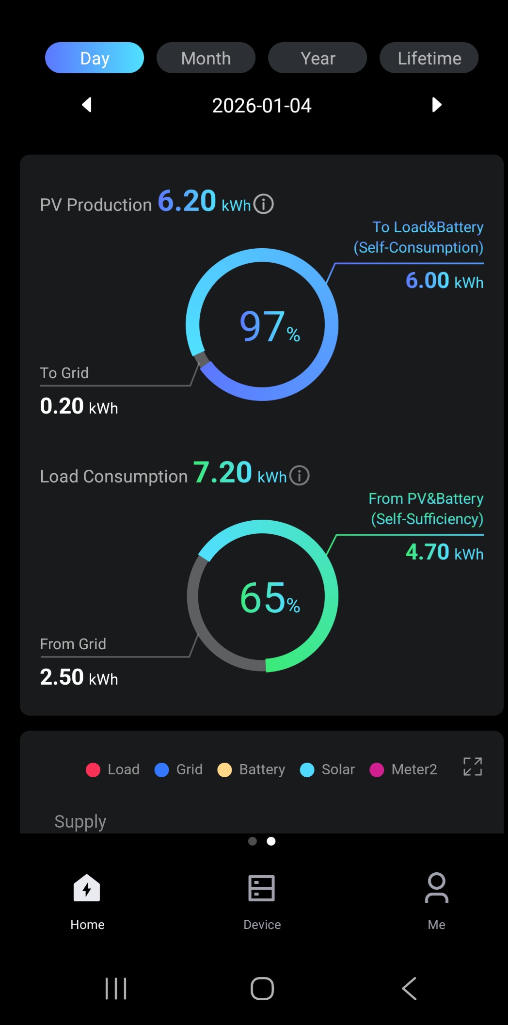

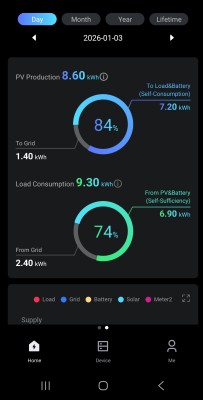

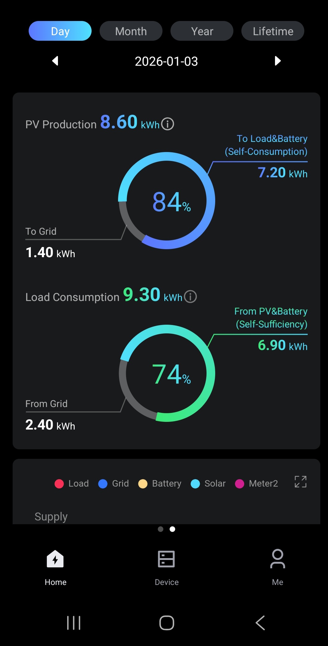

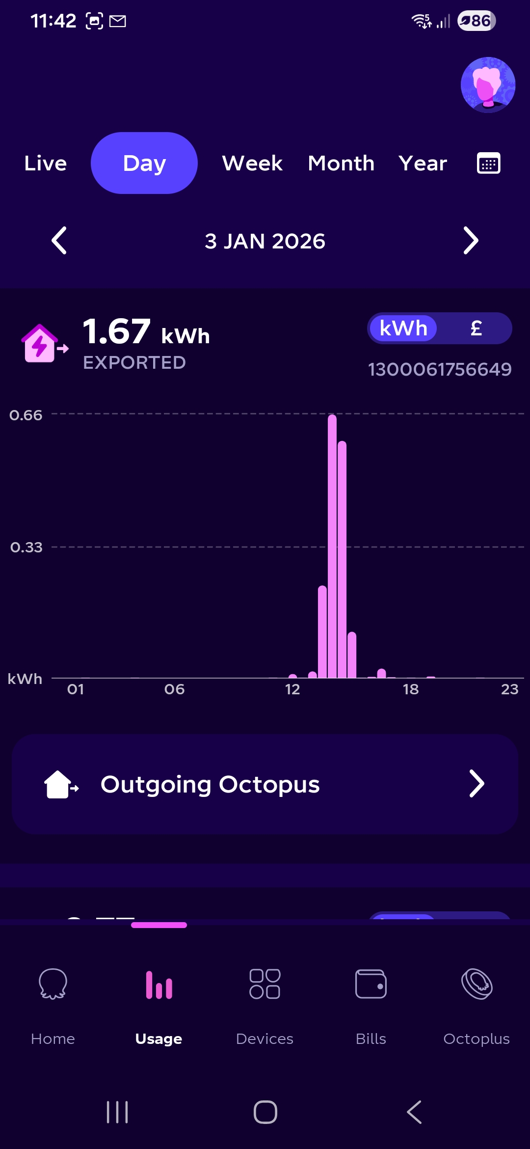

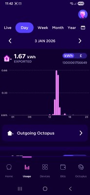

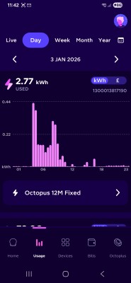

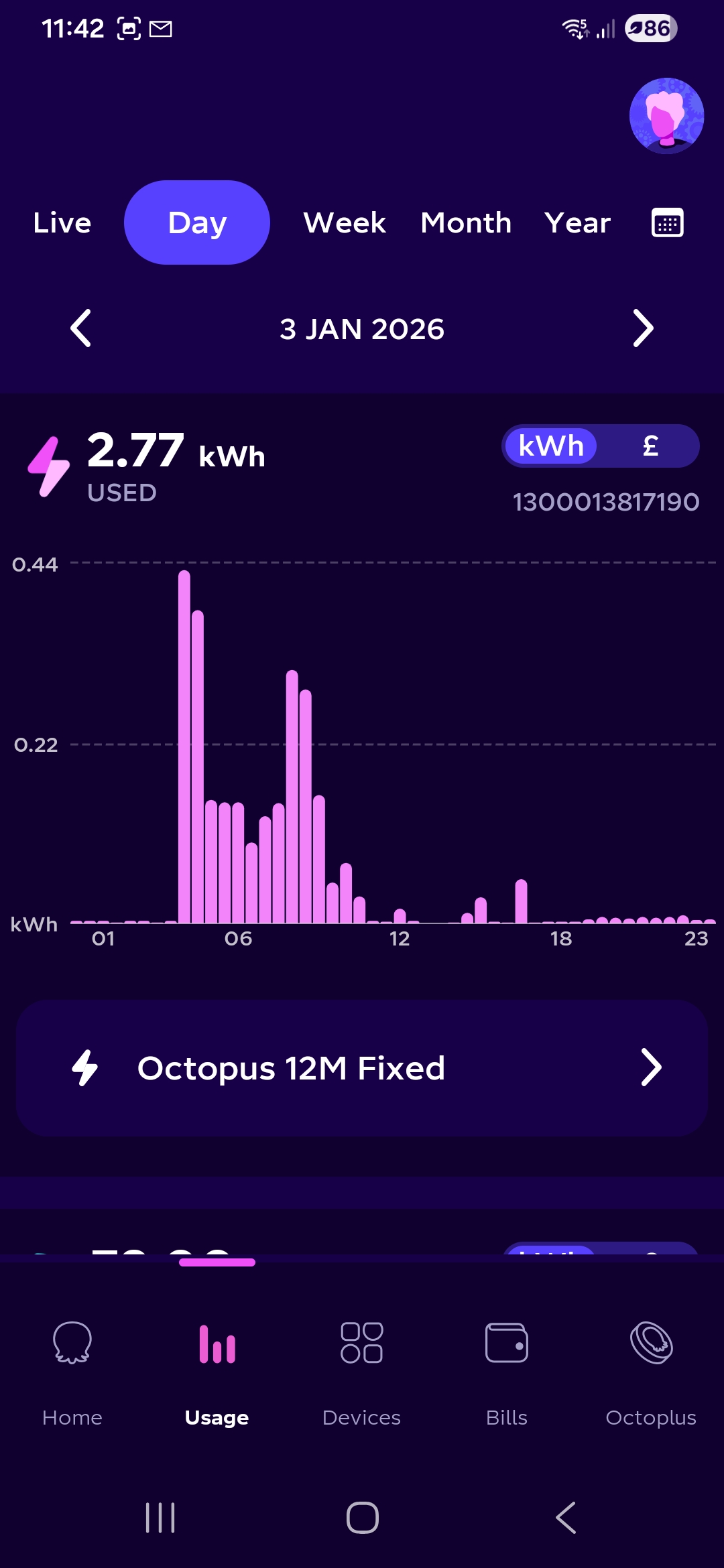

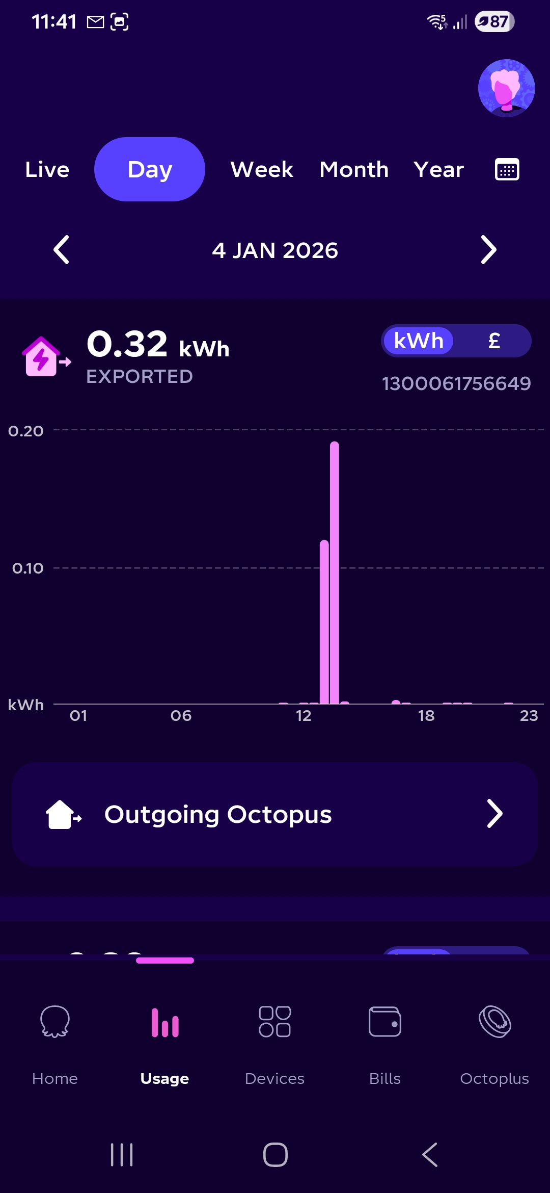

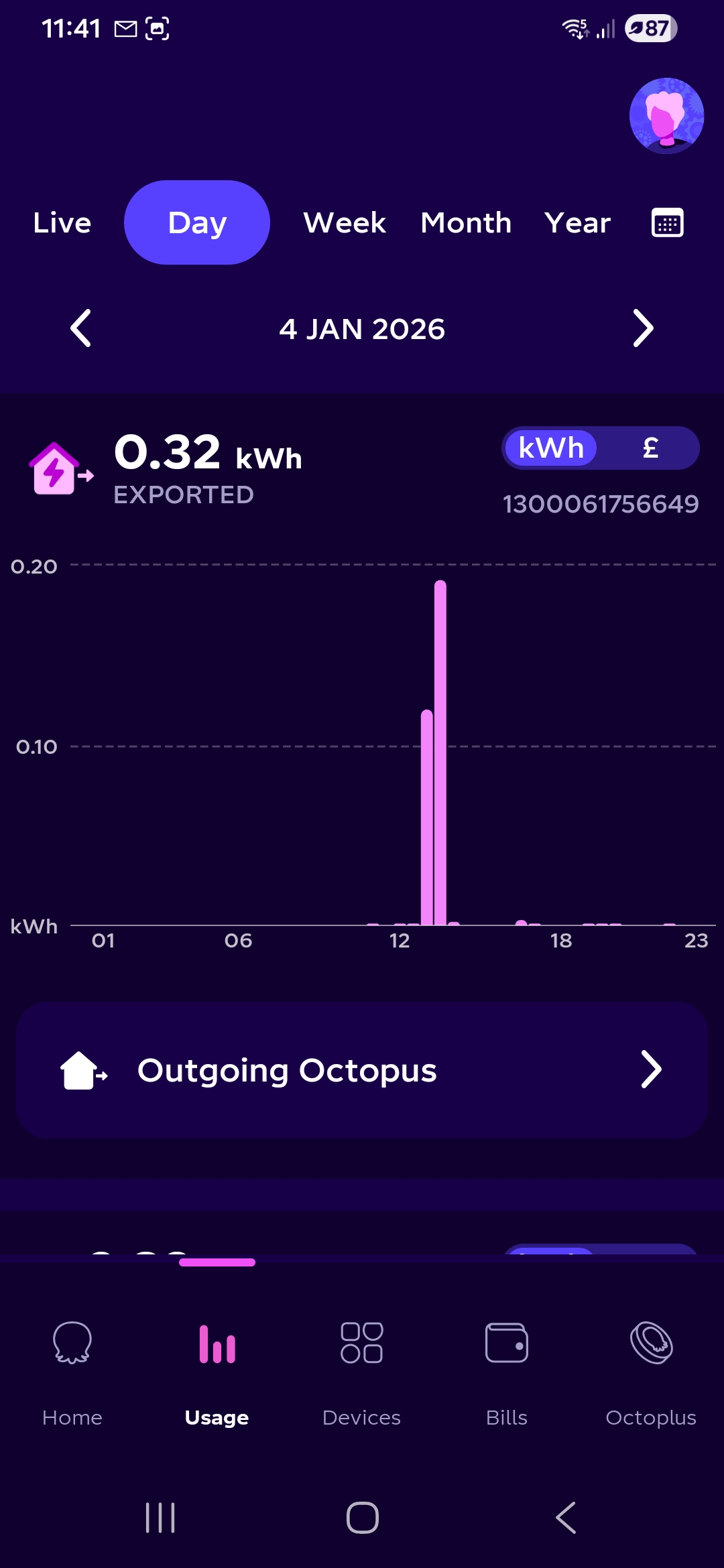

As I mentioned in my first post, I have checked the from grid and to grid with our Octopus import and export figures. They have been very different every day since installation on 19/11. I am attaching 3/1 and 4/1. I am going to phone my installer

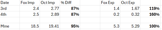

I have made this quick spreadsheet to show the % of Fox vs Octopus
Hopefully your installer can come and check system, as Dave mentioned could be issue with CT clamp cable length or something. As you are a low power user, this could also skew the %, mine is quite close to real use.
