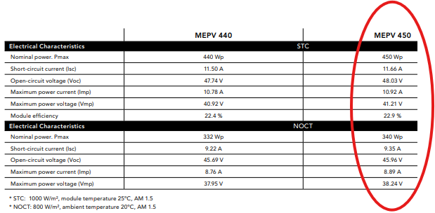

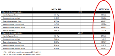

It could be a different panel you have, but this is what I see for Eurener 450 panels.

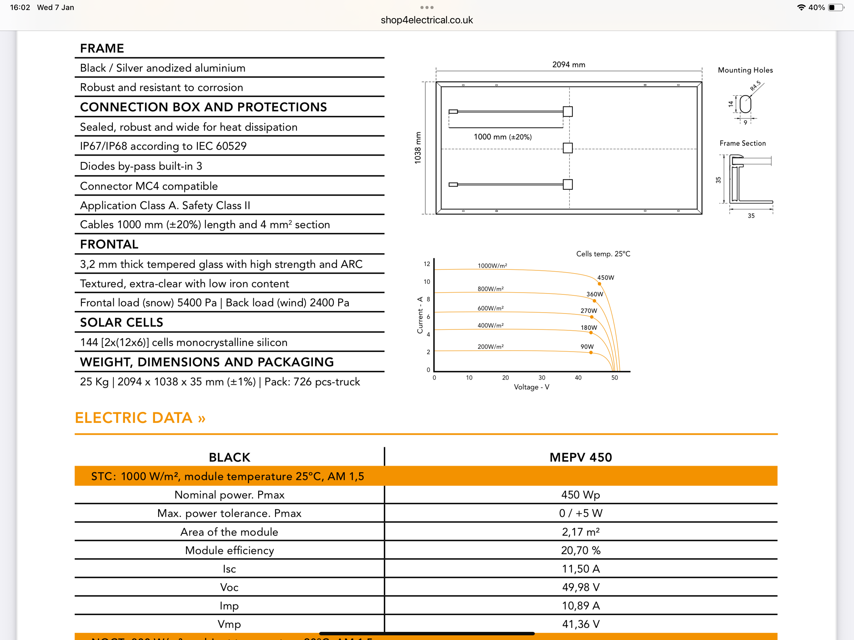

Dave, this is the datasheet I found - https://eurener.com/wp-content/uploads/ ... enafcf.pdf
Specs as below:

I think there are several different 450W Eurener panels, since they tend to supply them in a variety of sizes.
Here's an example of a newer one (54-cell size):
https://midsummerwholesale.co.uk/pdfs/e ... enbace.pdf
And one in the 60-cell size:
https://eurener.com/wp-content/uploads/ ... enafce.pdf

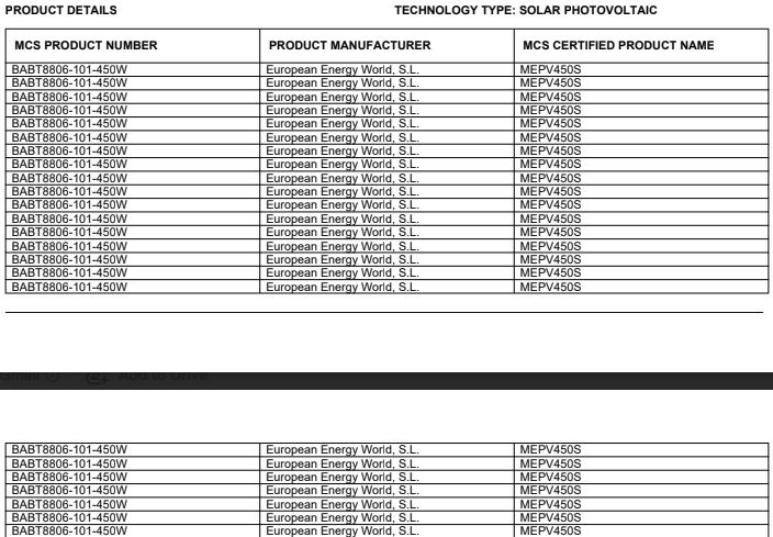

If you google for the 'BABT' code, you'll find this:
https://midsummerenergy.co.uk/pdfs/eure ... -annex.pdf
So there are at least 4 different 450W panels, the one matching the code is the model name ending in 'S'.

OK, so I'm looking for a datasheet for MEPV450 S - wish me luck! :D
