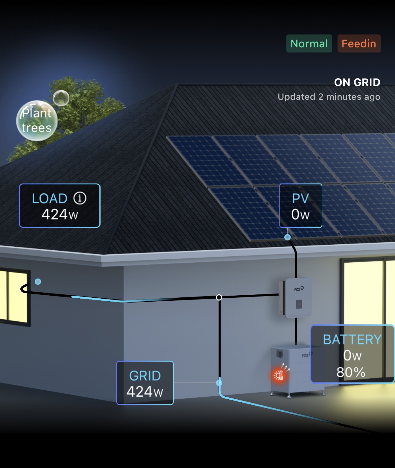

I have my KH8 inverter connected to Home Assistant, on which Predbat is running. Recently I've started seeing 'weird' behaviour, an example being today. Battery SoC is 80%, yet my system is importing from the grid at peak rate.
HA integration is the FoxESS - Modbus method.

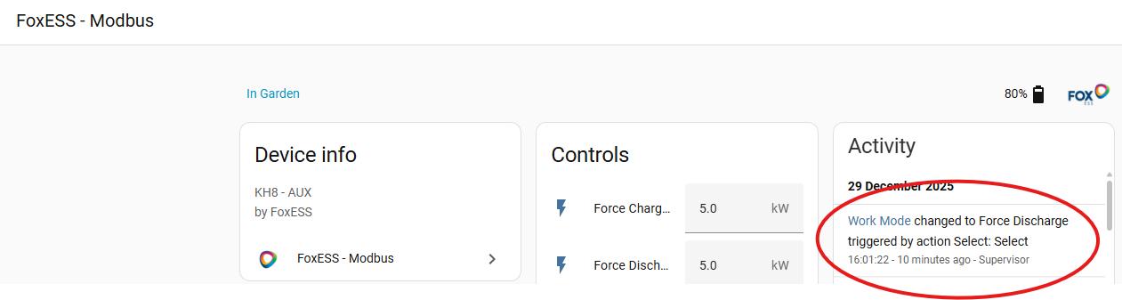

I've tried testing, and can't work out what the issue is. I manually amended the Predbat state to Exporting. The most recent Work Mode change in HA was to Force Discharge. The inverter is saying it's in FeedIn Priority mode. However, it's importing from the grid...
Therefore, the issue appears to be with the inverter? What should I try next? Is it worth power cycling the inverter?

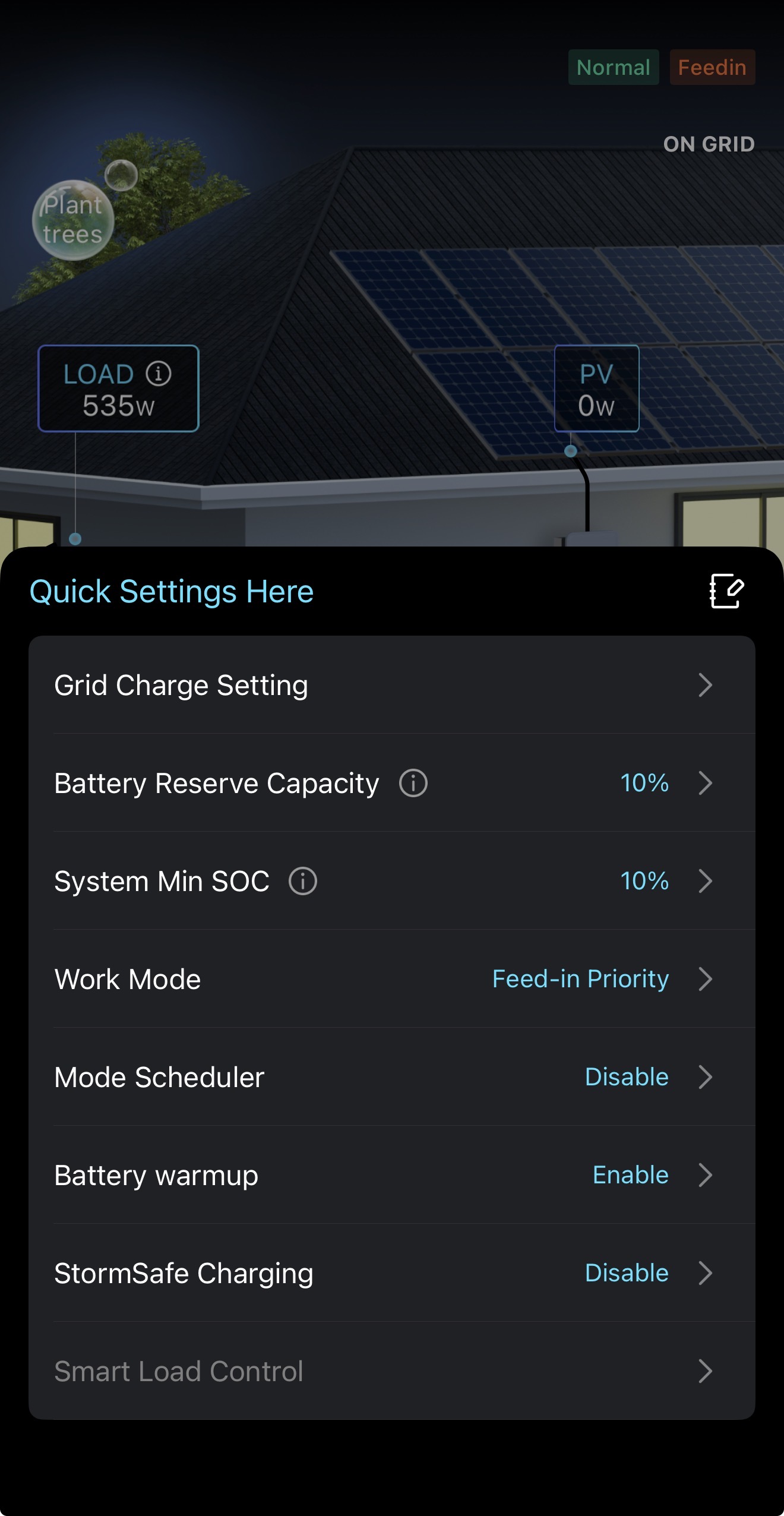

Looking for Min SoC on Grid value, as this could be stopping battery use.

Now, that's a weird thing...no idea what is happening here, I think it might be the result of an automation? All this might be OK, but I don't understand what is triggering it. Any ideas? As far as I know, I set battery_min_soc to 10%

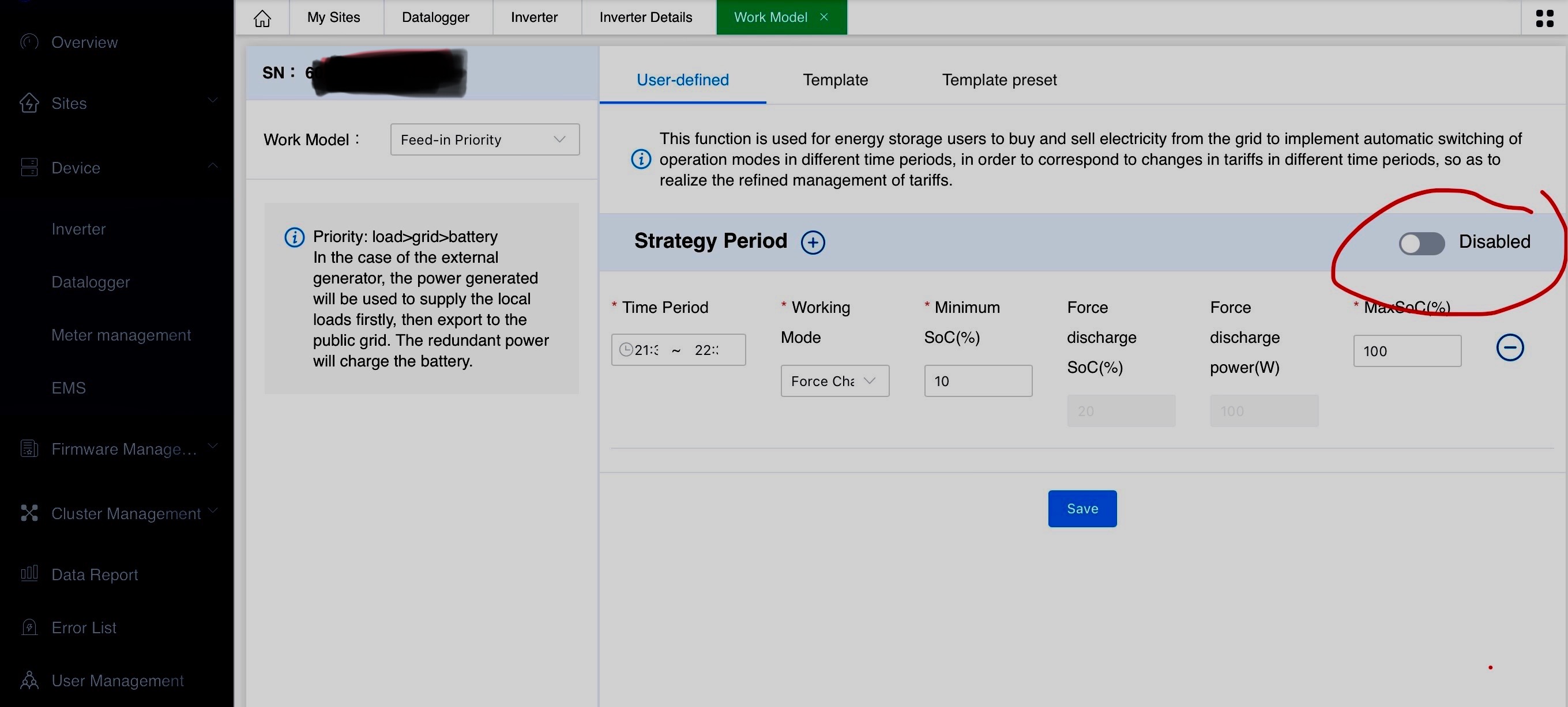

OK, figured out it's not Predbat, and it's not HA. It's the Fox inverter settings, specifically the Mode Scheduler settings. Somehow they keep turning on?
24x Eurener MEPV 450 panels - FoxESS KH8 inverter - FoxESS EP11H battery
Re: Why is my inverter set to discharge, but is still importing from the grid?
Yep that’s what it looks like, you can’t run scheduler and HA automations at the same time as they fight.
There’s a bug in the app at the moment that leaves the scheduler master switch enabled even when there are no schedules set - the net result is the inverter thinks there is a schedule set.
I believe from other users posts the scheduler can be disabled on the old V1 website and it definitely can using the Energy Stats app.

I was able to do it via the Fox Cloud 2.0 app a few weeks back.
v1 website...
Device
Inverter
Operation->view
Energy flow, Work model, click blue square
The master switch is to right of the strategy period
On the V1 website it’s this switch here that enables the scheduler master switch when a schedule has been created.
MaterialBarracuda48 wrote: ↑Mon Dec 29, 2025 7:14 pm I was able to do it via the Fox Cloud 2.0 app a few weeks back.
v1 website...
Device
Inverter
Operation->view
Thanks - already showing as disabled :)

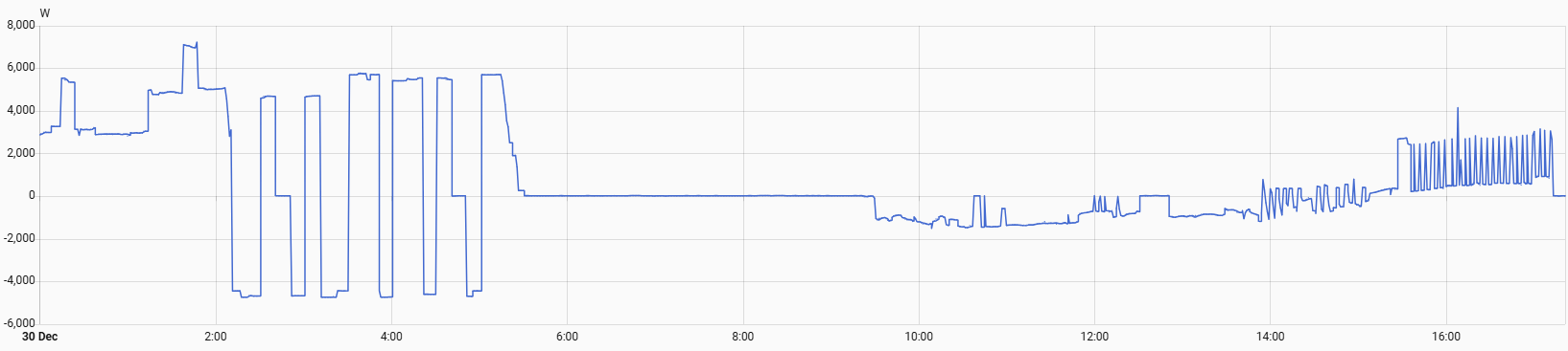

This is my demand chart for today - something seriously wrong from around 14:00 onwards:

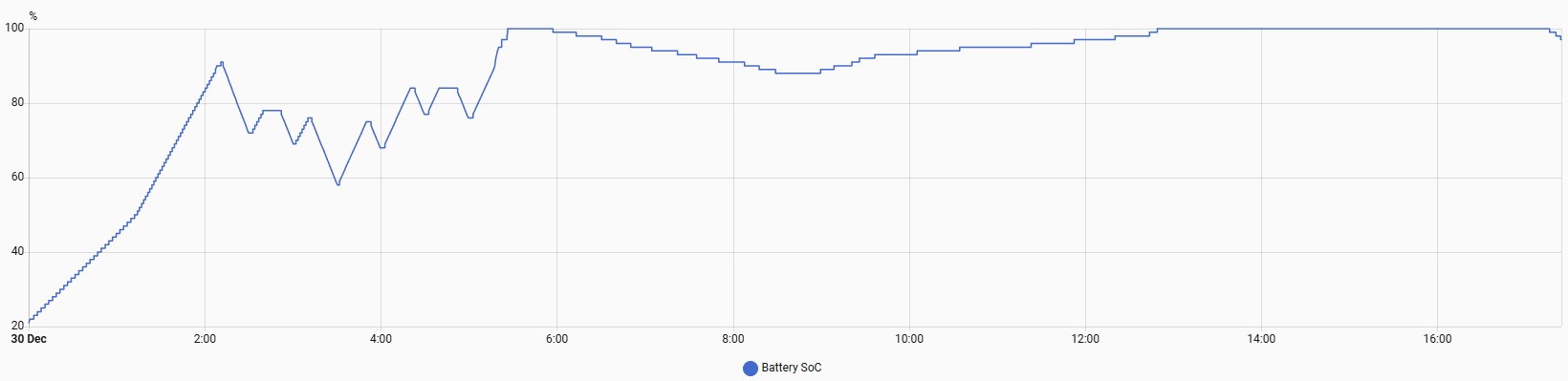

This is the battery SoC:
The system seems to be behaving itself right now, from around 17:10 (ish)

Is the top chart grid_ct ?
Some very wacky movements from import to export there … is it just predbat running now (no schedules)?
Dave Foster wrote: ↑Tue Dec 30, 2025 6:30 pm Is the top chart grid_ct ?
Nope, it's sensor.octopus_energy_electricity_xxxxxxxx_xxxxxxxxxxxxx_current_demand
Yeah, just Predbat, no schedules
