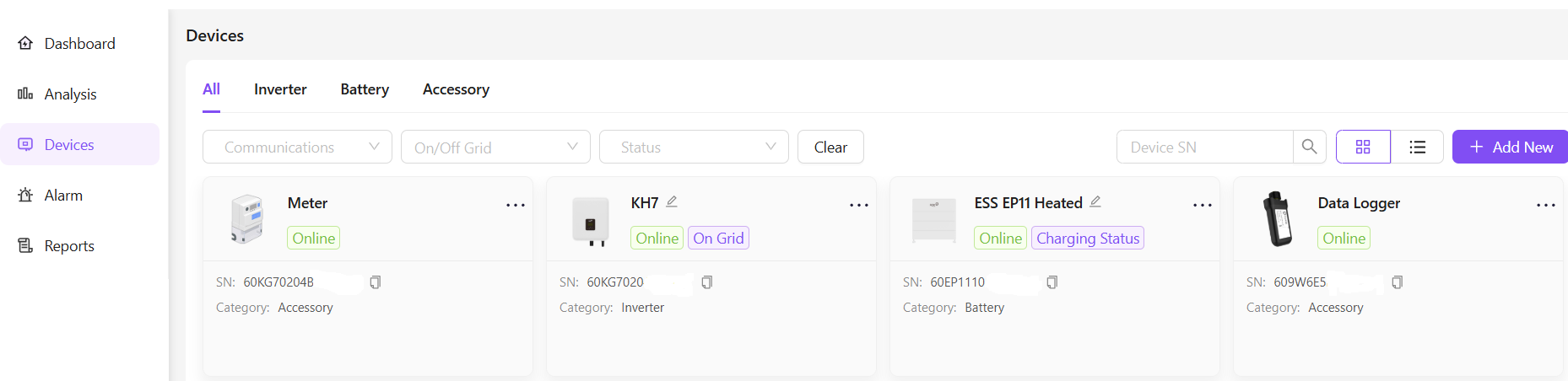

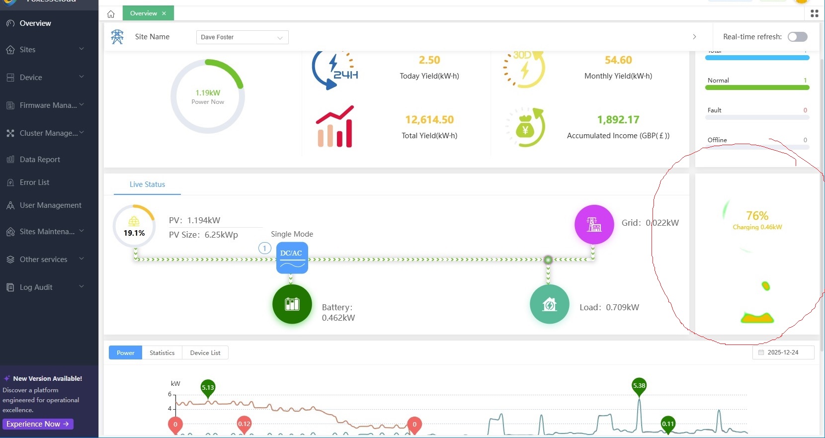

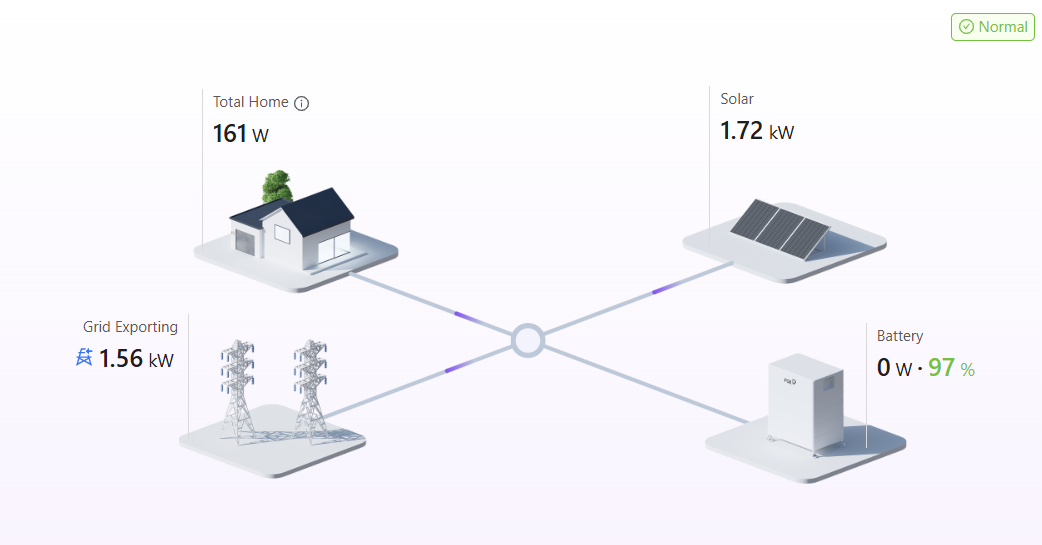

On the V1 website, it's usually on the overview page

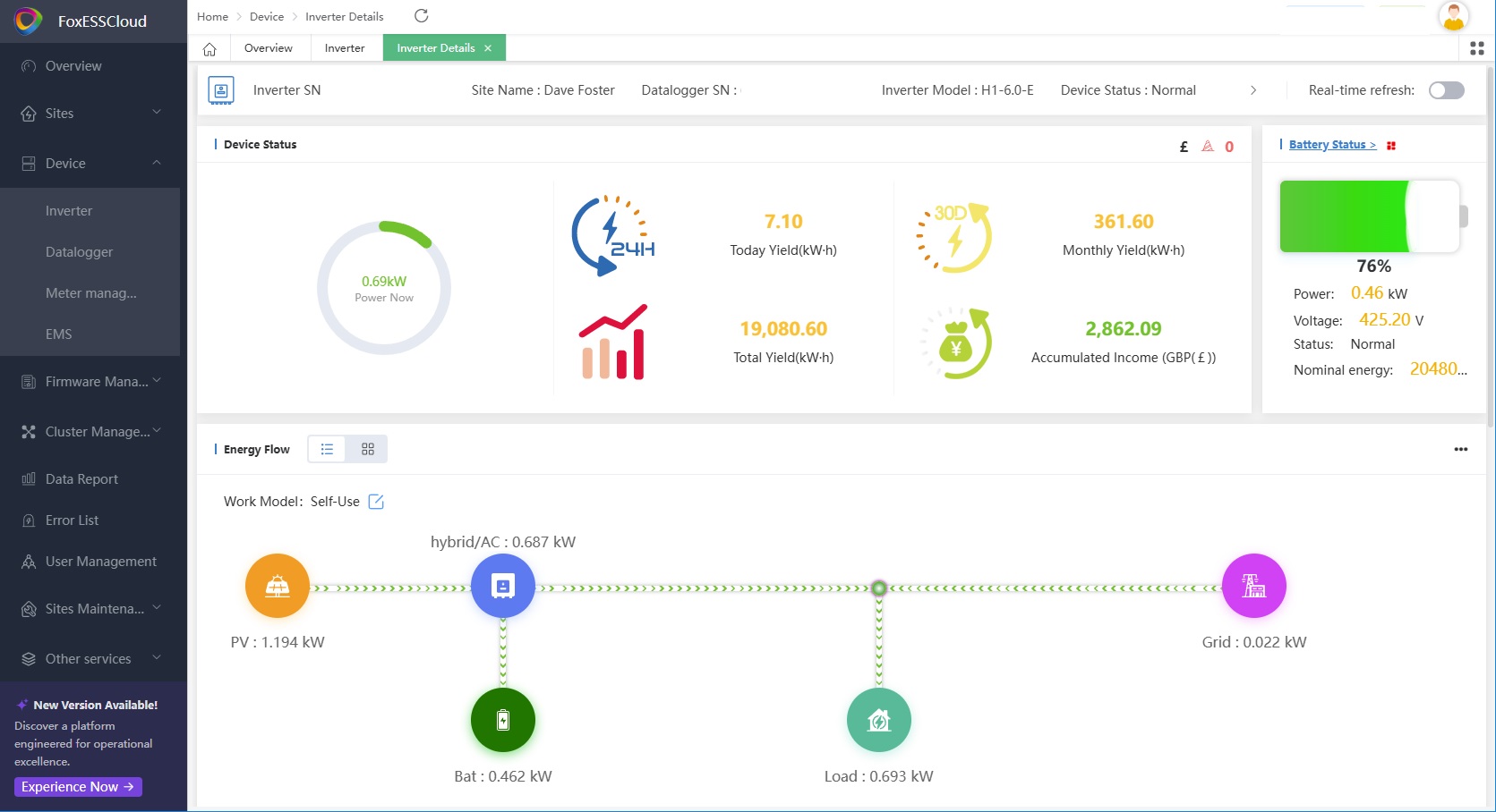

Or click on Device, Inverter, and click the 'view' icon on the far right to get this screen

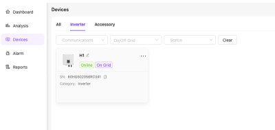

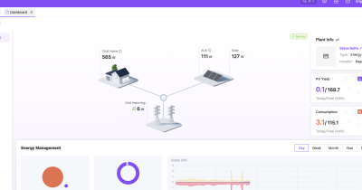

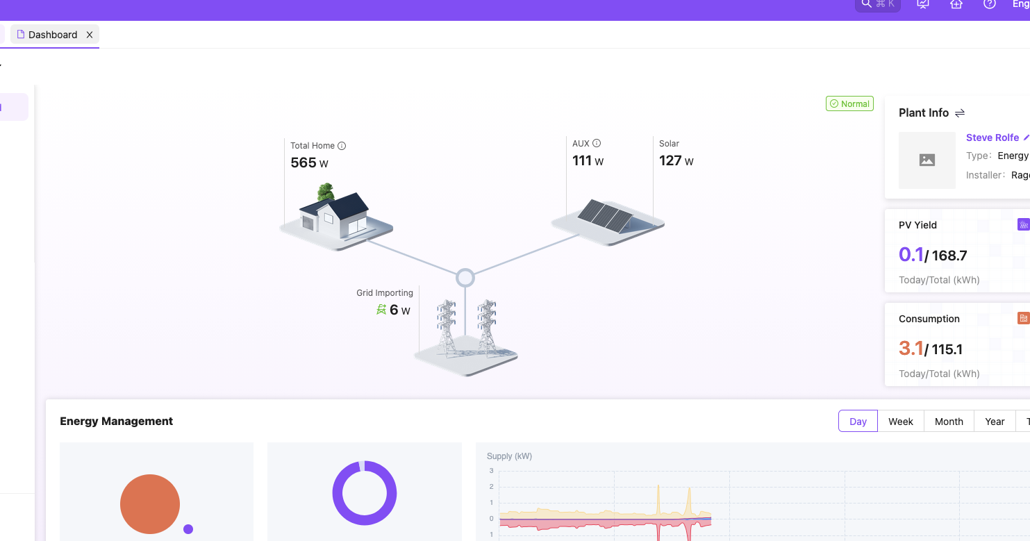

interesting. When I go to :
https://www.foxesscloud.com/v2/login
The battery does not appear as it does in your diagram. Wonder why my interface is different? Looks exactly like yours but for the battery icon?
can't work out how to post a screen shot here??
here we go - see, no battery??

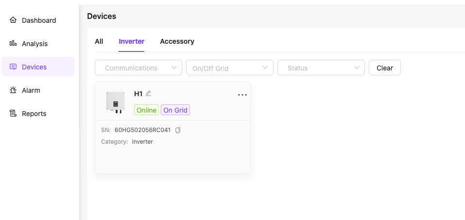

You may need to send a screenshot of your Devices menu from your V2 site
It shows all the items in your "Plant" that are registered to your account, either the battery has not been added, which would be odd, or the system needs a reboot to pickup the battery. You might need to add a picture of the front screen of the inverter, give details of what you have.
You can also try Dave's Fox Cloud v1 site guidance to see if there is any difference.

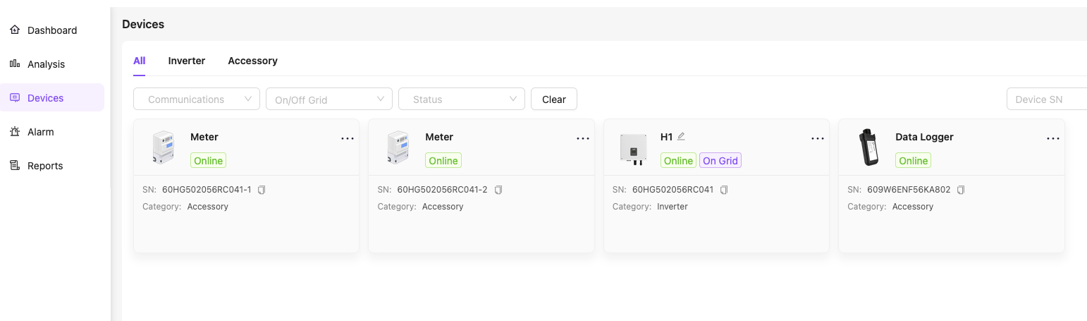

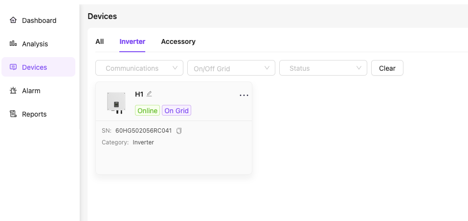

thank you for the reply. This is what I have in devices:

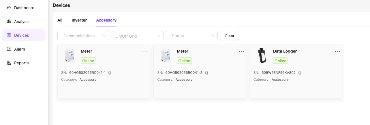

here is the rest
On your inverter screen, do you see SoC %?
It might be your system needs a reboot, if not then it is a possibility that the battery needs adding to your plant, for which you will need the serial number I think to add it?

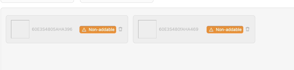

Now see what happens if you try to add battery to your plant in Devices.
thanks. So, I tried and it says that they are 'non addable'
You may have to ask your installer to check upon your system, as the battery should show in your plant normally.
Well that's as far as my experience takes me, so you will have to wait on them, or additional advice on the forum.
