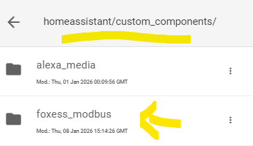

I've downloaded the zip file>extracted> copied the foxess_modbus folder and put it into: Home assitant/custom_components:
modbus in cust.png (14.02 KiB) Viewed 118051 times
I then restart but it doesn't show up in the downloaded (available) in HACS.
If I try to instal the integration through the normal integrations page I can select it to setup as a new integration but then it fails with an error Config flow could not be loaded: {"message":"Invalid handler specified"}:
i'm obviously doing something wrong :-(

maybe i made a mistake - if you manually install the folder, dont look in HACS, rather just go to add the integration on setting>devices and service page.sorry for that confusion. if thats not working, I'm running fully on GPT at this point:

Perfect — thanks, that confirms it 👍
Your `manifest.json` is **correct** and **not the problem**.
Given this manifest, the error **must** be one of the following **three concrete causes** (in order of likelihood):
## ✅ What *must* be true for this to work
### 1️⃣ Folder name **must be exactly** `foxess_modbus`
Because:
```json
"domain": "foxess_modbus"
Your friend **must have**:
/config/custom_components/foxess_modbus/manifest.json
❌ Any of these will cause **Invalid handler specified**:
/config/custom_components/foxess_modbus_EVO/
/config/custom_components/foxess_modbus-main/
/config/custom_components/foxess_modbus_EVO-main/custom_components/foxess_modbus/
This is the **single most common cause** of this error.
### 2️⃣ The integration is loading, but `config_flow.py` is missing or broken
Because you have:
```json
"config_flow": true
Home Assistant expects:
/config/custom_components/foxess_modbus/config_flow.py
If:
* the file is missing
* renamed
* has a Python error
* imports something that fails
→ HA cannot register the config flow handler
→ **Invalid handler specified**
📌 Ask your friend to check **Logs** immediately after restart:
Settings → System → Logs
They should see an error mentioning `foxess_modbus`.
### 3️⃣ There is a **domain collision** with an existing FoxESS install
If your friend previously installed:
* Nathan’s original via **HACS**
* or a previous manual install
Then HA may be loading the wrong version or failing silently.
**Fix sequence (important):**
1. Delete **all** FoxESS folders under:
2. Uninstall from HACS if present
3. Restart Home Assistant
4. Install **only your fork**
5. Restart again
## 🔎 One very fast sanity test
Tell your friend to temporarily rename the folder to something wrong, like:
foxess_modbus_test
Restart HA → the integration should **not appear at all**.
Rename it back to:
foxess_modbus
Restart → it **should appear**.
If it appears but errors when clicked → it’s **100% a config_flow.py error**.
## 🧠 Most likely root cause (based on your repo)
Because your repo structure is:
foxess_modbus_EVO/
└── custom_components/
    └── foxess_modbus/
Your friend almost certainly copied **the repo root** instead of the inner `foxess_modbus` folder.
## ✅ The exact instruction to give your friend
> Copy **only** the `foxess_modbus` folder from inside the repo’s `custom_components` directory into:
> Then restart Home Assistant.
If after that it *still* fails, paste the **first foxess_modbus error from the HA logs**, and I’ll pinpoint the exact line in your fork that’s breaking the config flow.
Re: Fox EVO 10-8-H modbus registers
