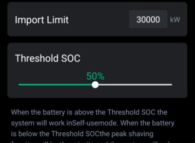

Mine was set by the installer to 30,000. The units are "kw" so that's 30MW!
Shouldn't it be set to 100A x 250v = 25 (kw) to match my grid fuse?
What is yours set to?
The actual units are watts so it is 30kW
30,000 is the default setting, in theory if set correctly it should be set as you say to the incoming fuse setting * max grid voltage.
This setting only affects what the inverter is capable of taking from the grid any other devices such as EV chargers should be set correctly as well.
Thanks for the reply. My app shows it in kW - hence 30,000 seeming very high indeed. So is that a "bug/error" in the app?
