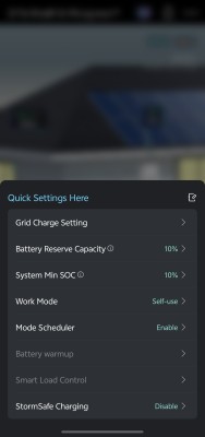

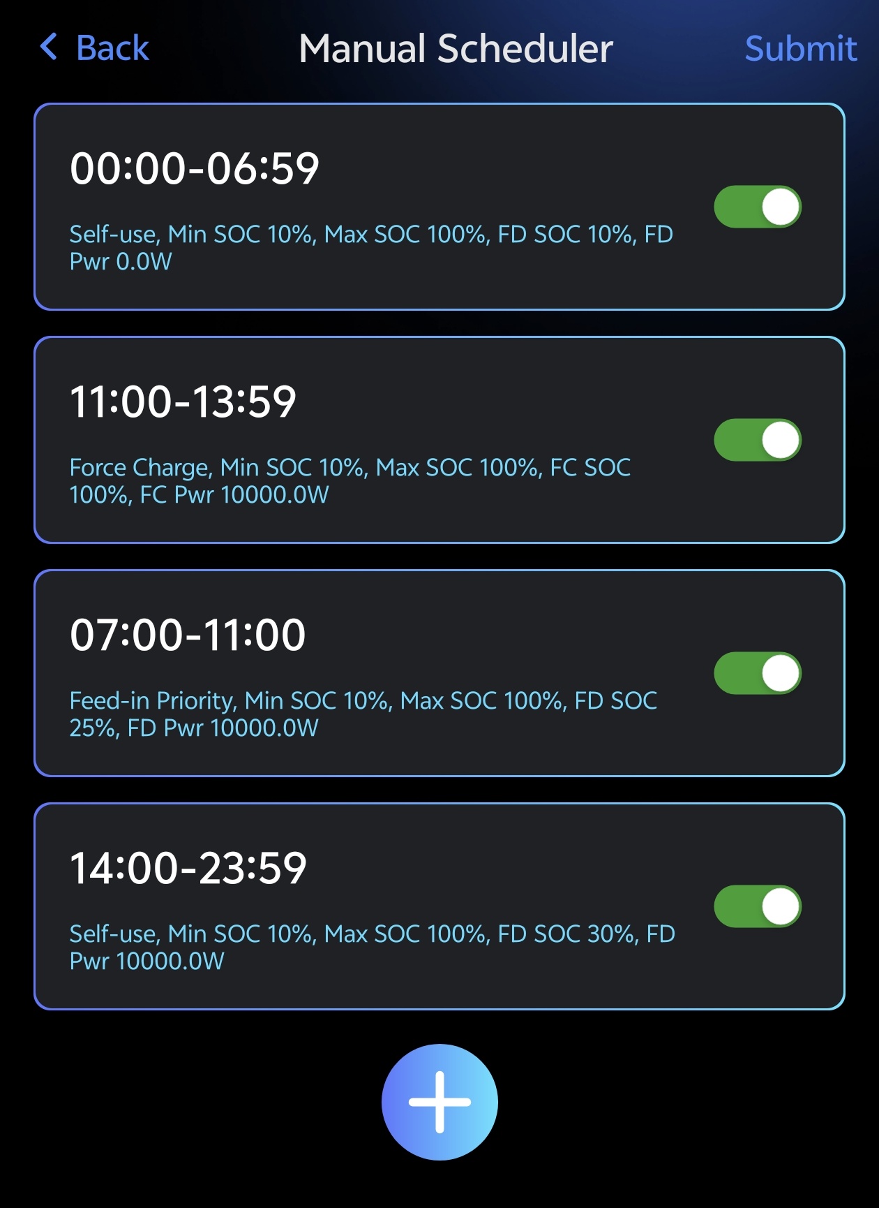

Hi everyone! Got a question on force charge feature. Have a KH10 inverter with 4 EP11 batteries, and a set of solar panels.
My energy plan has a free period and a fixed feed-in tariff.

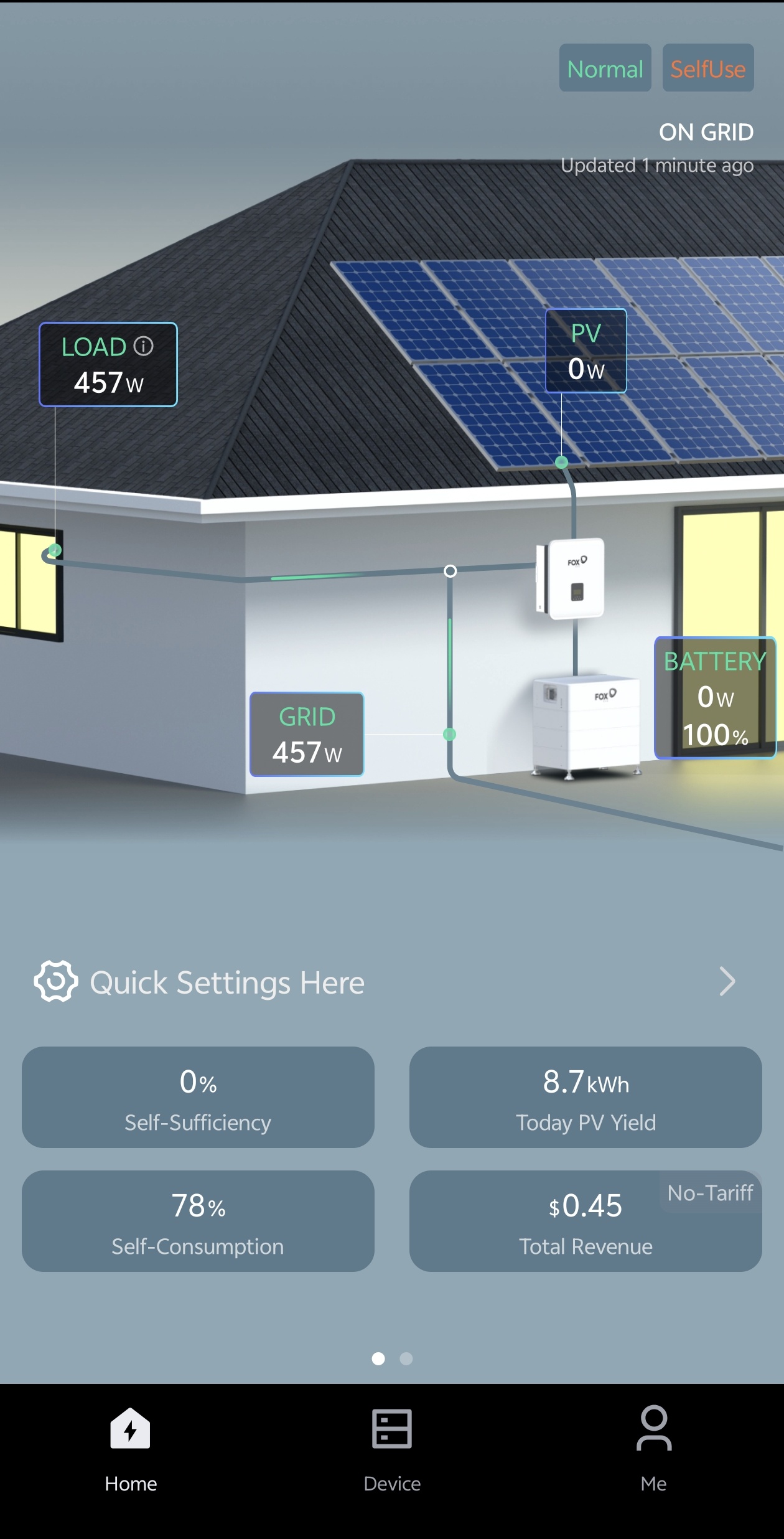

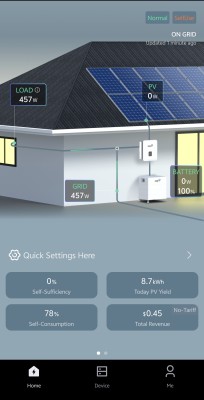

From my observation now, if I set a force charge period in the mode scheduler for the free period, after the batteries are fully charged, the inverter will continue to draw all the household power from the grid. It will not use the battery and the solar panels seems curtailed (showing 0 output on the app).
Is there anything I can do so that when the batteries are fully charged in the force charge period, it continues to sell power generated from the solar panels?
