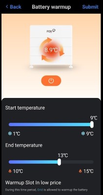

On the app when you see the graphic of the battery in the Battery warmup option, is the temperature shown the lowest cell temp as discussed above, and it’s this temp that controls when heating kicks in and out ?

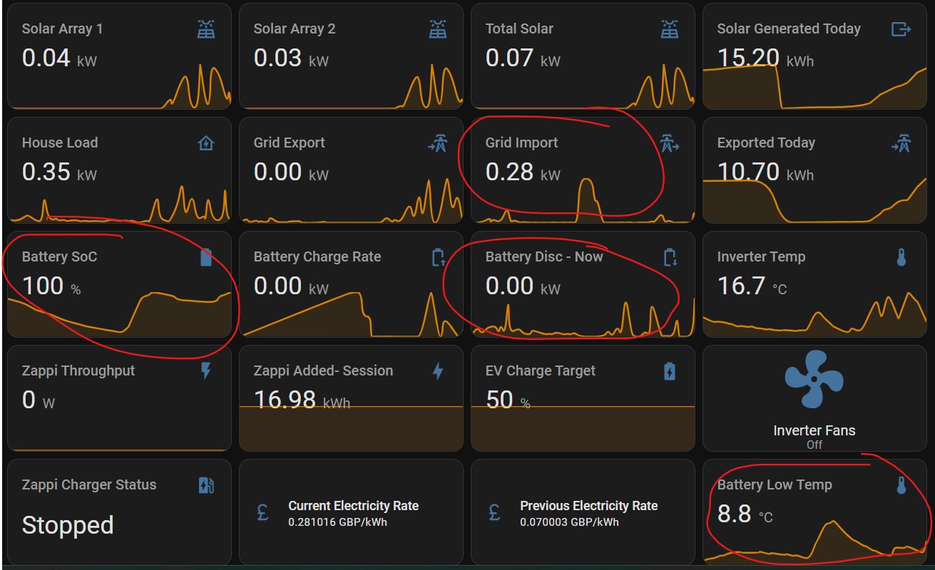

Like other people seeing battery temps drop this week .. so I had enabled the Battery Warm function ... but for some reason, even though it says that the battery is heating (presume the arrows are showing this) .... the BMS temp is dropping and no discharge happening from the battery .. even though battery on 100% .. not sure what is wrong here

The app software is buggy, was playing around with battery warmup temp yesterday, and after changing start temp to higher value, the app then greyed out ‘Battery warmup’ option.
Had to log out and in, only to realise it takes a 5 min cycle to display correctly.
Also the inverter switched to grid supply only for several minutes after each change, before it settled down and started supplying battery power to load.
Unwanted side effect was only seen last night, when battery started to force discharge.
On investigation the schedules I had set in mode scheduler, 1 was active, 3 were disabled had all gone active.
The time segments remained as set but where I had set lower FD Power settings, they had all set to 6000w !
This is after weeks of nightly force charge being set to 4000w and operating correctly.

But 'batTemperature' is the chip on top, not the lowest temp the BMS sees. I can only see the temp I'm interested in, in the phone app, if I am awake to see the temp rise (which I am not lol)
Any temp rise on 'batTemperature' I have to see if it aligns with something else, dish washer...washing machine...which made its temp rise.
I cant see a way to categorically see its the warming feature that's warmed it.

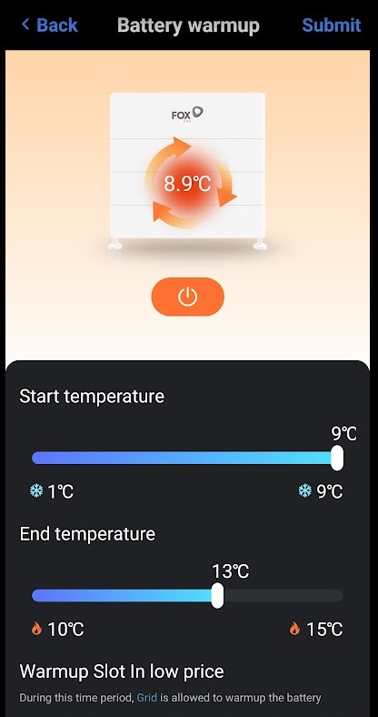

I’ve had warming not coming in when set to 8C and battery level above 75%, and battery not supplying any load and battery temp drifting down to 4C, only after switching off battery warming did the battery start supporting house load, then re-enabling warming, suddenly the battery started warming and quickly reached 12C even though cut off was 10C.
