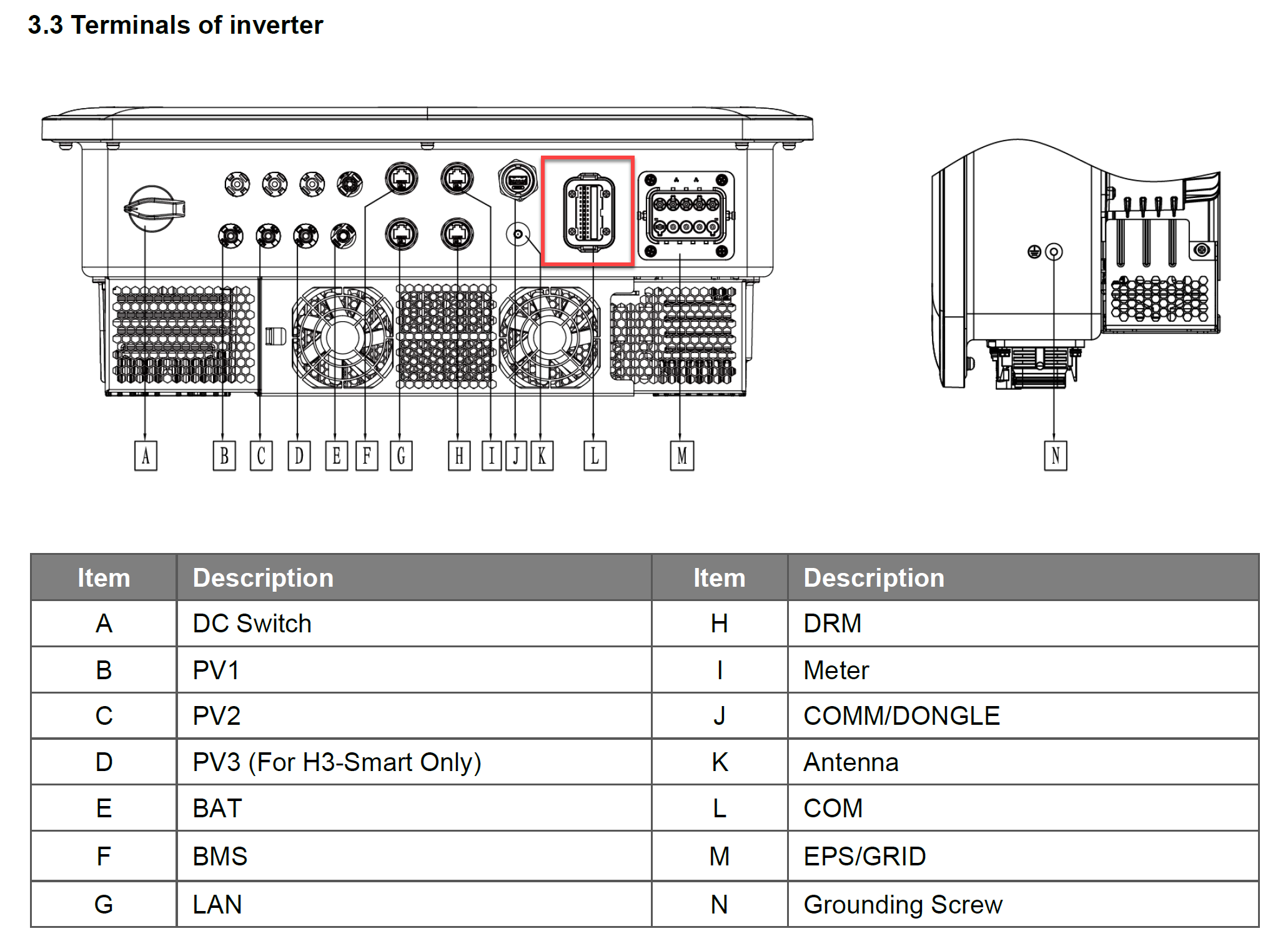

While looking into a Modbus connection, I found that the installer has already used the RS485A and RS485B ports for the smart meter connection. From my research, it seems that RS485 supports daisy chaining multiple devices. Since I haven’t worked with Modbus before, I have a few questions:
1. Do installers normally use these same RS485 ports for the smart meter? According to my understanding, these are the EMS RS485 connections NOT the Meter RS485 connection to the smart meter?
2. If I daisy chain the smart meter and a Modbus device, is the setup as simple as Inverter → Smart Meter → Modbus device? How does the inverter distinguish between signals from each device? For example, if I want to set the battery self-use discharge SOC to 20% when tomorrow’s forecast is sunny, will the inverter handle that correctly?

The meter RS485A/B is only to be used for meters as it is a different protocol used.
You should be using EMS485A/B on the COM port for your RS485 modbus connection.
Don't forget that it's easier to run a single pair cable to the inverter (no power or GND needed it is a differential pair) and have the RS485 modbus adaptor in the home, and perhaps connected directly to a USB port particularly with RasbPi home assistant.
For a USB port connection i'd recommend something like this https://www.amazon.co.uk/DSD-TECH-SH-U1 ... 078X5H8H7/
And for a PoE solution something like this https://www.amazon.co.uk/Waveshare-Indu ... 0BGBQJH21/
