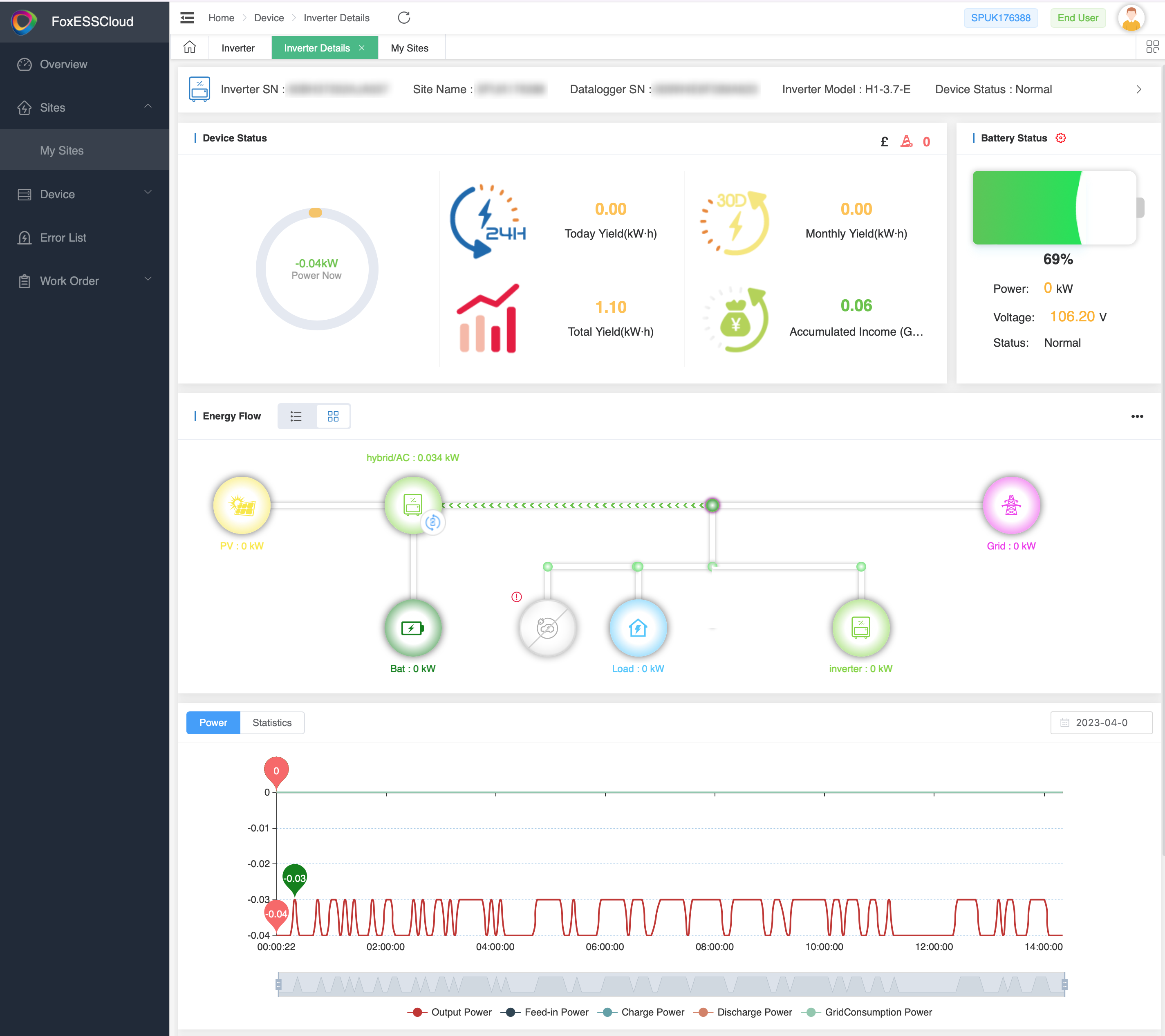

Ive recently had installed 6 Solar PV and a Fox Inverter + 4.5 Battery.
Im new to this system so not fully familiar with it yet. Below are the issues Im having, would be grateful for any help and advice.
1. Even on a sunny day no daily/monthly yield shows in the APP, yet the PV1 & PV2 show DC voltage.
2. The APP shows no Grid usage but my Smart Meter ££ goes up every day, even with a charged battery.
3. A fully charged battery has gone down 30% in a week, but in point 2 above my Smart meter ££ still go up.
4. The APP never shows energy drawing from the Battery or Solar PV.
Please can you advise if this is setup correctly.
Screengrab attached from app.
Many thanks
Tony

Our smart meter includes the daily standing charge, so will always display a charge. Also, the Fox ESS Inverter usually draws a few Watts from the grid, just to monitor that the Grid is still functioning.
Hopefully, that helps
