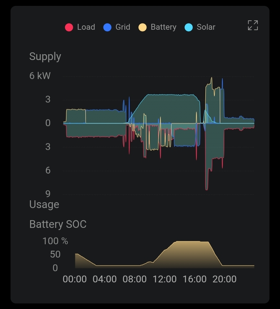

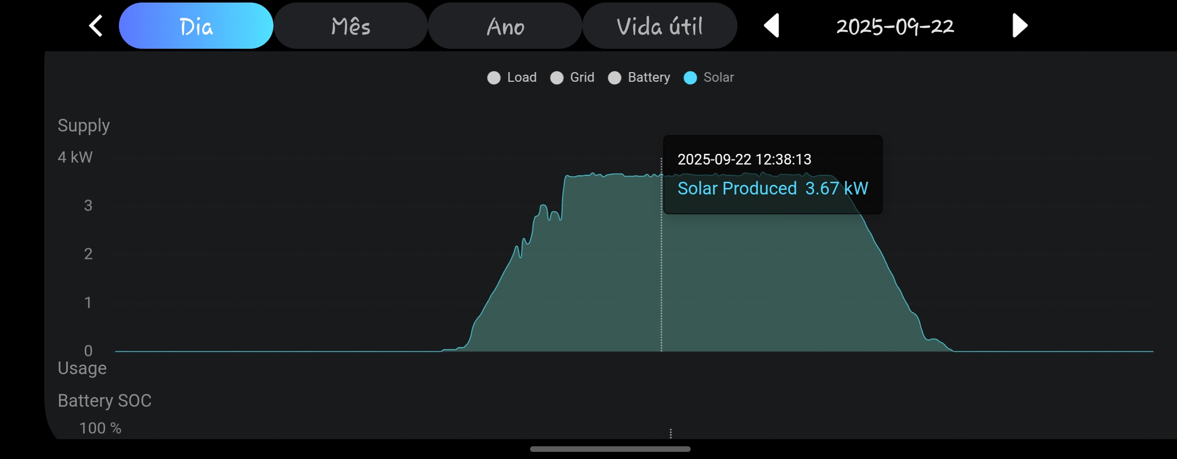

Good afternoon.. I have a fox system set up +- 1 month. 10 panels Aiko 605wp + Inverter H1-6.0-E + EP11.

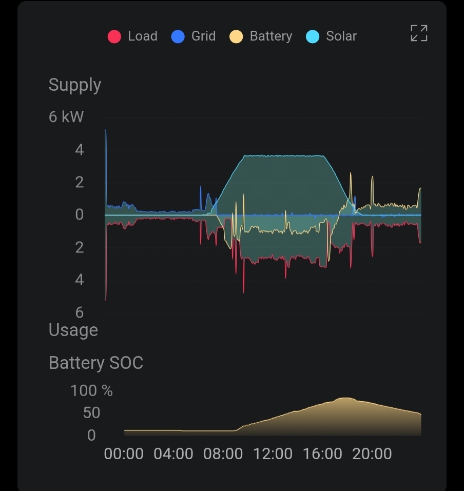

. I don't know if it will be normal for the system to reach a peak of 3.6kw from 10:00 a.m. and keep until 5:00 p.m. It seems that something is blocking higher values.. It would not be normal that on sunny days the system could reach peaks above 3.6kw..

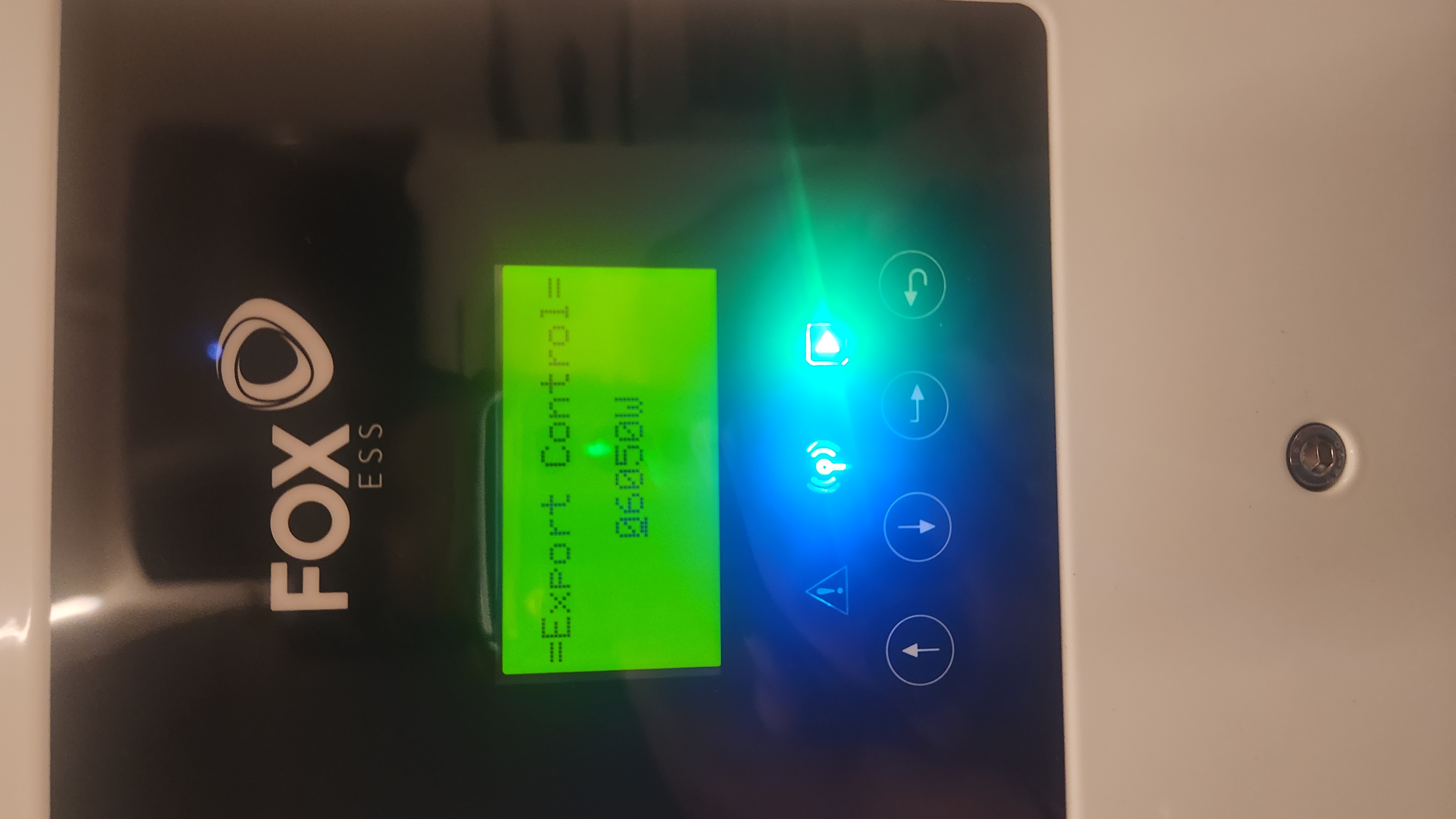

You can check the export limit by going into the inverters settings and go to on-grid, Export Control - the export control power should be set to 60,000 which allows the inverter to export at full power.

Export control is at 06050W

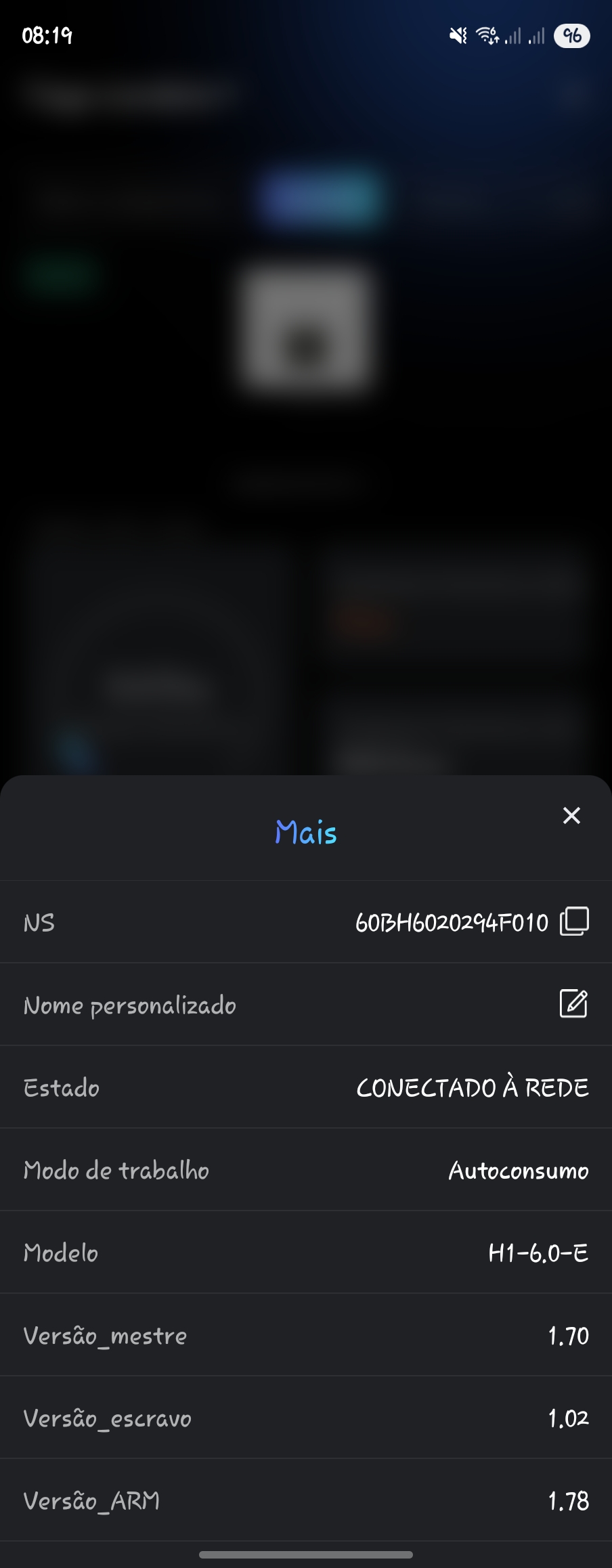

Worth check you are running latest firmware as some restrictions were removed in latest - if you are unsure check the master / slave and ARM versions in the app by clicking ‘Device, Inverter’ and click the serial number under the picture of the inverter. Post them here and I will check.

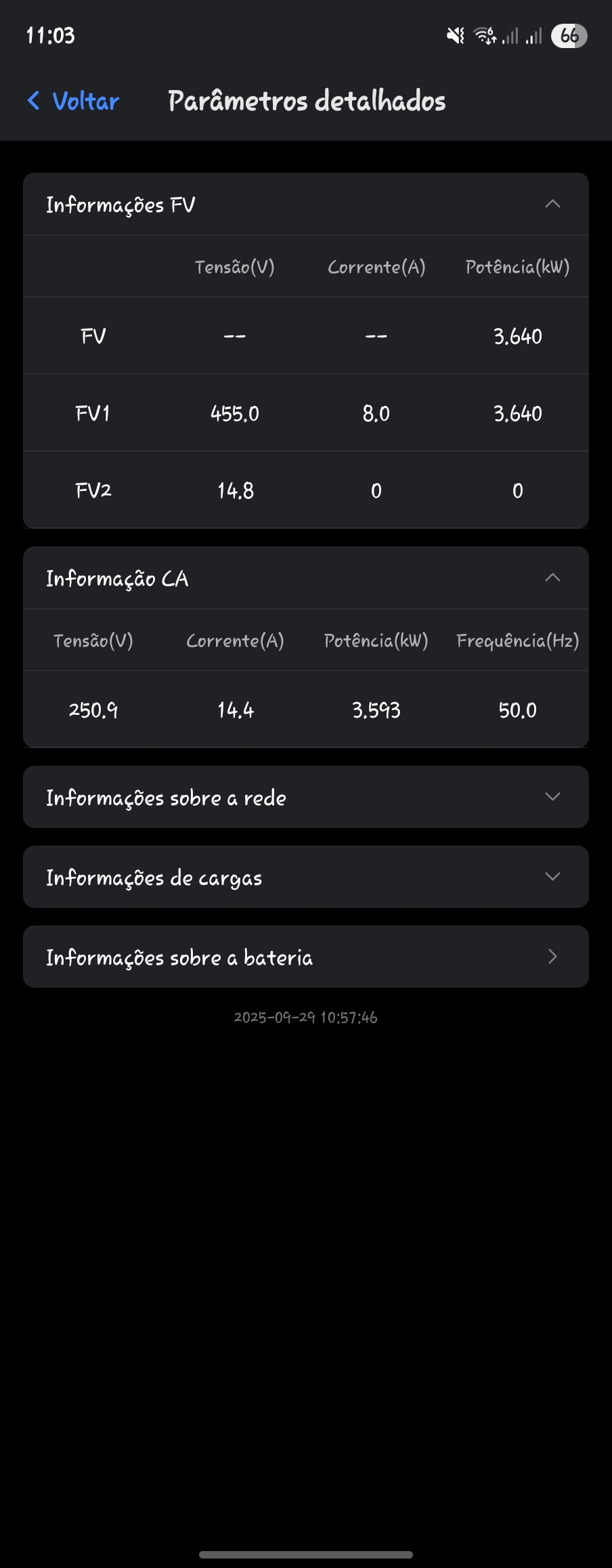

Attached are photos.
Version is H1-6.0-E
I can't see if it's G1 or G2

Ok that is a generation 1 H1 (manufactured 2022) - not sure why that would have been supplied the Gen 2 has been out for well over 18 months ?
The Gen 1 will definitely not support the panels you have fitted in a single string and they are unable to meet the maximum current those panels are capable of ~ maximum power per string is at best 4000 watts.
Maybe your installers think it’s a gen 2 and haven’t checked the model number which is why they might think it should support a larger string, but the gen 1 will not.

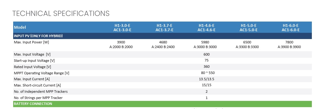

But PV1 is far from 13.5A. That would be the limit of the inverter.. Or not? Or does it have nothing to do with it, and the 4kw is the limit per MPPTs?

This is the H1 generation 1 spec - you have the maximum current limit or a maximum power limit, whichever comes first - because you have such large panels with a higher operating voltage the current is lower - but you will still bump into the maximum string power limit.
You will need to split the string into 2.

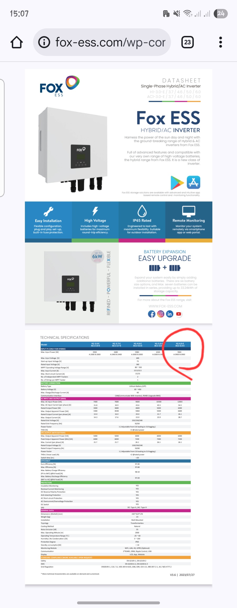

What refers to is the 3900w by MPPT A is 3900w MPPT B
How in the data sheet?
