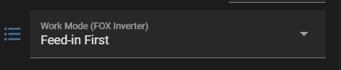

I have looked in Home Assistant .. but cannot seem to figure the best way to automate this. When looking in Automation, the below entity does not seem to be selectable?

In the automation, click add Action - in the ‘search action’ box type ‘select’ and choose the one that says Select:Select (choose an option)
Click ‘Choose Entity’ and start typing ‘work’ and select the ‘WorkMode’, then in the Option box you have to type the option text exactly as follows (and match the case) -
for Feed in it is Feed-in First
and for Self Use it is Self Use
That’s it - when the action runs it will change the workmode.

Thanks Dave, it was that "optional" bit that got me .. I was expecting to see a "selection" ..... I wil try this out
