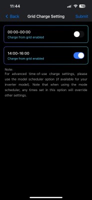

When you say you are setting a Force Charge during the day, do you mean a schedule to Force Charge, or is it the Charging Time in 'Quick Settings' you are using.
Can you post an image of the schedule settings you have currently set please

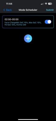

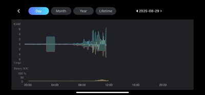

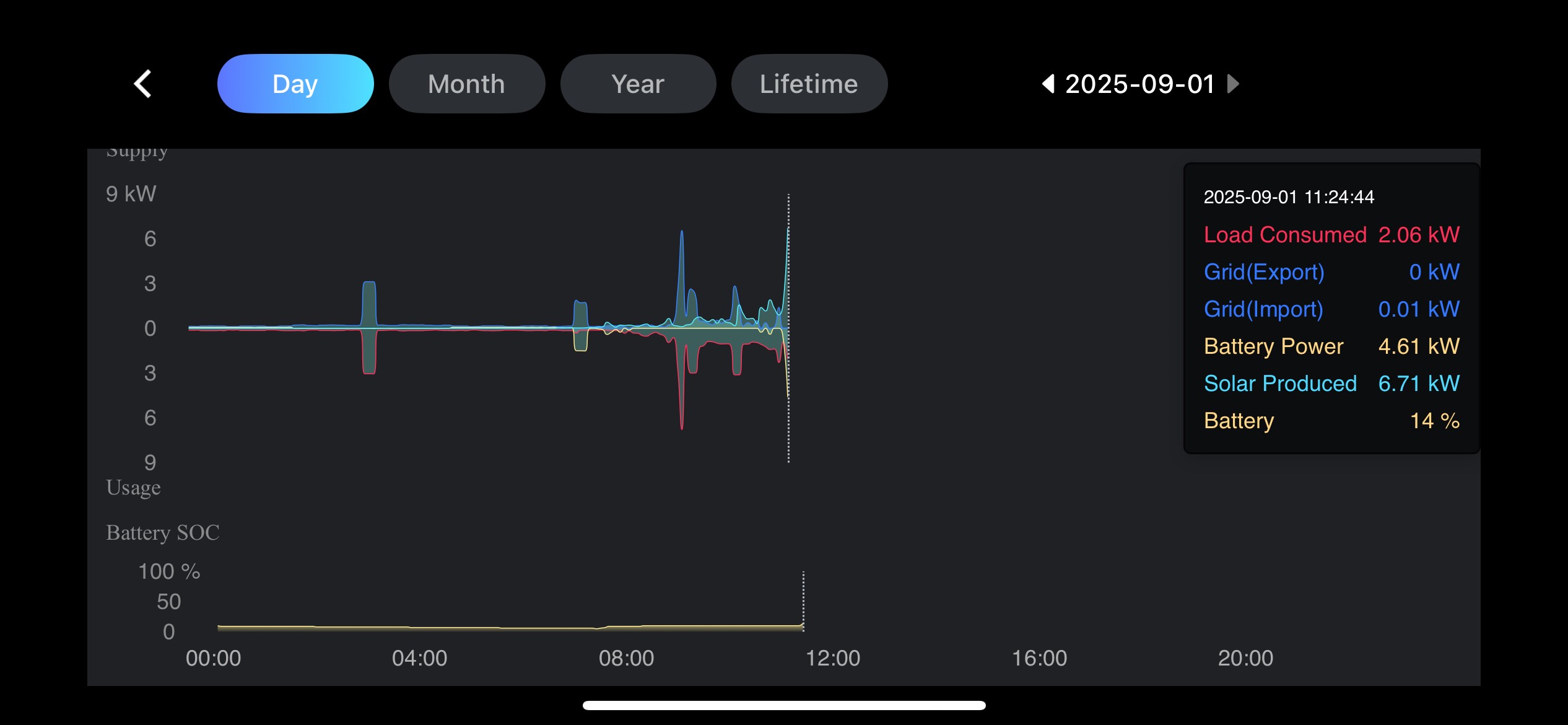

Can you show your schedule settings with the overnight charge set so I can look for a conflict, also if possible can you post the graph from the app when you've tried to charge overnight - i.e. does it do anything even a low power charge ?

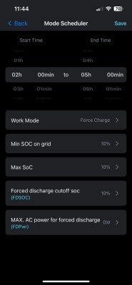

Ok I think your problem is that on the schedule for Force Charge you have set a MaxSoC of 10% - and as your minSoC is also 10% it won't charge at all.

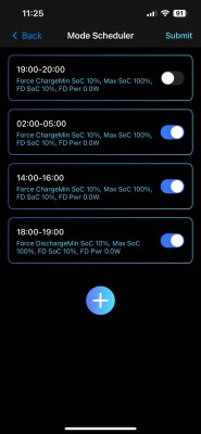

Morning,
So I Changed the max SOC and it refused to charge overnight.
Went back to scratch and set up as attached on Saturday - still not charging from the grid?
I’m clutching at straws a bit but have you definitely pressed the submit button top right as that without that it isn’t set and needs to be sent to the inverter - in the V2 app on the quick settings screen you should see Mode Scheduler say ‘Enable’

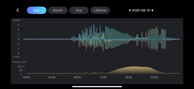

Interestingly the battery charged from grid today between 2-4pm.
I’m baffled why it won’t charge off peak during the night?

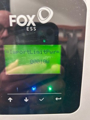

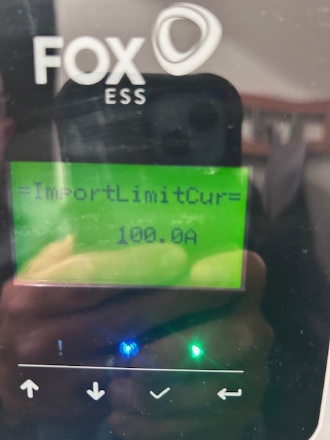

Hmmm interesting, for the next bit can you go into the inverter settings and check to see how 2 options are set.
If you don’t have agent access to the app you’ll have to do this from the inverter front panel but go into ‘settings’, ‘on-grid’, ‘export control’ and see if you have entries for ImportLimitPwr and ImportLimitCurr - if you have those entries can you post what they are set to.
For some strange reason your import limit (power) is 10 watts, your current is correctly set to 100A - that means your inverter won’t take anything off the grid and the reason it charges during the day will be because you have solar generation which is being used instead.
It’s likely the ability to make these settings was added after your original install if you had the firmware updated but it’s unusual for the import limit to be set to that (unless you really don’t want to use grid power).
Can you change the ImportLimitPwr to 6000 watts, and hopefully you should be charging again tonight
