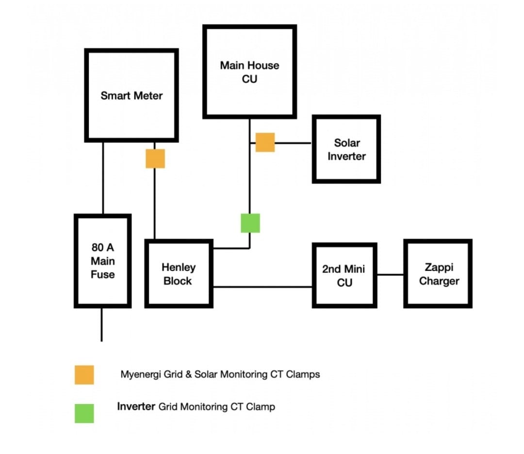

Yes you should see the load reading change when anything is turned on in the house, admittedly the data samples are only taken every 5 minutes so you need to wait at least 6 minutes to be sure but if it does not change then the load is not being seen by the inverters meter/CT clamp and consequently the batteries would not be used to supply it.
As you’ve got 2 phases running into the house and one inverter on each phase any load on that phase must be seen by that inverter, there are exceptions for example EV chargers tend to be fitted ‘in front’ of the inverters (grid side) so they don’t see it as load and flatten the batteries.
From what you have said the AC system and other devices may not be connected to either of the phases (i.e. they are on the 3rd phase) or they have been fitted in front of (grid side) the inverters meter/CT clamp and so they are not being seen.
