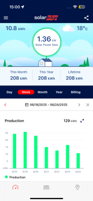

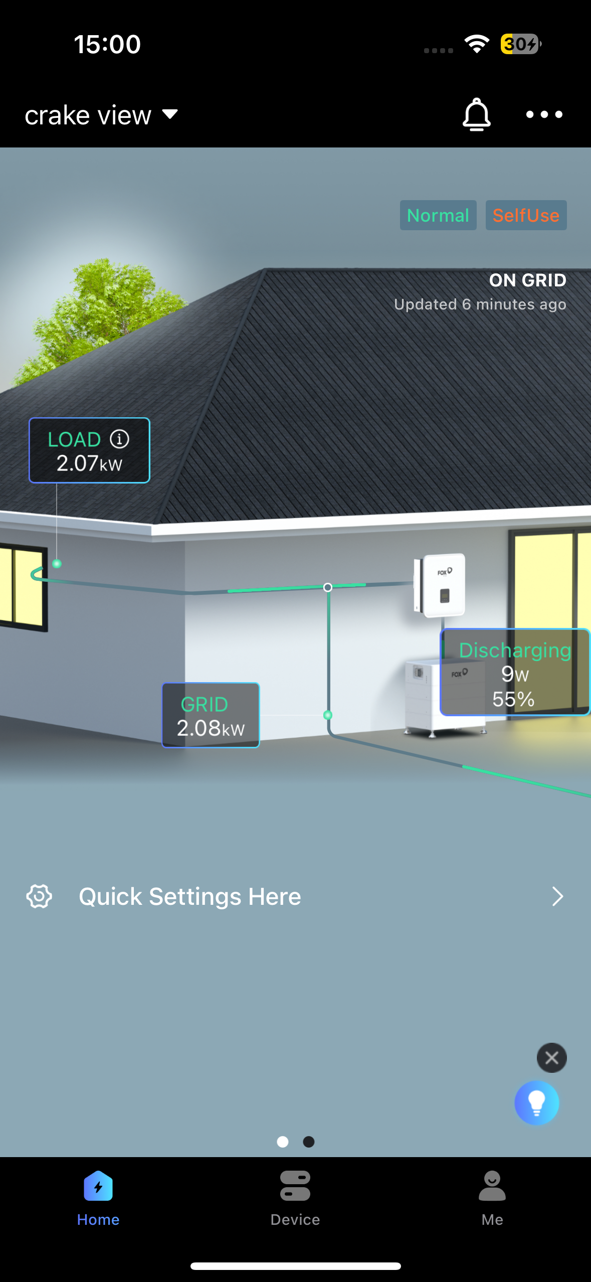

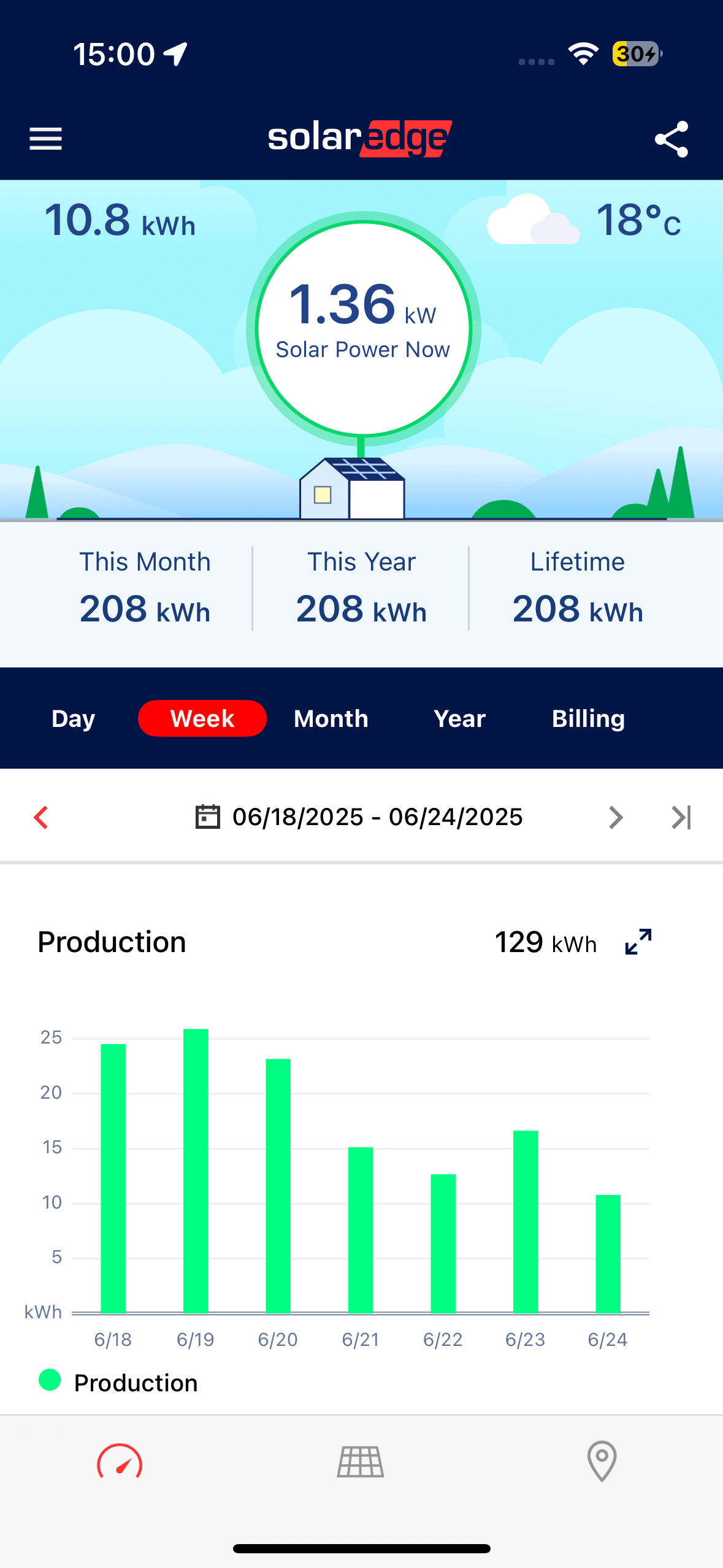

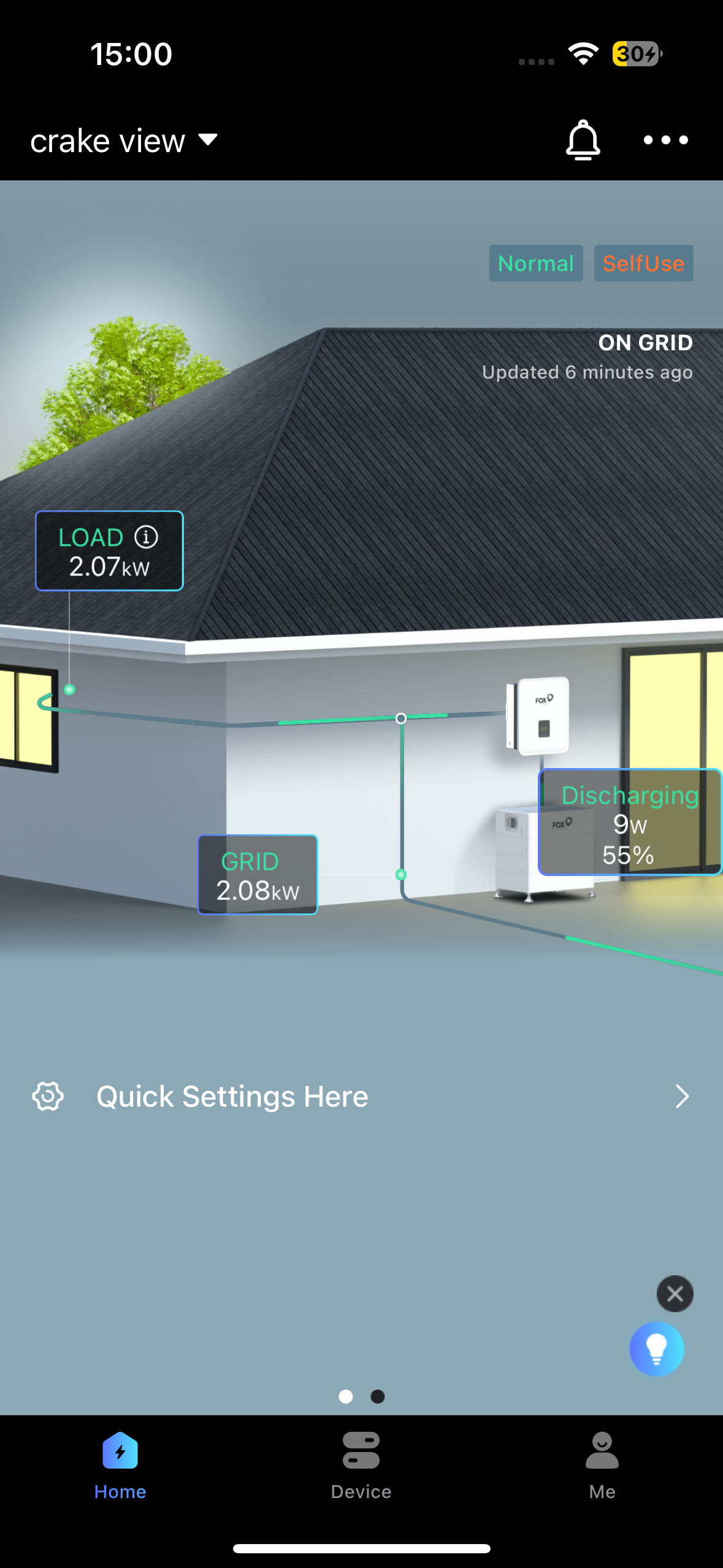

However, we appear to be having issues with the 2 systems (solar and battery) not communicating with each other. We have 2 separate apps for each system. The Fox app does not show any solar panels or any solar power whatsoever. It appears that the batteries are only charging off the grid as when the batteries are charging, our usage on the smart meter increases drastically. Within the SolarEdge app, the panels are definitely consuming solar energy but I assume it’s just being given back to the grid. We are not on a tariff yet so we aren’t making anything from this.

I have attached a screenshot of the Fox app and the SolarEdge app.

You'll need your installer to add a CT2 ct module around the ac output of the solaredge and enabled it within the fox system so show live solar data within the fox app.
