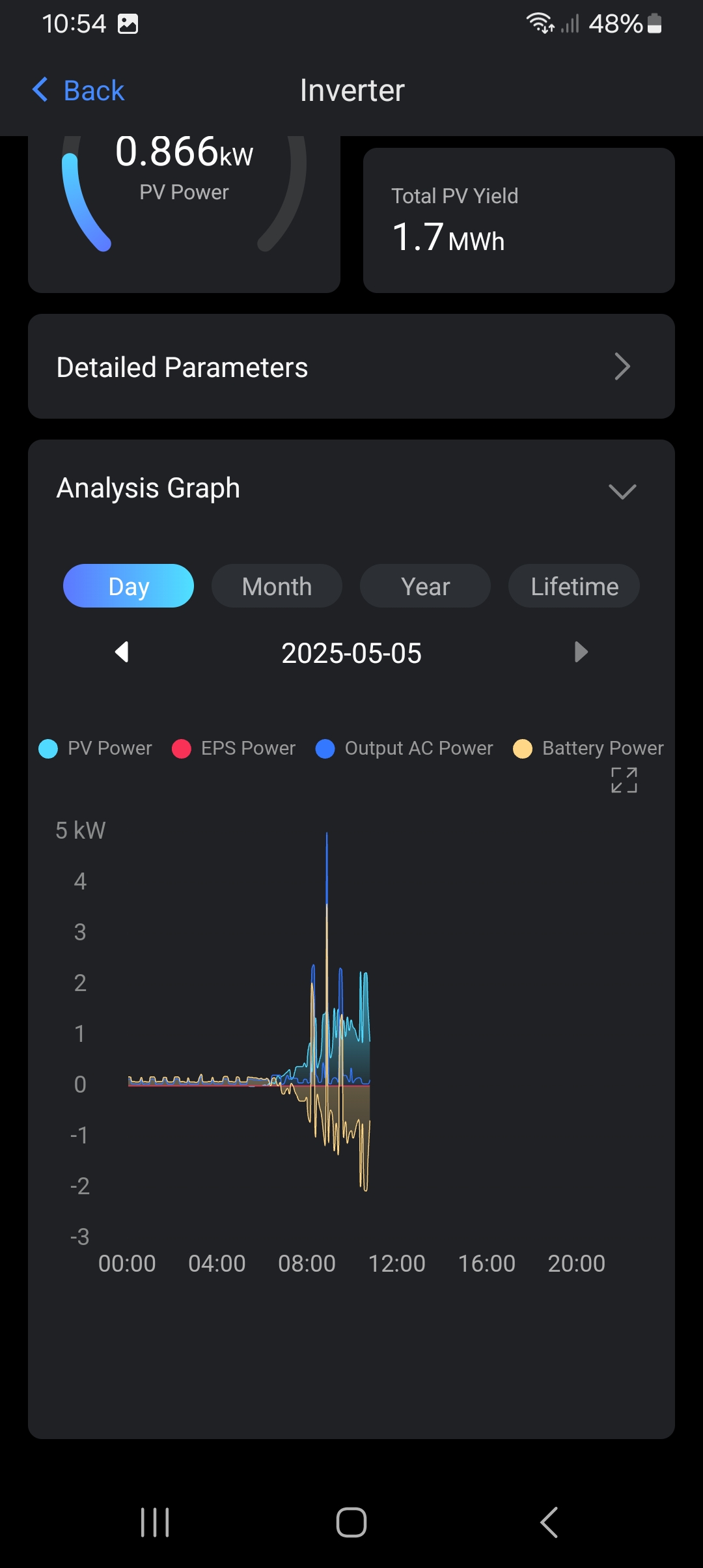

Re: system

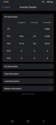

Good afternoon , Please see attached two photos of the PV graph, and the Inverter as requested.
Looks like there is two strings, Is this correct for sixteen panels.
Do you think the inverter is sufficient for the system i have.
Regards
David Clements
Re: system
I think 12 panels are working on one string and the extra 4 on another string. do they need to be 8 panels on each string.
Regards Dave
Re: system
The voltage showing does confirm you have both strings active, I assume that screenshot must have been taken when it was cloudy - with 4 panels you'd expect to see around 120 volts in full sun, and for the 12 panels around 360 volts, but the installer could have wired some of the panels in parallel i.e. 6 || 6 so the voltage would be lower ~ i.e. 180 volts but the current would be much higher.
The answer to the 12 panels on one string being too many question is 'it depends', if you have 12 panels on one roof all with the same elevation the answer would be a resounding yes, the power is too high for the inverter to handle and it will clip in full sun. But as you have different roofs / elevations you may be hitting peak sun on one roof in the morning and peak on the other in the afternoon - the net result being that it will work fine and won't be clipped as the maximum power is never too much to cause problems. Going back to your neighbour, if he has 8 panels pointing in a clear and uninterupted direction that gets sun all day, it is possible that he will get more power than you as they will always be operating at a higher power.
If you use the Foxcloud website and go to the Inverter Details screen (click Device, Inverter and then click the blue search in the operation field) - you will see your device status, energy flow screens and a power /statistics graph - but below that at the bottom of the page is an 'empty' graph - here you can select different sensors to view and compare to see how they change over the day.
If you can select PV1 Volt and PV2 Volt and 'search' it will show how the voltage changes across the day and you can pick which day to view - if you could post that image on a sunny day that would be really helpful. Also if you can choose the sensors PV1Power and PV2Power you will see how the 2 strings produce power across the day, again a very useful graph as if the inverter is clipping the peak power will have a flat top to it rather than a curved peak - again if you could post that graph for a sunny day it would help to see how your system is performing.

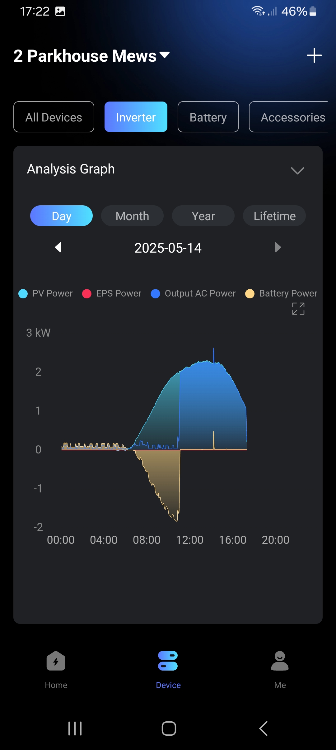

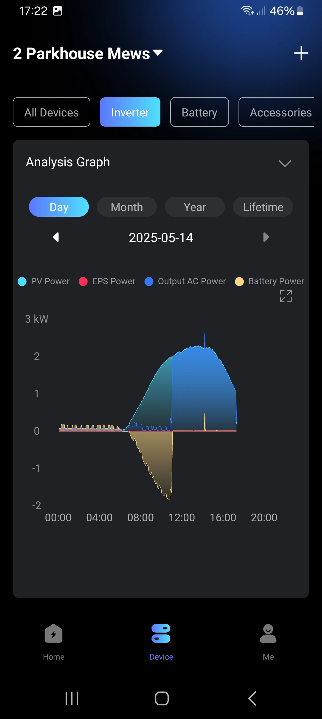

Re: system

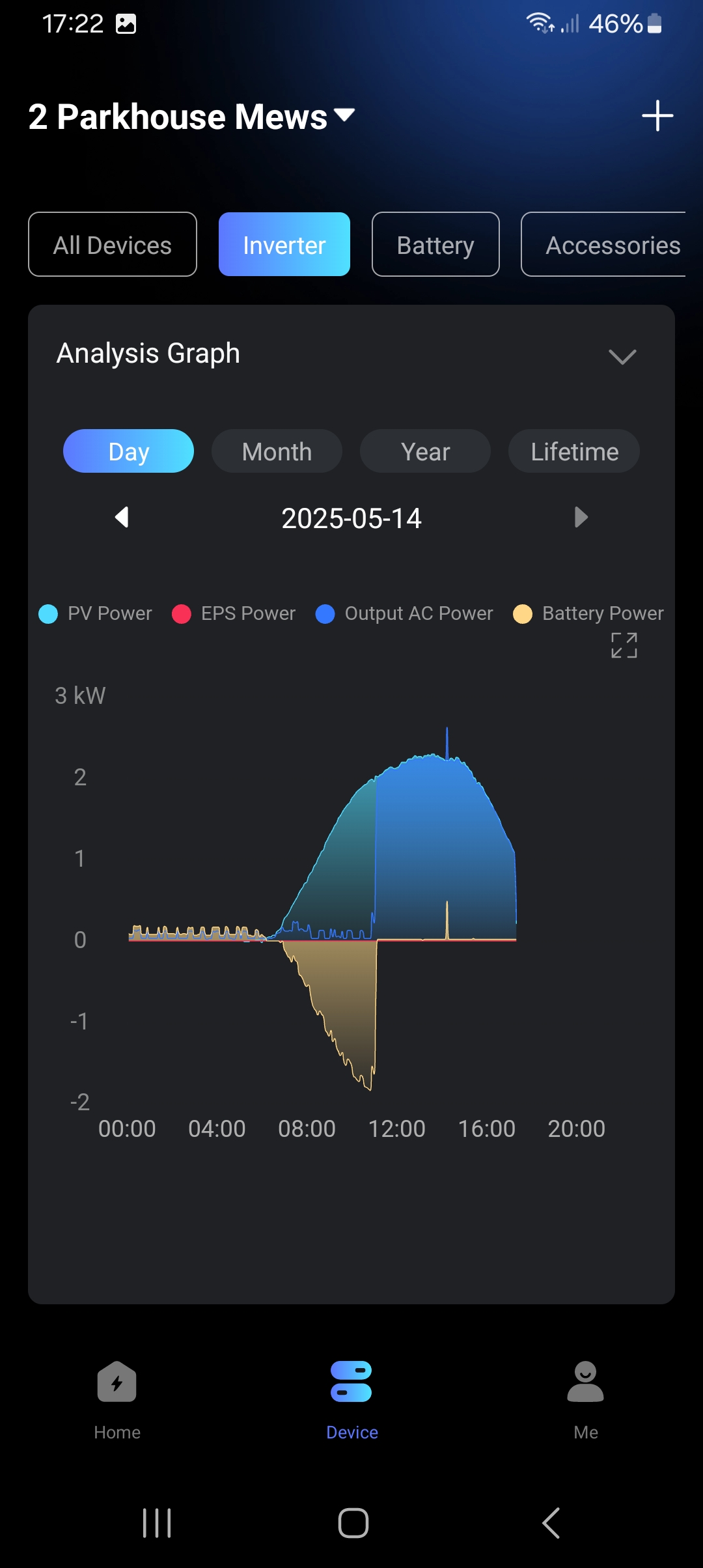

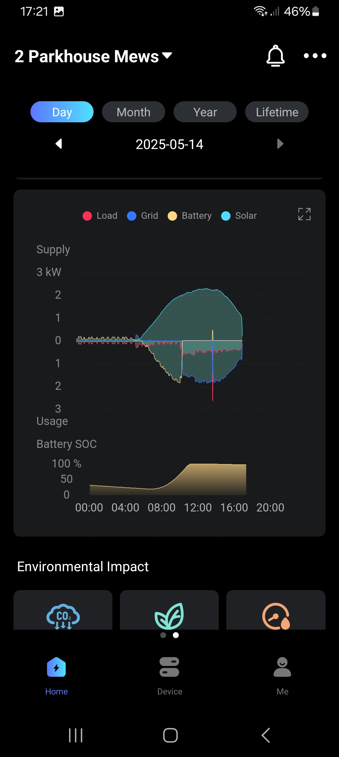

Is this the info needed two pic. please see below.
I hope I have done this correct
Regards Dave
Re: system
I hope these pictures help.
Re: system
No the app isn't much use in analysing things like this, you have to use a browser and go to www.foxesscloud.com and log in there with your same credentials as you use for the app.
When you get logged in, click 'Device' and under that 'Inverter' - it will list your inverter details and at the far right under operation - click the small blue search icon.
Scroll down to the bottom of that page 'Inverter Details' and you will see an empty graph, where it says 'Please Select' find and click on PV1Power and PV2Power and search - if you could screen shot that graph and attach it below.
Then clear the search and this time select PV1Volt and PV2Volt and search, again if you could screenshot that and attach it please.

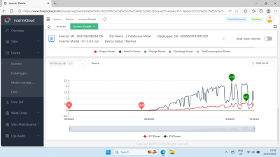

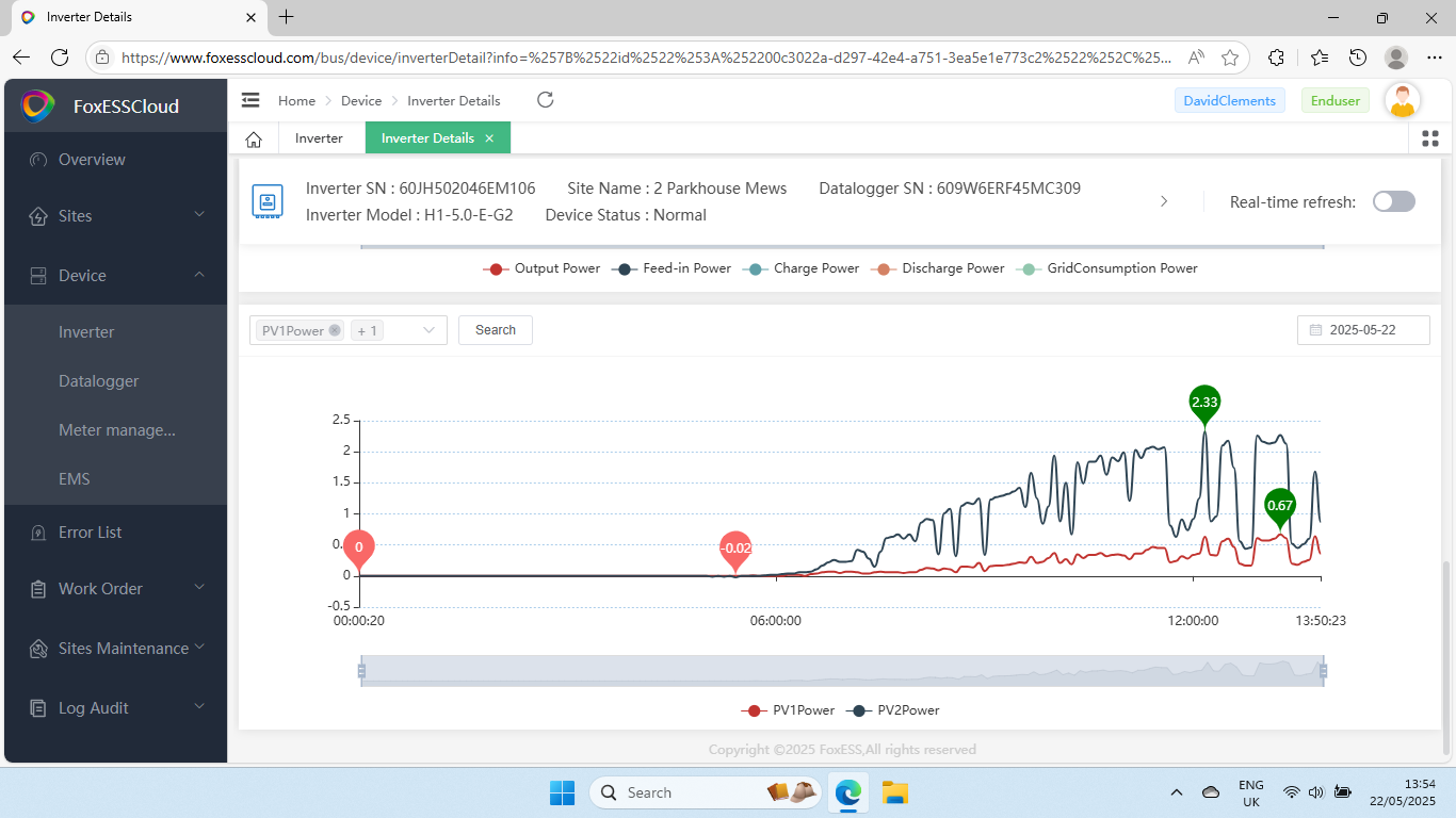

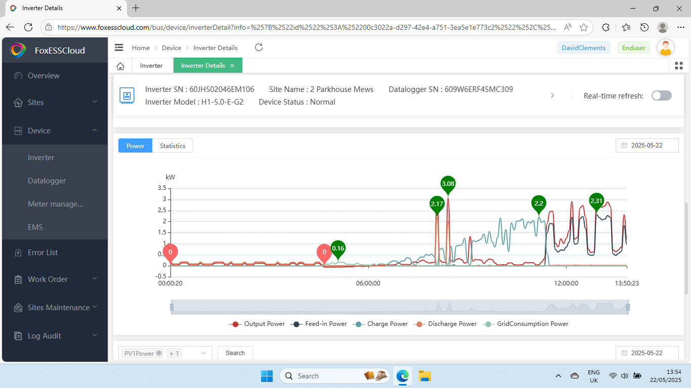

Re: system

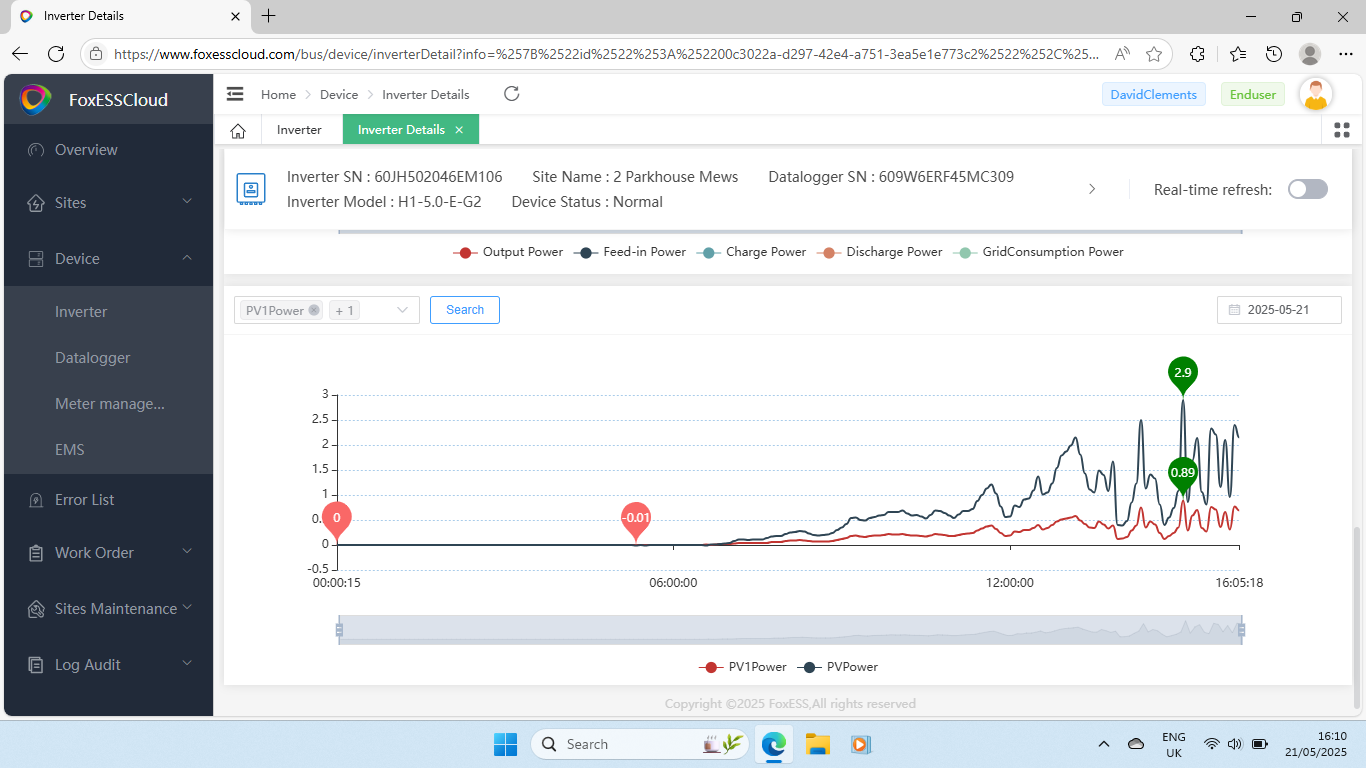

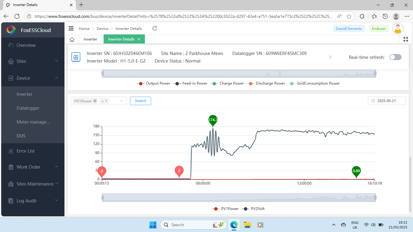

here are the graphs you asked for, hope they help.
The company that installed the system have put 8 panels on each string
but my neighbours 8 panels are producing more than my 16 panels.
Please see files below.
Regards Dave
Re: system
Looks like PV2 has a problem, very low voltage.

The graft pictures where taken on a cloudy day. probably not the best day to do it.

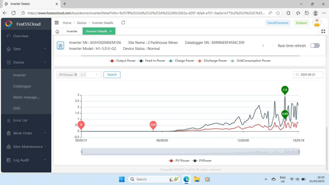

Re: system
Here are the up to date grafts.
As i have said before i had 12 panels running on one string, I have added another 4 panels, My installer then put
8 panels on one string and 8 on the another string. 16 panels over 4 roofs.
My neighbours have 8 panels and is producing more than my 16.
Re: system
Doesn't look like PV2 is happy at all. likely one of the roofs is going into shading, which tanks the whole PV2 input.
I would personally try to move the roof(s) which are not in an ideal direction to their own string inverter like a fox S1500 string inverter so it can be managed on it's own mppt.

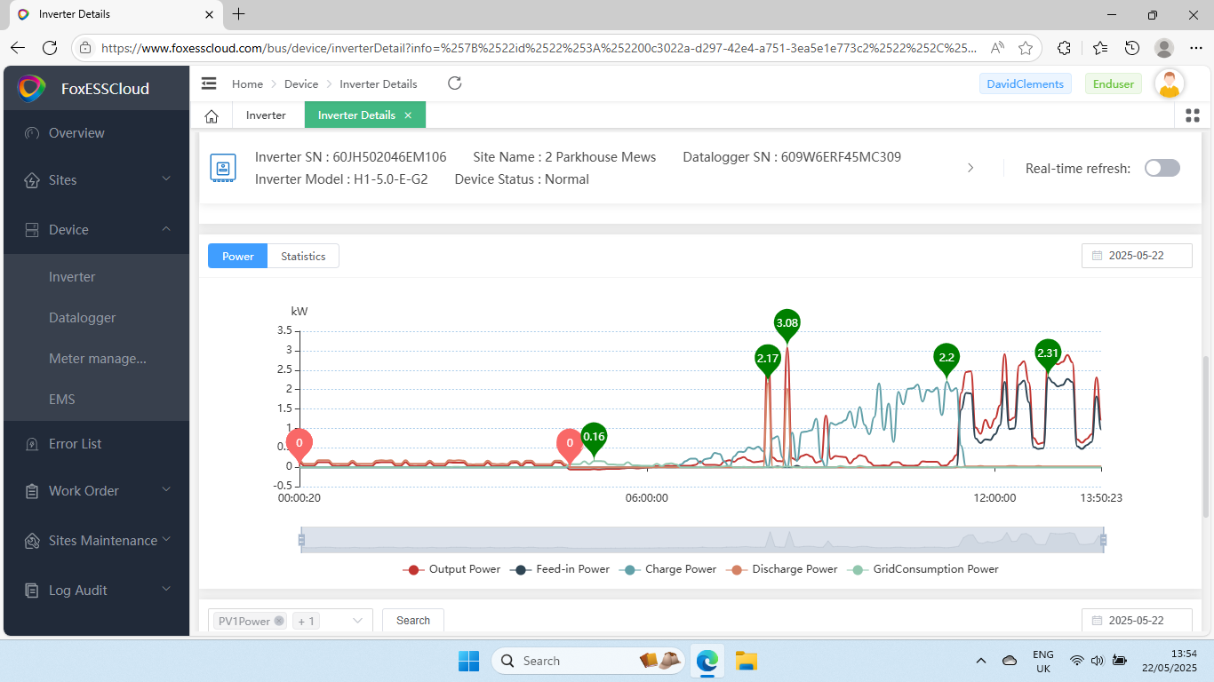

Re: system
update off strings, As off midday Monday.
Regards Dave
Re: system
sorry, I now see that the PV1 PV2 are power not voltage. So it appears to be working as expected

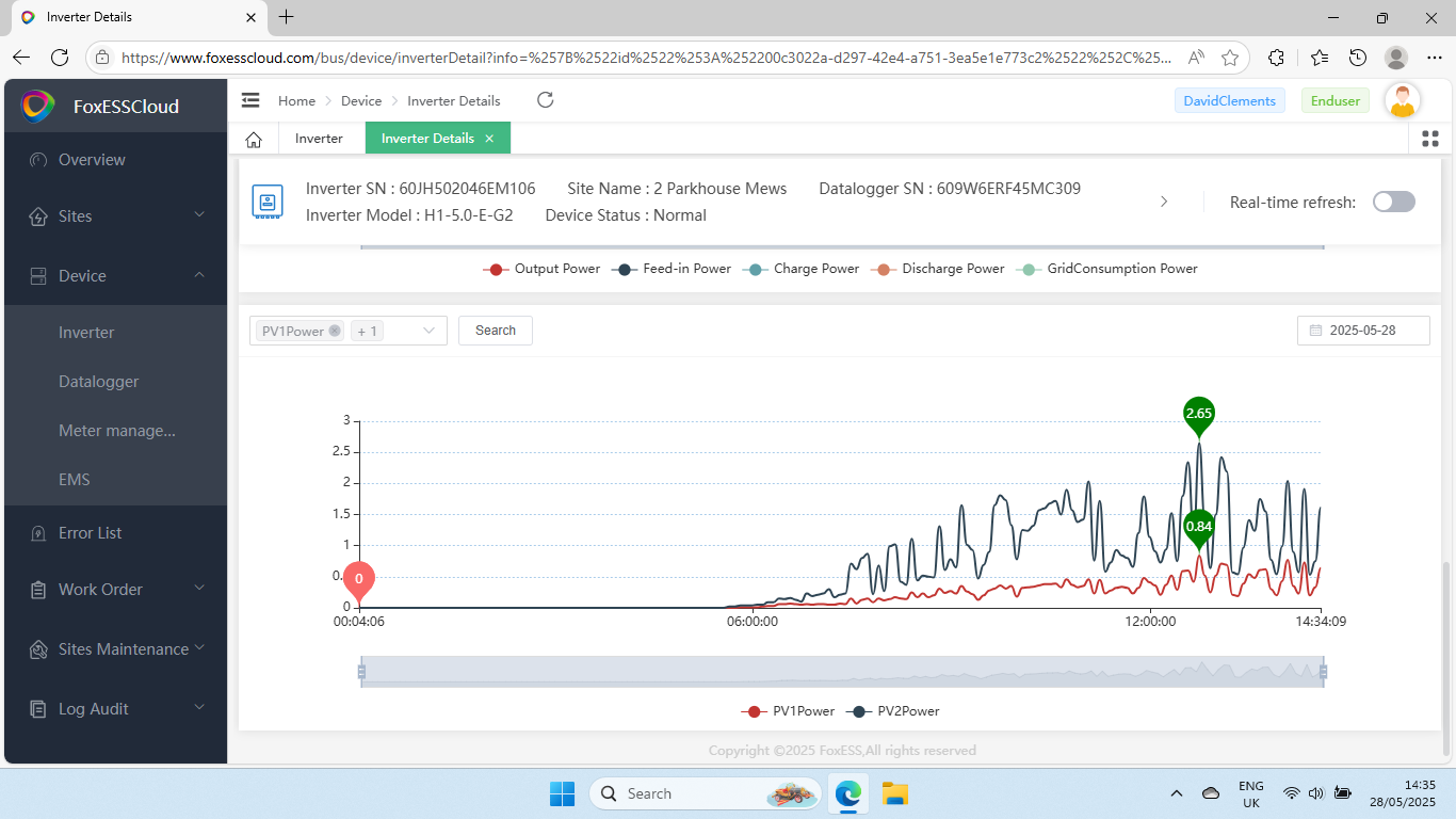

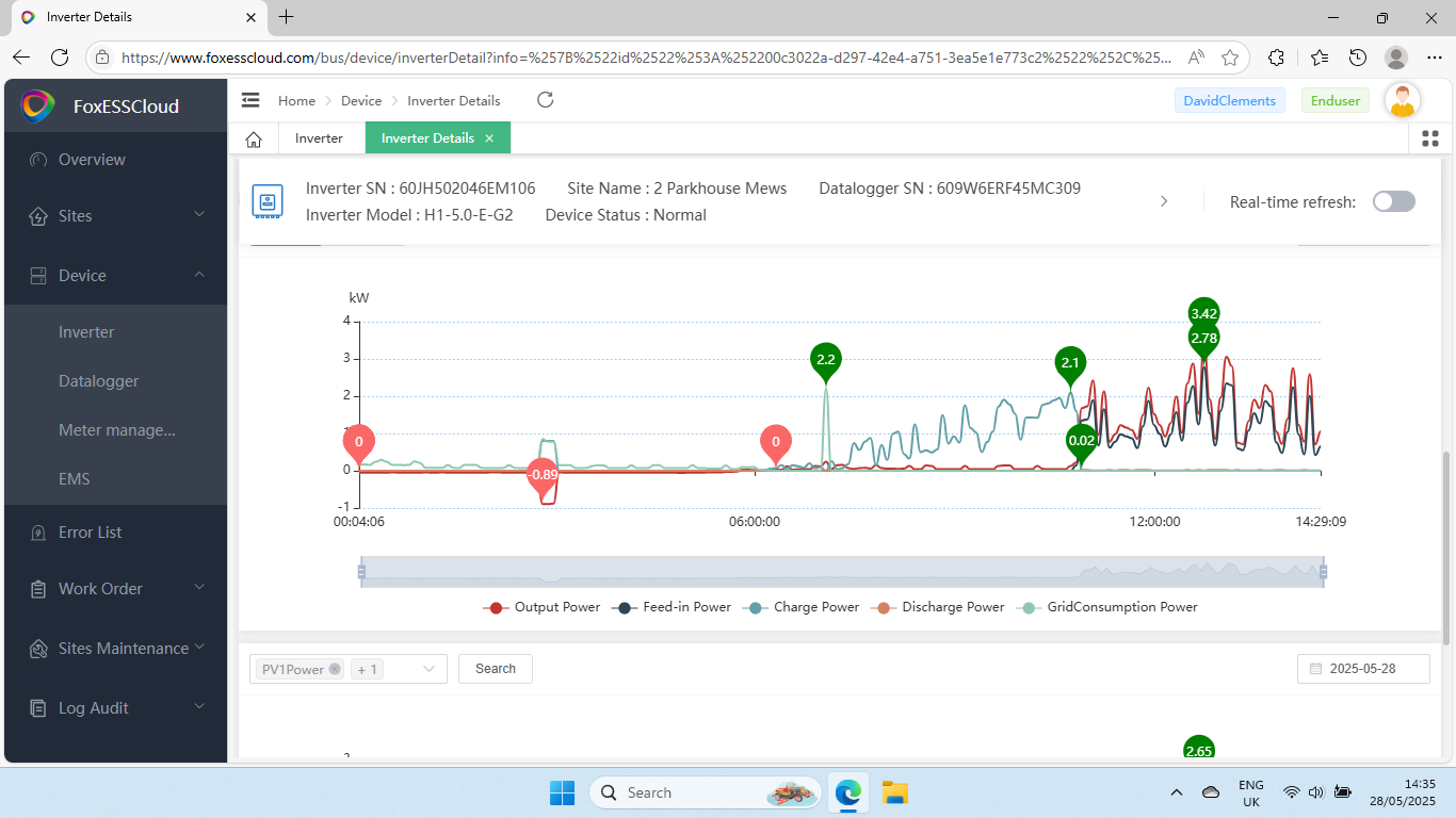

Re: system

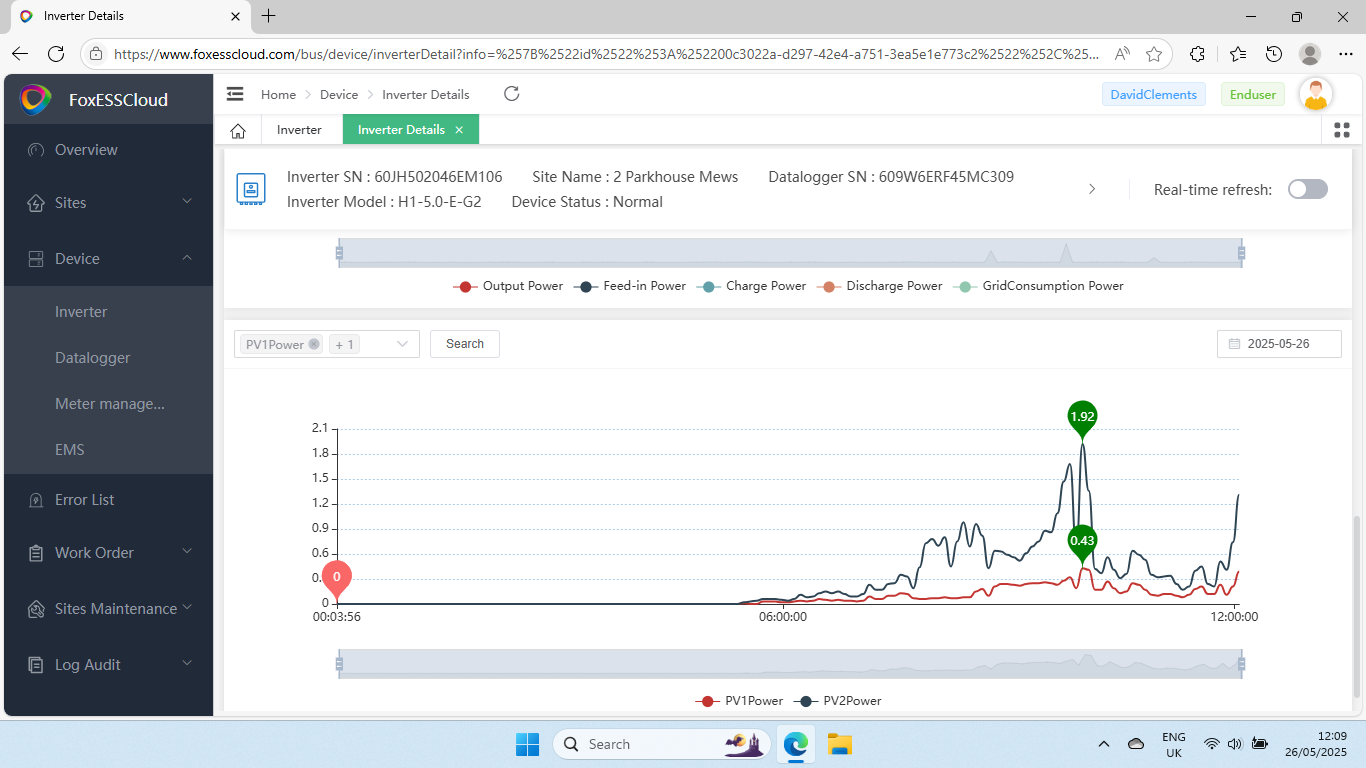

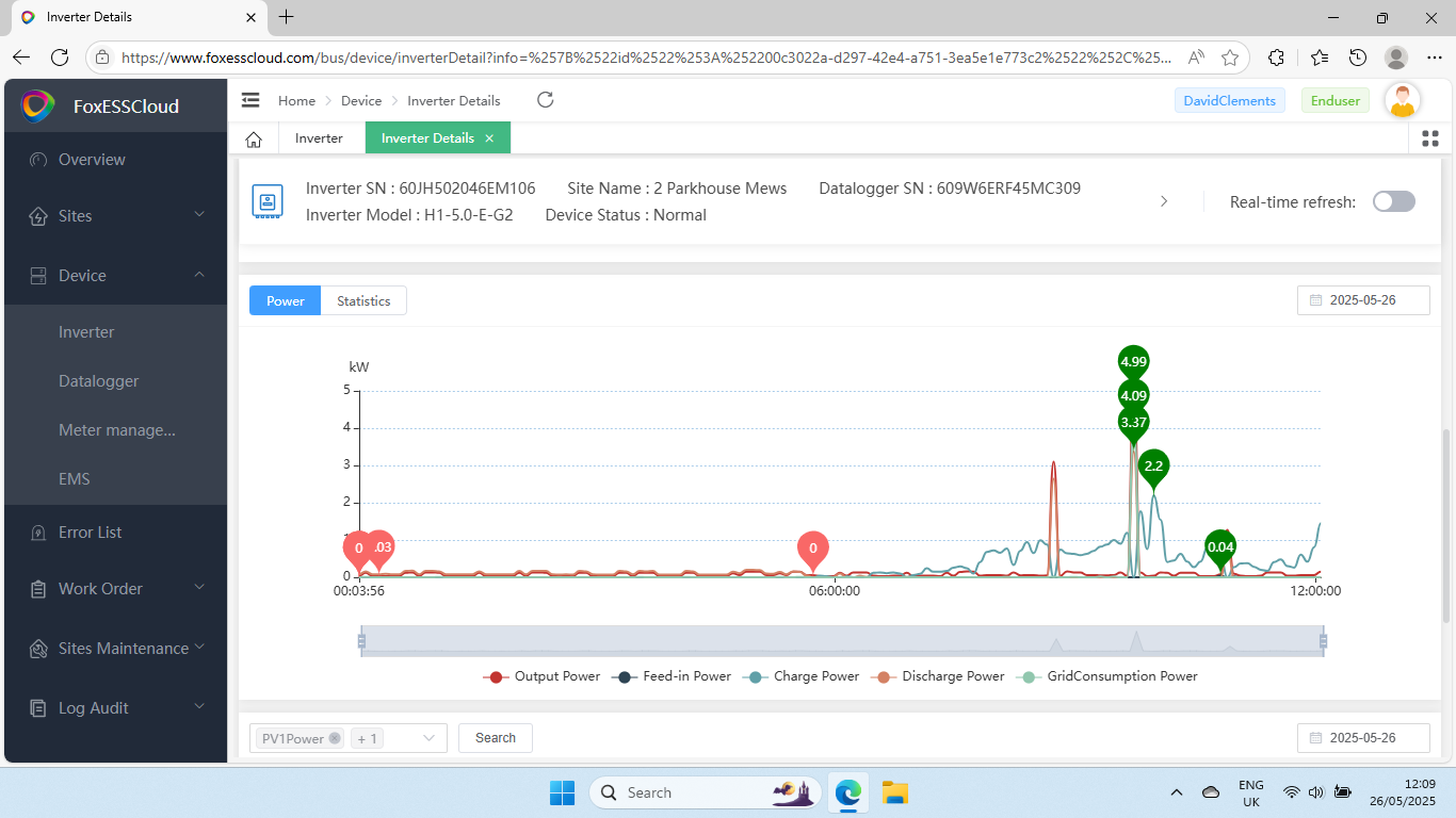

latest graphs
Dated 28/ 5/25
cloudy morning ,sunny afternoon.
All 16 panels had sun on 14.00.
Regards Dave
