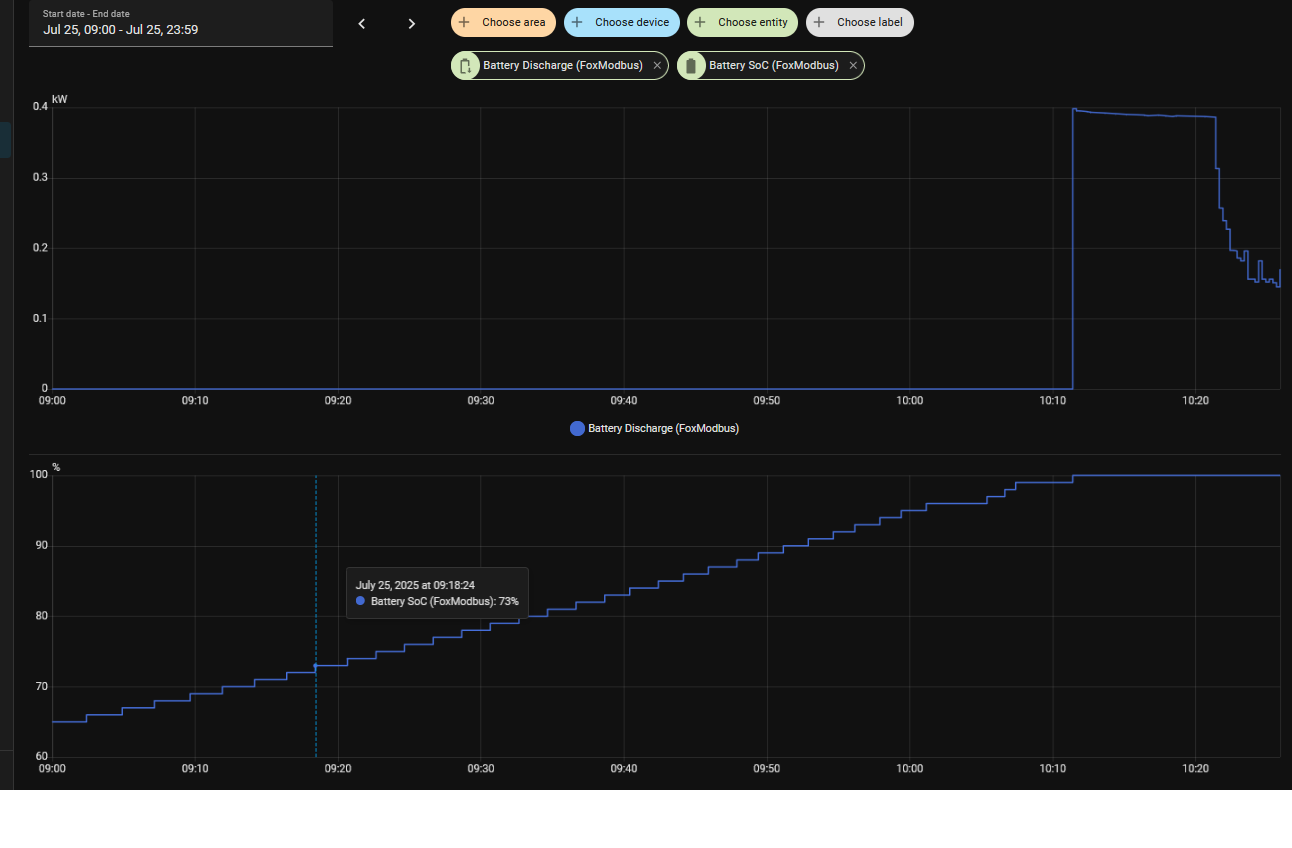

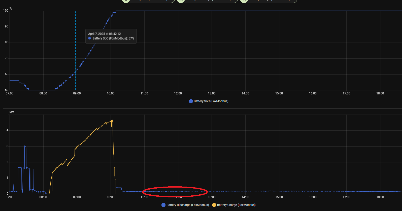

I notice that there is a quite constant value for battery discharge (from modbus) when the SoC reaches 100%, while there is enough sun (feed-in). Can anyone explain?
Although the SoC does not reduce, I still wonder where this discharge comes from.
It's around 160-190 W.

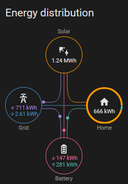

Also what I noticed (I assume somehow related) is that the energy counter of the battery cannot be true (Battery Charge/Discharge Total (FoxModbus)).
According to this, my Battery produced more energy during last month than it consumed (charged) :D

Unfortunately not. Same behavior, even I updated to the latest firmware couple of weeks ago.
Today for example, I see that the discharge started straight with 400W once the SoC reached 100%, and is slowly decreasing to 160-190W permanent discharging.
