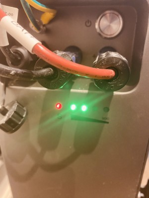

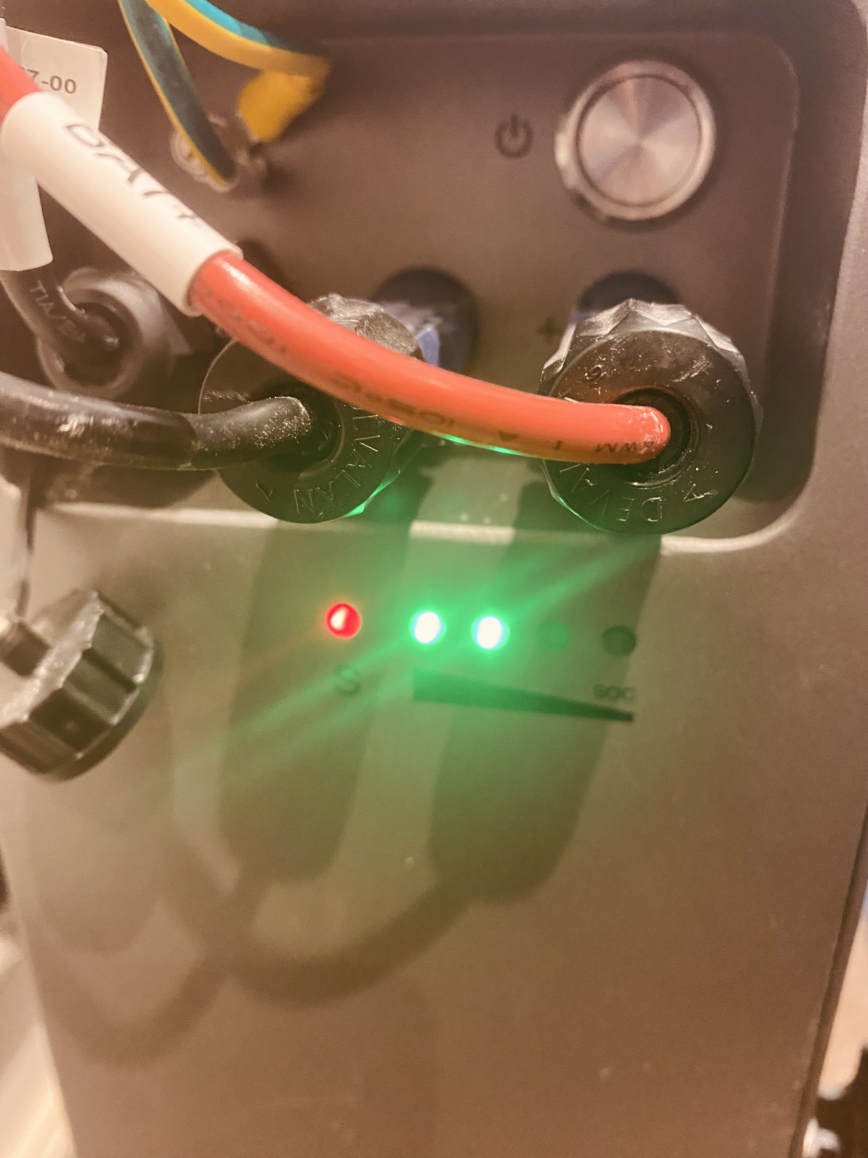

Can you upload a picture of the lights and I can compare the lights with the error codes in the manual.
Re: EPS battery idle for no reason

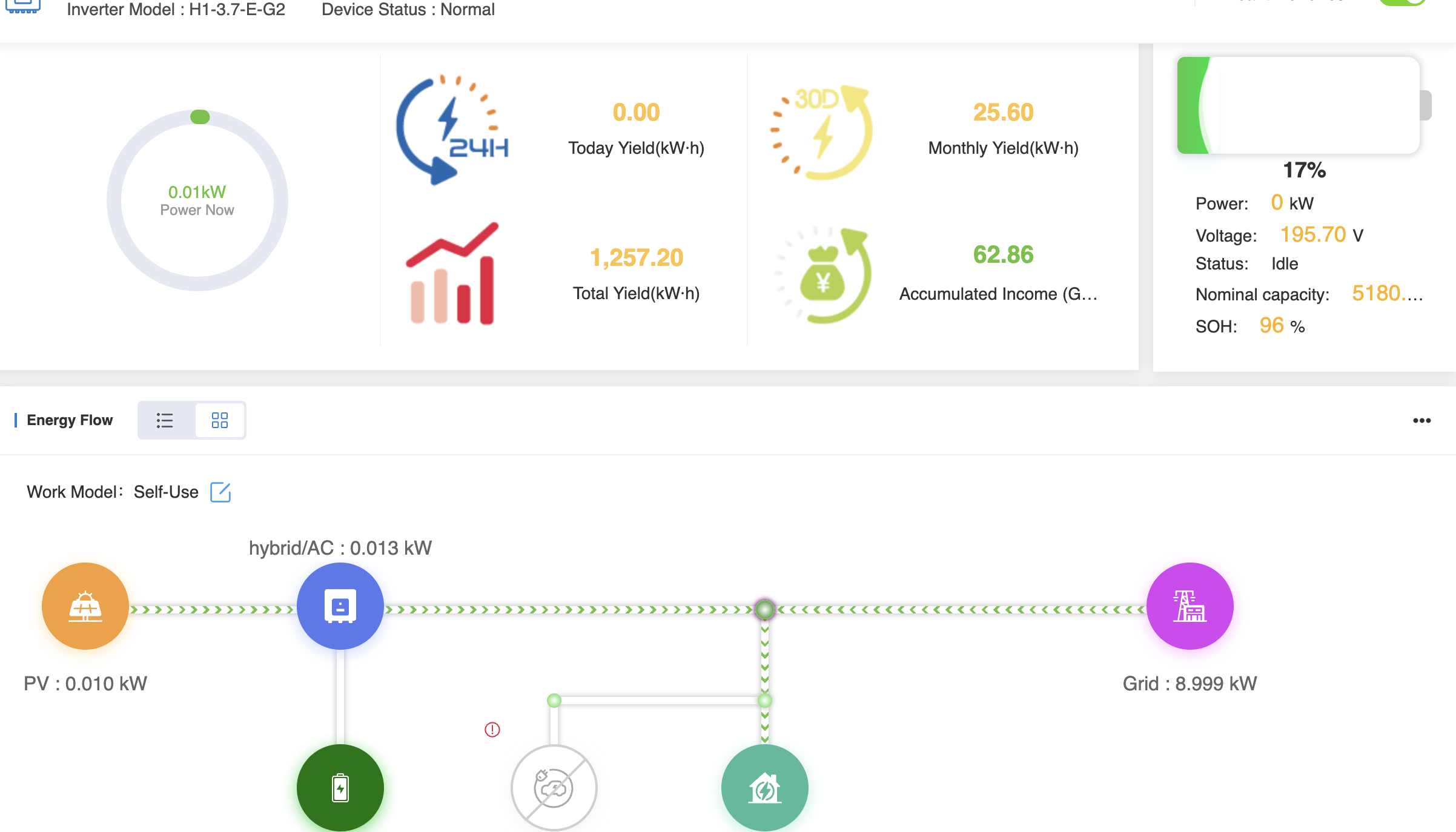

Thanks , clearly the red light is flashing , I left battery powered off for a day same news, Ive attached picture of lights and screen shot of web interface

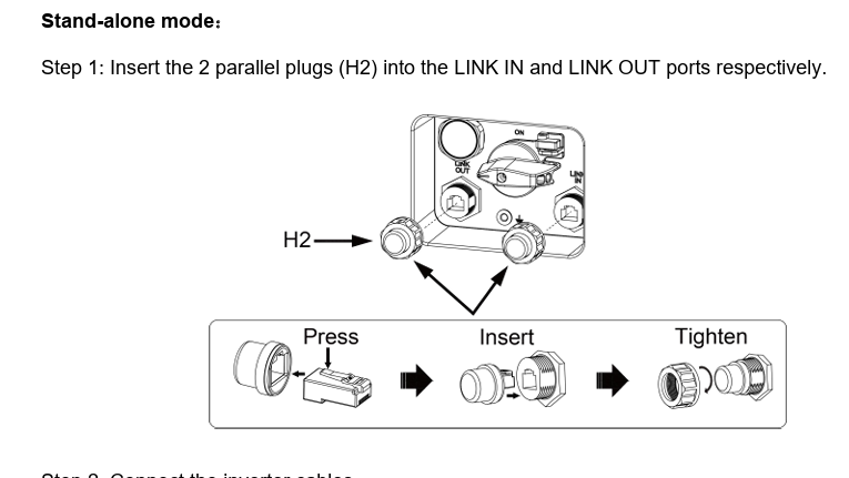

That error light matches the error "Module addressing failed". Are the blank plugs with the rj45 jumpers installed on the left side of the battery? You need to install the blank plugs under the caps when using one battery.
As per
