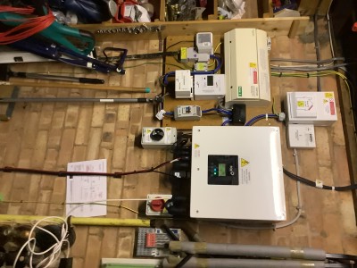

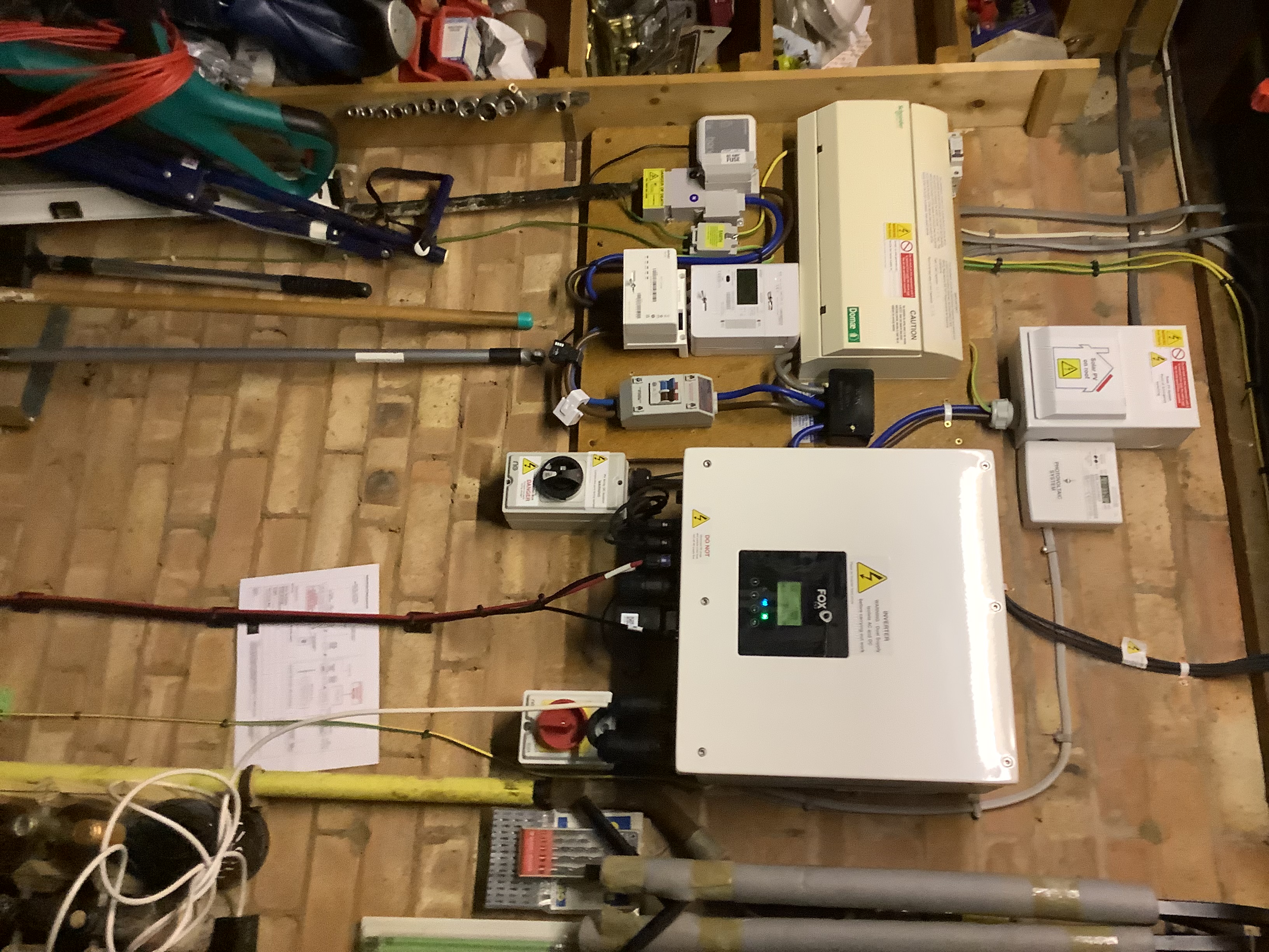

The easiest way to deal with this is to make sure the EV charger is connected in front of the inverter so that the inverter does not see it as house load and won’t discharge the home batteries into it. This could require a bit of re-wiring (usually a henley block) to split the feed to the house / EV charger - sometimes you may be able to re-position the inverters CT clamp so that it doesn’t see the EV.
You can set a charge period for the same time as the EV charger is charging with the ‘charge from grid’ disabled, that will not charge the home batteries but will also stop them from discharging as well.
It is possible to use a home assistant to do this programatically whenever it sees the EV charging it sets the battery to stop discharge but there is quite a big learning curve ahead of you there unless you are considering that anyway - which is why I started with the easiest solution is to re-wire it to split the feeds.
