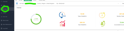

When I look at today's yield on the "my sites" section of the webportal, I see a today yield of 18.9kwH and a monthly yield of 307.
This is consistent with what I see on my app.

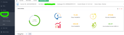

But when I look on the inverter page on the device>inverter left hand drop down it gives me 15.3 kwH for today and 279.9 for the month
I'm wondering why these (and the monthly and annual figures) are lower when I look on the inverter page than they are on the main page?
Can anyone help me understand why?

The figures on the Sites Detail page are the Solar Production for the day and the month.
Whereas the figures on the inverter page are Total Yield which is all the work that the inverter has done whether from solar, grid or batteries.
Re: Difference between app and website figures
Dave Foster wrote: ↑Tue Mar 18, 2025 2:11 pm The figures on the Sites Detail page are the Solar Production for the day and the month.
thanks Dave. That still leaves me a bit confused. The figures on the site detail page are higher than those on the inverter page. Which makes no sense, given that the inverter page should include the figures from the PV but also more action from the batteries and grid?
Well that’s interesting it’s the other way round on my H1 (gen1) but that’s why they are different - the stats used to show exactly the same number (Total Yield = all work) but when Fox added the solar production to the V2 app they modified the way the stats appear on the webpage as well and it looks to be buggy - there’s not much sense in this.
Fox are working quite hard to complete their V2 website it’s a few months late at the moment but expected soon and then hopefully all of this will be visually re-designed.
