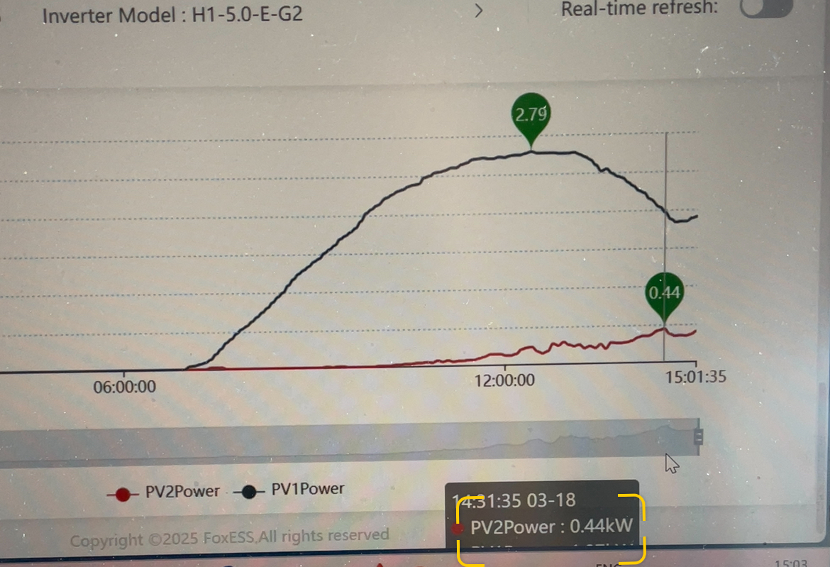

The attached file shows the power generated on the 8th March, a beautiful sunny day.
Am I right in thinking the PV1 and PV2 are the separate arrays? If so one array of panels have barely generated anything? (I assume the 4 West).
Surely this cannot be right? Especially when it was a clear day with sunshine all day.
How can I check further and why would the west generation be so low?

Yes PV1 & 2 are your seperate arrays - PV1 looks ok for 8 panels of around 400 watts at this time of year, PV2 looks low but at this time of year for west facing panels the suns elevation is rapidly falling from mid afternoon.

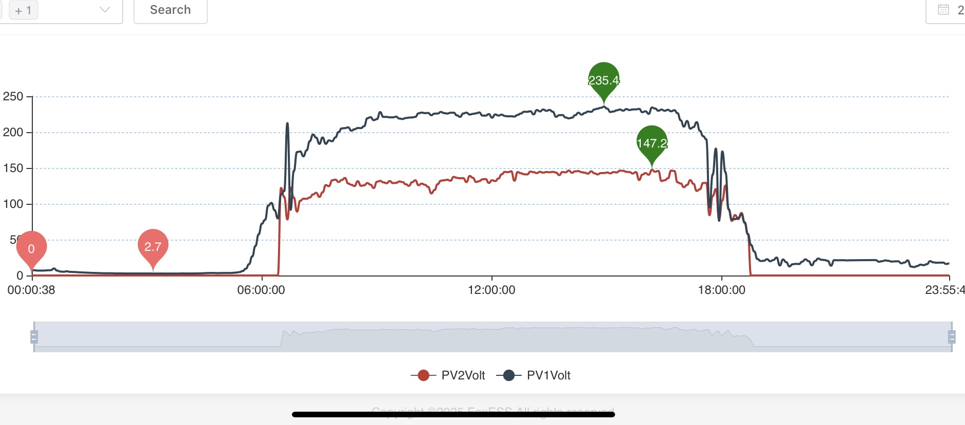

Attached is the Voltage for both arrays Many thanks

Your PV2 volts looks ok and suggests the sun is effectively on them from 1pm-4pm.

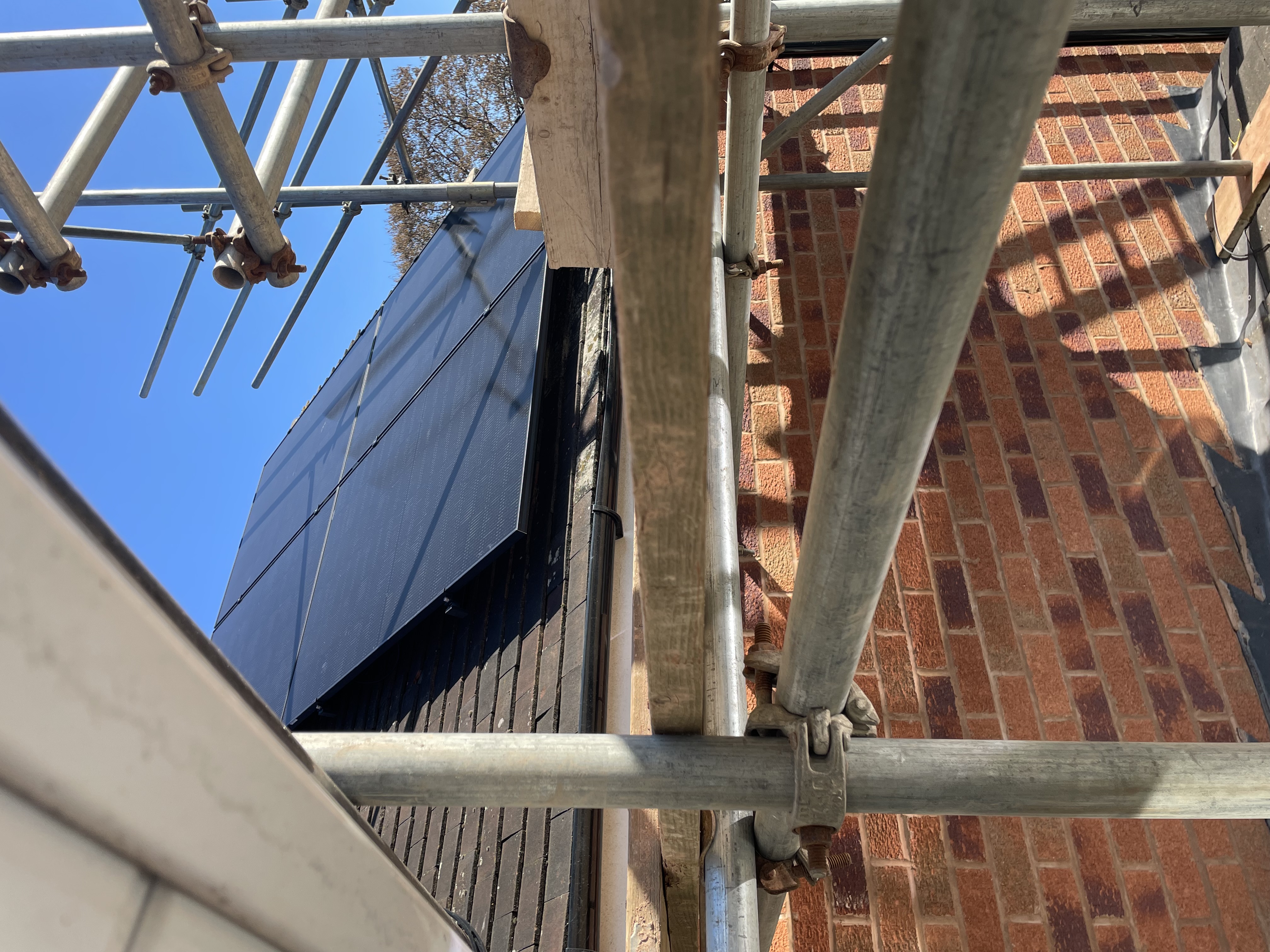

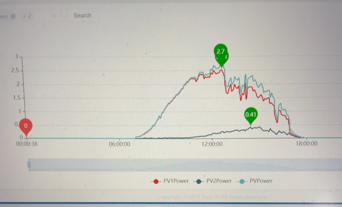

Hi, the suns shining today, clear blue sky’s, so I took some pics of the roof (west panels) and solar that’s being generated at that time. As you can see there is some shading from the scaffold poles but would it really stifle the generation this much?
Thanks and I appreciate your feedback. The scaffolding is due to be taken down in the next week. I guess I won’t know until that happens if it has such an effect.

Yes quite likely, because the main panel is in full sunlight those shadows are across the entire matrix so the panels built in bypass diode will try to remove the parts of the panel that are not performing (each panels is split into sub panels with bypass diodes on each).
Ironically like this you will probably get more power output on a bright cloudy day.
I think once the scaffold is down you should have normal output.
