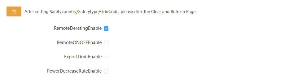

Hello, I have a customer who is having some problems with his plant. He currently has three H3 12 k inverters with batteries in parallel.
But at his plant there is more Inverters from other brands. But it is these three fox hybrids that are connected in parallel who controls the plant.
The problem is that he has more than 100 kwp, So every time he has a production of over 100 kW the hybrid begins to step down. Due to the export limit, the maximum can be set to 100 kW
Anyone know how to disable Export limit or increase above 100Kw

The limitation lies in the Foxess software,
