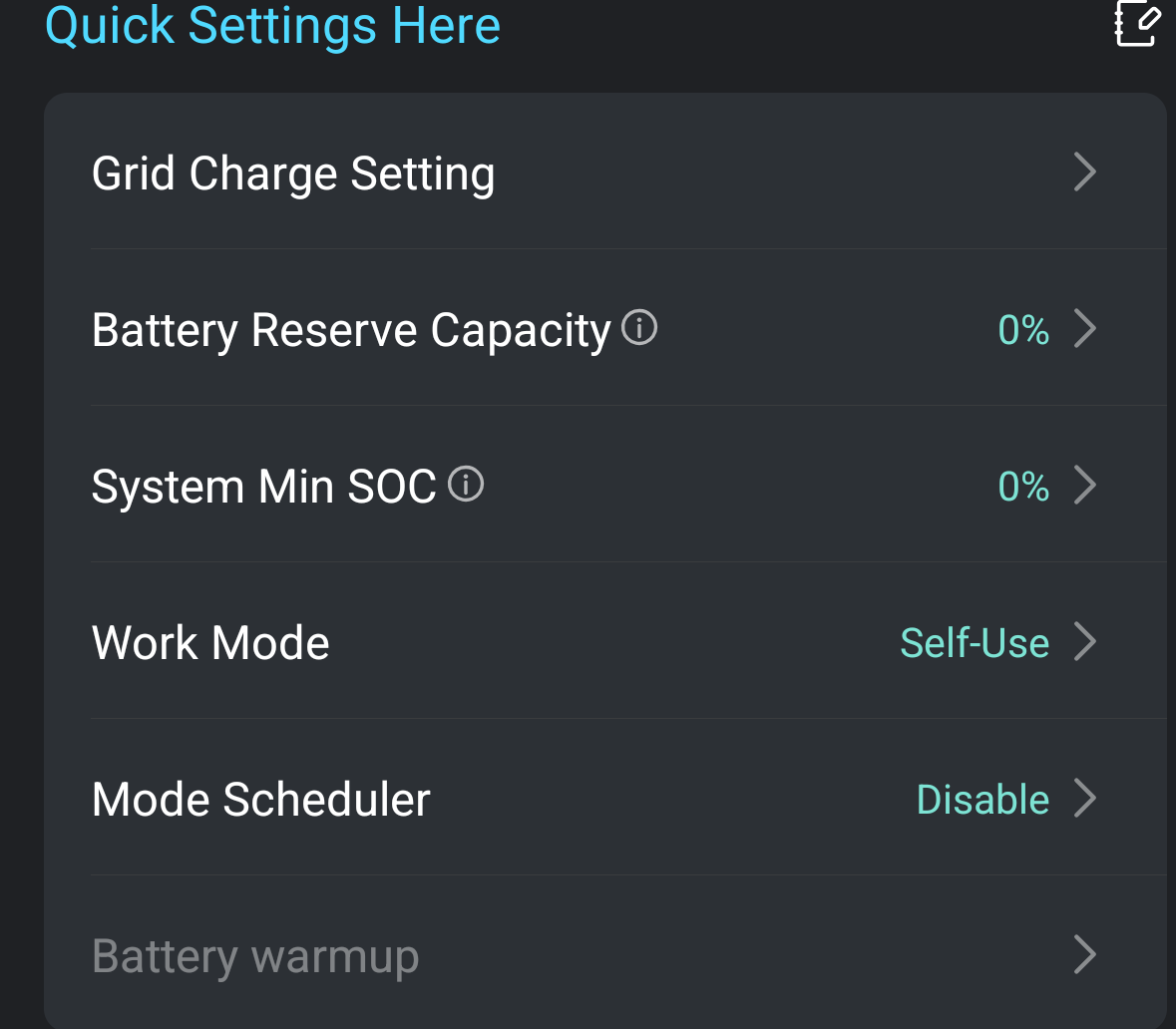

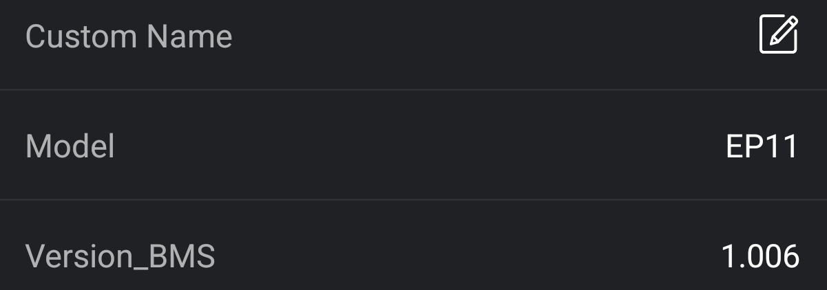

The BMS firmware is v1.006, but the "Battery warmup" element in Quick Settings is greyed out (see pic).

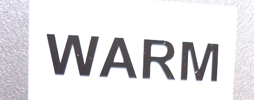

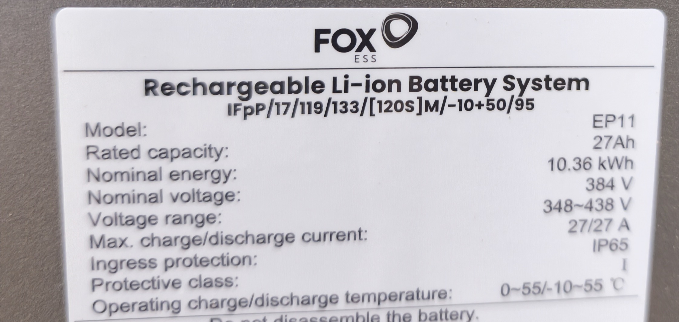

The battery details only show the model number as EP11 (see pic). Is it possible that this is not the heated version? There is a "WARM" label on the box, but the specs state no charging below 0C (see pics).

I raised a support ticket from the cloud 2 app, and it seems [edit:] they also needed something doing to the inverter.
The heater config options are now active on the app.

It’s the battery firmware that needs updating to allow the EP11 warmup options, your installer can upgrade this for you remotely - it might be worth also asking for you inverter firmware to be updated as unless done as part of the install it’s usually a good few versions out.alan.online@mybeehive.info wrote: ↑Thu Aug 28, 2025 1:15 pm Hi.
