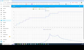

This is my EQ4800 battery stack charging to 100% SoC.
It shows the 15 minutes hold at 96% charge. The voltage curve is unexpected but clearly is being managed.
I think I will go with the following strategy:
Reduce charging current to say 5.3 amps at 93% charge.
Charge to 100% at least once per week.
Discharge to 10% at least once per week. (usual minimum charge is 13 -15%)
Normal charging current of 20 A. (Calculated 16 amps to charge from 15% to 93% in 5 hours)
Hopefully this will make sure the cells are kept balanced.
Thanks to everyone for excellent guidance.
Regards, Hugh
