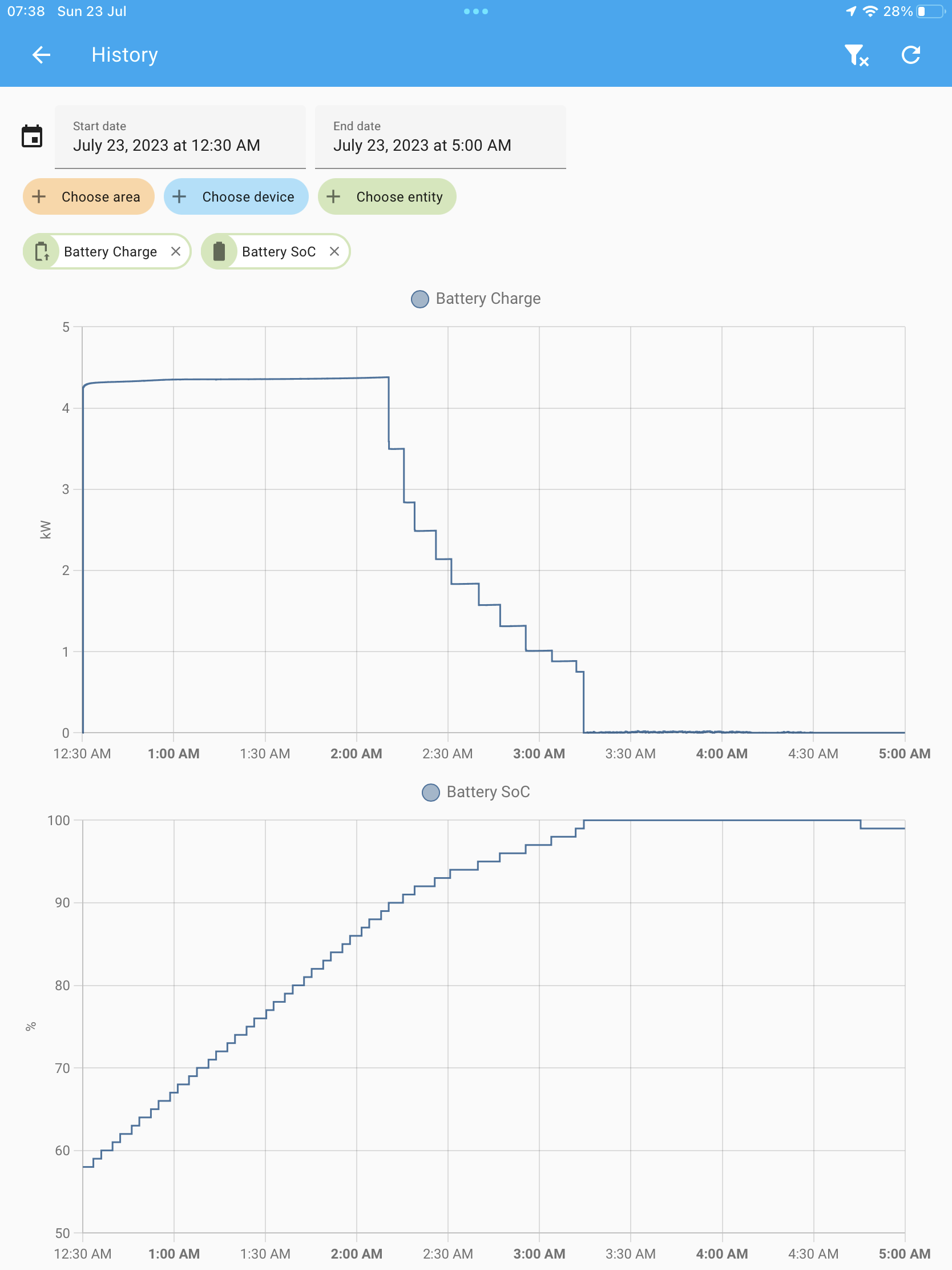

The Foxess battery charger (in the inverter) slows the charge it nears 100% SoC to avoid unnecessary heating and stress, it does this in large steps by ramping charge current often something like (4kw>2kw>1kw>off) - the BMS having access to all of the cell temperatures, voltages and SoC's has final control of the cut-off point and this is why occasionally you see the charge end whilst the battery is only 95% (ish) this happens more often with solar charge because SoC has drifted over time.
The more advanced battery chargers watch individual voltage and cell temperatures, and they reduce the charge current whilst holding charge voltage - this avoids the rapid internal temperature rise and it gives the batteries the maximum time for the charge to be absorbed safely and also helps improve top balancing.
The Foxess charger (in the inverter) ramps the charge current down as it approaches full (the BMS controls it using the BMS charge rate register) but it is not that fine a control, and often occurs too near the limit and does not appear to voltage hold whilst reducing current.
It does a reasonable job, in winter the warming of the batteries is a good thing but in summer it can add excessive heat stress and so I have adapted the charge profile using a Home Assistant automation and RS485 interface to the inverter so that it gives me a finer control, I use this to gradually taper the charge current once the battery passes 80% SoC and it has a very soft profile above 90%.

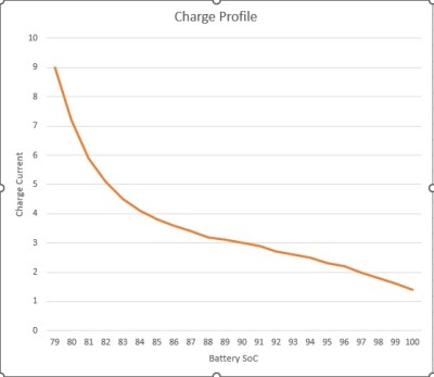

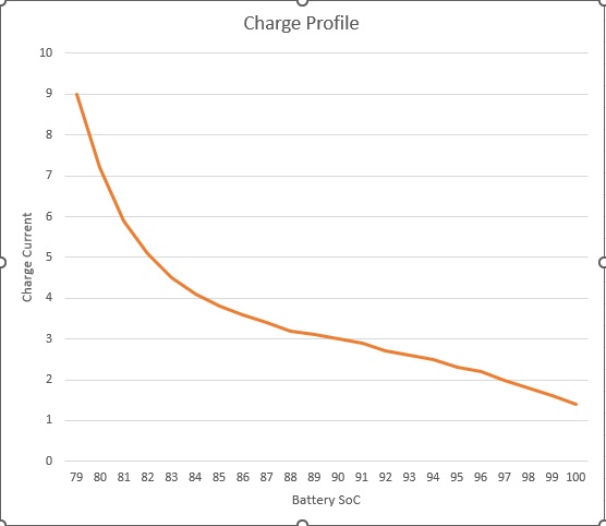

Using this automation will change the day charge profile to look as follows -

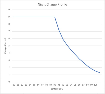

and the night charge profile as this -

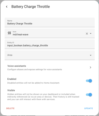

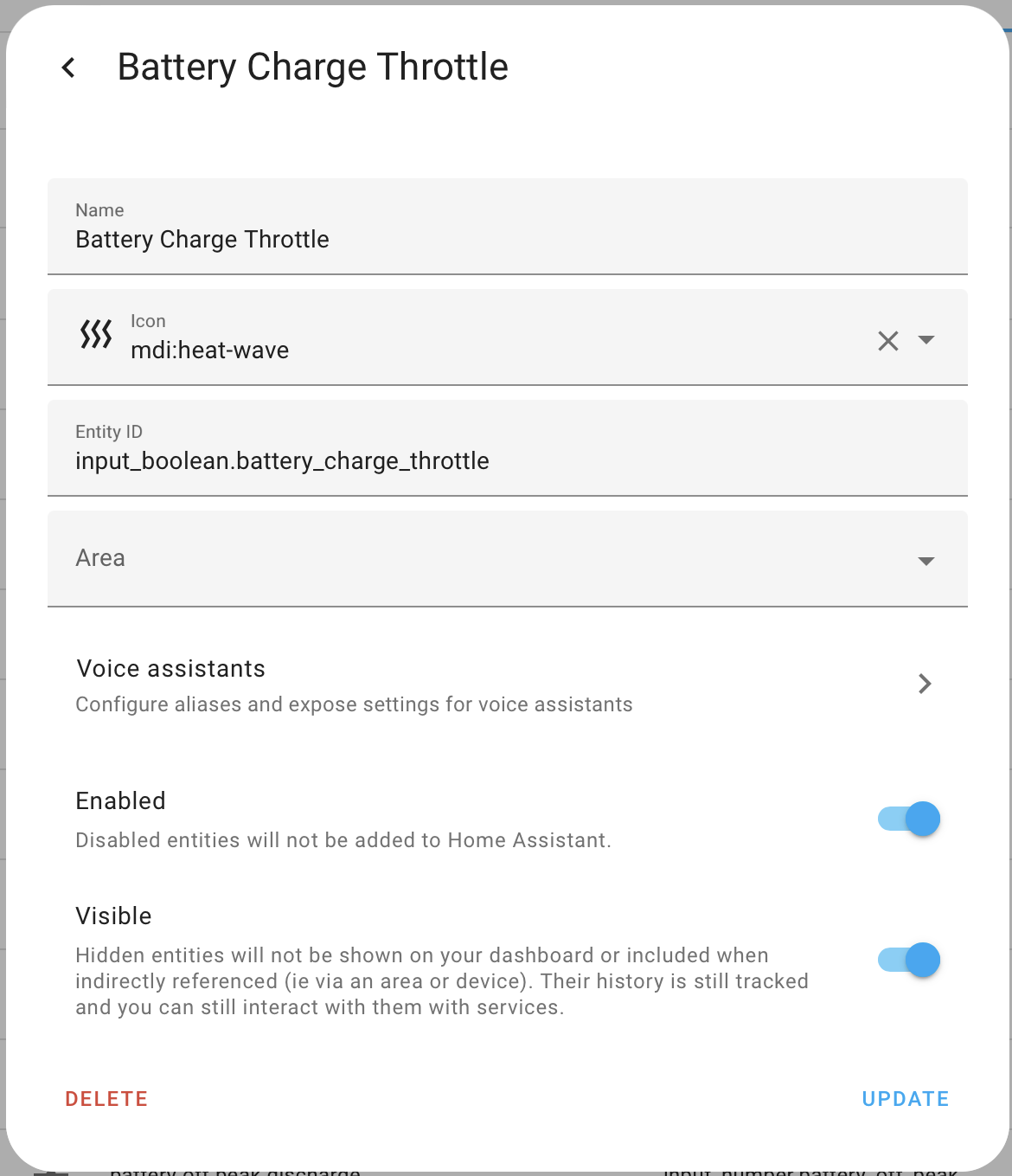

The first helper is a toggle that enables or disables the charge throttle automation - I typically have it switched on all the time, the main reason I turn it off is speed of charge - reducing the battery current takes the charge much longer to complete, it will achieve 80% in the usual time it takes, whereas the final 20% can take several hours to complete - very useful when charging from solar in summer, but not so useful when charging off-grid during a short eco tariff period in winter.
Helpers can be created in Home Assistant by going into Settings, Devices & Services, click on 'Helpers' at top right of the screen, click '+ CREATE HELPER' and the select Toggle.
It should be set as follows -

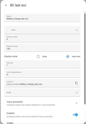

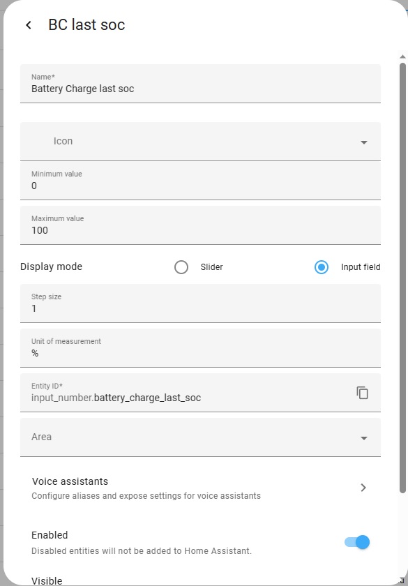

The second helper is used by the automation to record what the battery_soc was last time it was triggered, and makes it not trigger again until the battery_soc changes.
As above go to create a helper, choose 'Number' and set is as follows -

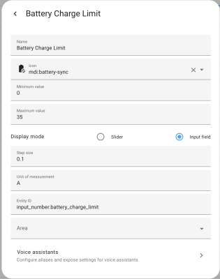

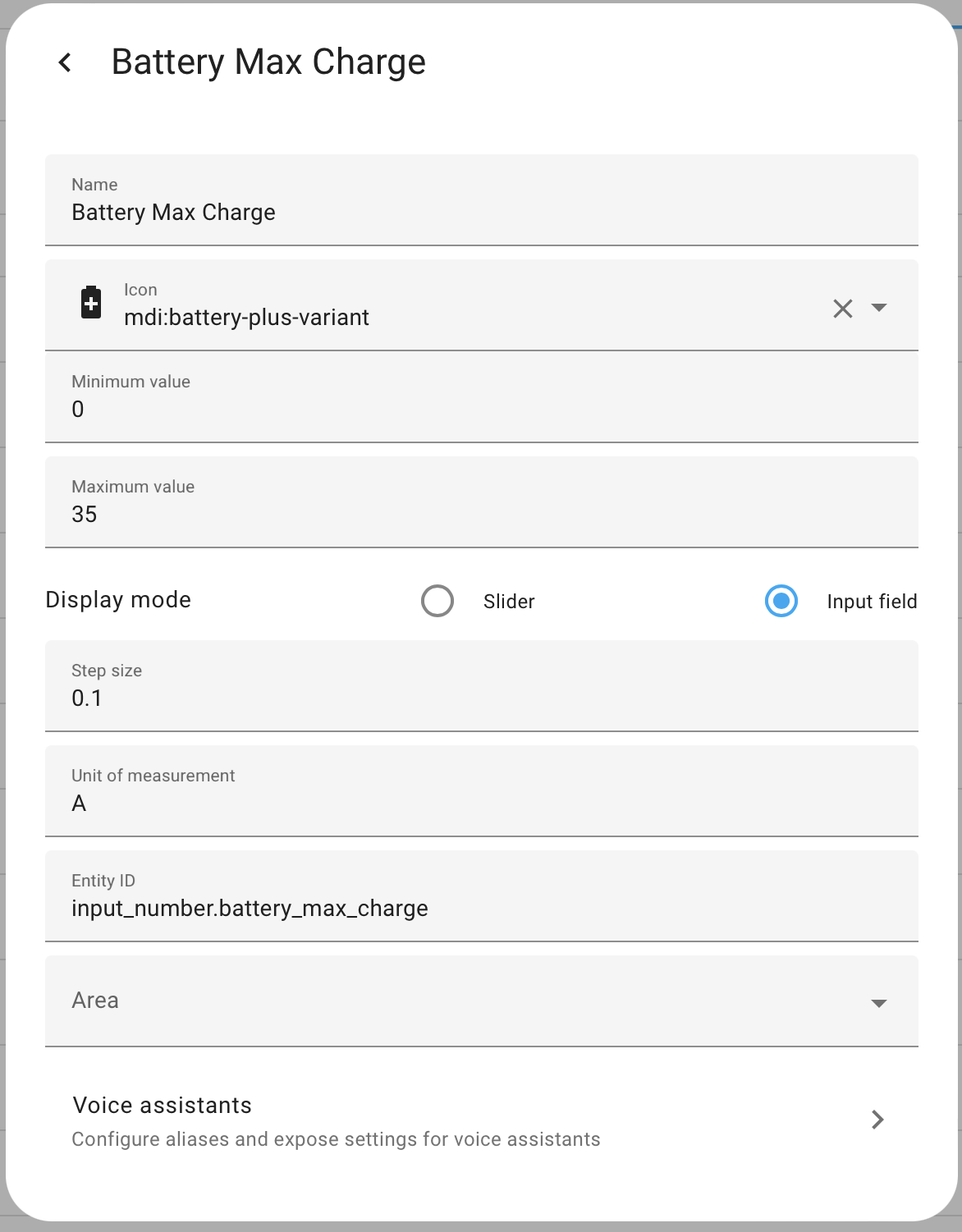

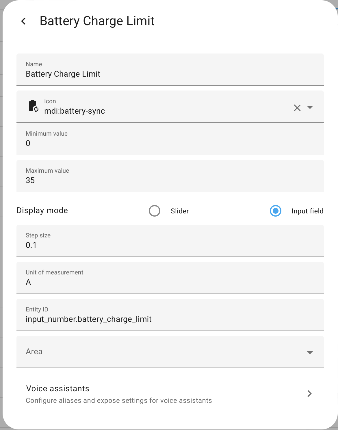

The third helper is a number that is used to hold the calculated charge value in amps, it should be sets as follows -
The next helper is used to hold the maximum battery dc charge current - this is the maximum value the charge current will be for a normal charge, it is also used as the base multiplier for the charge current calculation.
To calculate the desired charge current from your normal charge rate - if you have a normal charge rate of 4kw, you need look at your nominal battery voltage (the mid point between high and low) - for example on an HV2600 pack with 4 batteries this will be approx 211V. Current (A) = Power(W) / Volts(V) so in this example 4kw = 4000W/211V = 19A and you would set the maximum charge rate to 19A
If desired you can reduce this to limit the max charge your inverter uses (useful in summer to balance charge with export), or increase it, the maxmimum charge you can achieve is usually the Hybrid inverter limit or the maximum PV string output if greater i.e. H1-3.7 is 3.7kw, H1-5.0 is 5kw.

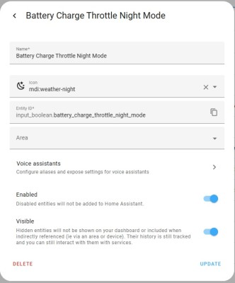

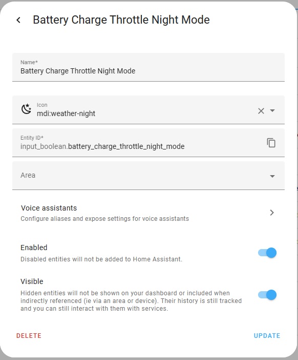

The final helper is used to select Day or Night mode, Day mode uses the day charge curve (longer and slower charge to make use of the full days solar, it slows charge dramatically above 80% SoC), Night mode uses the night charge curve (shorter and faster in duration to make use of low tariff grid charging, it only operates from 90% SoC).

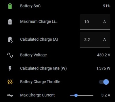

Then create a sensor that is used simply as a display to show you the current charge rate in watts - this is based on the current charge rate and battery voltage.
It looks like this

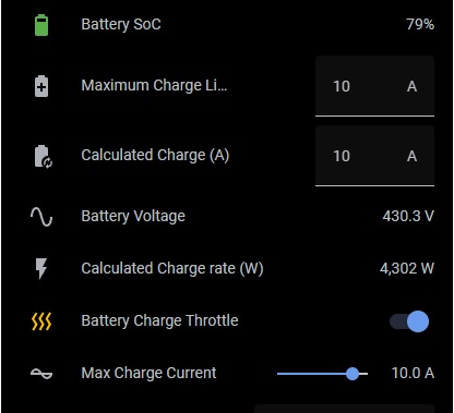

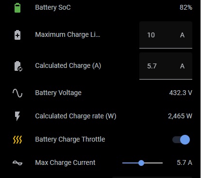

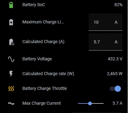

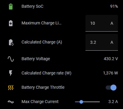

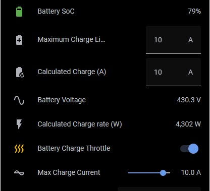

DASHBOARD CARDS
Create a card in your dashboard with the following
Code: Select all
type: entities
entities:
  - entity: sensor.battery_soc
  - entity: input_number.battery_max_charge
    name: Maximum Charge Limit
  - entity: input_number.battery_charge_limit
    name: Calculated Charge (A)
  - entity: sensor.batvolt
  - entity: sensor.current_charge_rate
    name: Calculated Charge rate (W)
  - entity: input_boolean.battery_charge_throttle
  - entity: input_boolean.battery_charge_throttle_night_mode
state_color: true

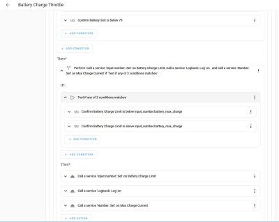

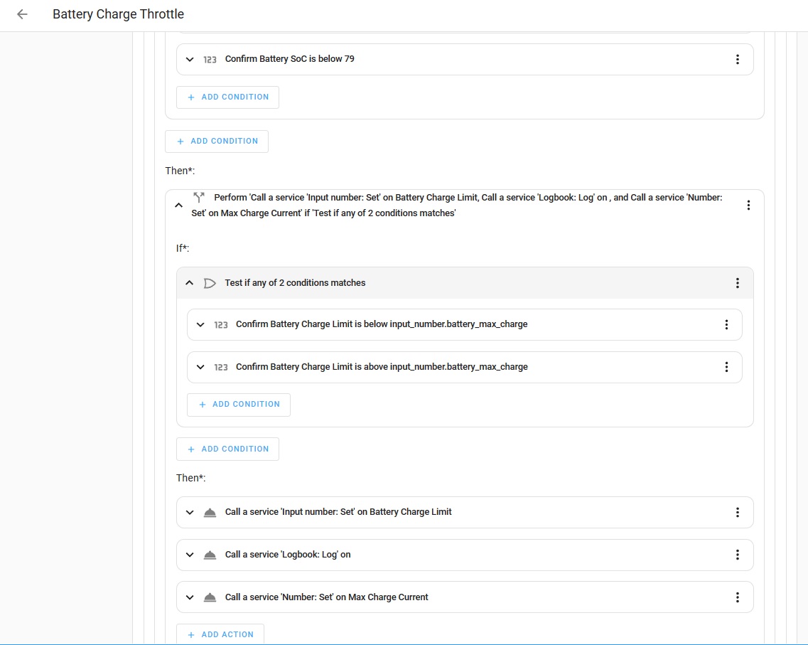

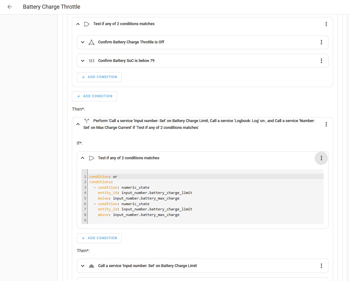

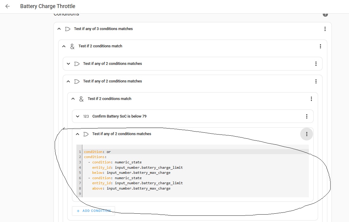

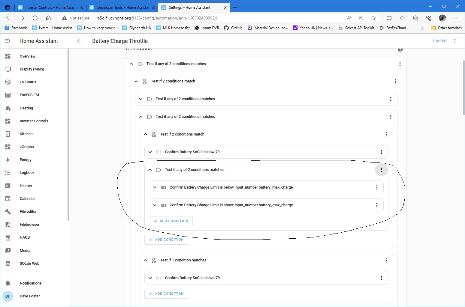

AUTOMATION
And finally add the automation which makes sense of all this -
Settings, Automations, '+ CREATE AUTOMATION', 'create new automation (start from scratch)', switch to YAML mode by clicking the three dots in the top right corner and 'edit in yaml', then copy this code over the top of the blank code there.
Code: Select all
alias: Battery Charge Throttle
description: ""
trigger:
  - platform: time_pattern
    seconds: /30
condition:
  - condition: or
    conditions:
      - condition: and
        conditions:
          - condition: or
            conditions:
              - condition: numeric_state
                entity_id: sensor.battery_soc
                above: input_number.battery_charge_last_soc
                below: input_number.battery_charge_last_soc
          - condition: or
            conditions:
              - condition: and
                conditions:
                    below: 79
                  - condition: or
                    conditions:
                        entity_id: input_number.battery_charge_limit
                        below: input_number.battery_max_charge
                        above: input_number.battery_max_charge
              - condition: and
                conditions:
                    above: 79
      - condition: time
        after: "07:00:00"
        before: "07:01:00"
      - condition: time
        after: "20:00:00"
        before: "20:01:00"

Some examples of the sensors at various battery_soc's (this is an 8 pack system, ~422V nominal)

I'm also reminding myself here that I made two small changes to mine, specifically:
input_number.bc_last_soc => input_number.battery_charge_last_soc (for my future clarity!)
tools.jinja => charge_curve_day.jinja (in case I end up with two different charge curve .jinja files as discussed above)

I've made a few changes to the code, a couple were to bring the notes and my code in line with the name changes you made as that will make it easier when I add in the night/day mode - i've modified the name of the bc_last_soc counter to be battery_charge_last_soc, and have changed the name of the jinja import file to be charge_curve_day.jinja - all the notes above and the code have been updated to reflect these naming conventions.
I realised when you turn off the battery charge throttle switch the charge limit does not get reset to maximum, if you leave it switched on it used to happen when the battery_soc dropped below 80% but if you turn it off it never got reset - this has now been corrected in the version above, when you turn it off at the next soc change it will reset to maximum charge.
I also did away with the script as the latest integration exposes the dc charge current setting directly and so the script is no longer required, nor is the helper that it used 'input_number.max_charge_current' - once you update to this version you can delete the script and remove that helper (or leave it in, it won't do any harm).
Because the sensor for current_charge_rate used this helper it requires a change to the template, so replace 'input_number.max_charge_current' with the integration version called 'number.max_charge_current' (see sensor code segment above) and refresh templates in Developer Tools.
Then just over-write your battery charge throttle automation code with the version above - if you have updated your device name where it sends a notification you will need to reselect the device in the automation editor again.
Hopefully that should be it, a lot easier without the script and we're using the same name conventions - i'll get onto the day/night profile when i've got a spare hour or two.

Ok all tested, and i've updated the notes above - I've changed the notifications so that everything goes to the logbook now rather than to a special device, it's easier and more consistent as it works anywhere without changes.
As you're already running you only need to add the second jinja import file (charge_curve_night), the final helper battery_charge_throttle_night_mode and overwrite your automation with the one above, I had previously changed the last_soc and tools.jinja to match yours so it should all just work - but please double check it (and note the change to the rate sensor which uses 'number.' and not 'input_number' as it now talks directly to the modbus integration and not via the script).
Finally just add to your HA card the entity for battery charge throttle night mode and then you can see it's state.
Operationally it uses time to make the night/day change - at 7am it will switch to 'day' mode and at 8pm it will change to 'night' mode.
I've preset the night mode charge to do nothing until 90% then taper down - On my system it takes that last 10% one hour to complete so you might want to tweak it to suit your charge times.
Night looks like this on my system -
You can change the mode back to night during the day if you want to accelerate your charge and it will automatically switch back the following day

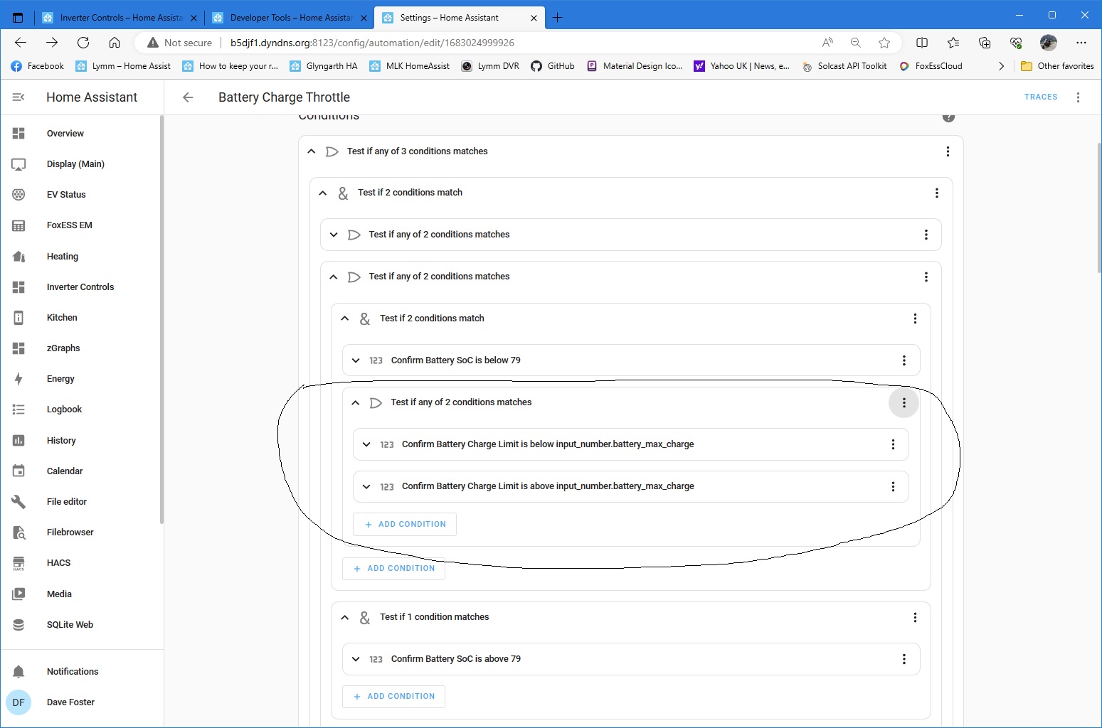

Posts: 1786
@Calum - just done a quick fix to the automation - it wouldn't normally happen but I have a habit of turning my max battery charge current down at night when i'm charging my car so my HV batteries don't discharge, instead I let them have a trickle charge rate.
This fix isn't critical if you don't manually reduce the max battery charge, but here it is anyway (possibly easier to copy the code above in entirety but i've shown the changes below)
The fix is in the test for SoC below 79 where it resets the battery charge limit, it used to happen if the battery charge limit was 'below' the max battery charge - but i've now added 'above' to that as well so it resets if they are not the same.
I have changed what was a single test when 'below', it now tests for 'below' OR 'above' (it is in 2 places)
The code above is modified, these are the conditions I changed here
The first one in the conditions near the top (first in visual, then yaml modes)
The second one is near the bottom of the code in the IF
You can replace the single test yaml with this in both case -
Code: Select all
condition: or
conditions:
