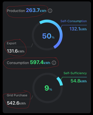

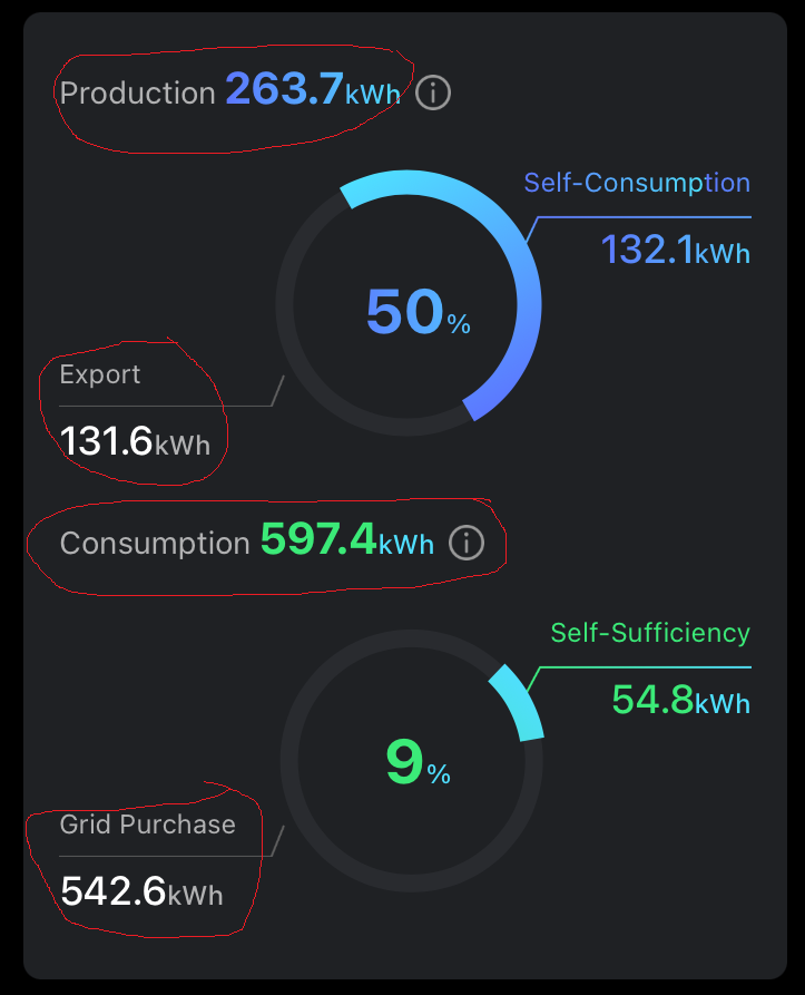

There isn't enough information there to calculate -
If you use the V2 app and look at October 2024 can you post your 'Production', 'Export', 'Grid Consumption' and 'Grid Purchase' values please (see image)
Can you also confirm whether you have any other sources of solar generation, additional inverters etc...
