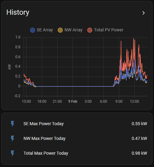

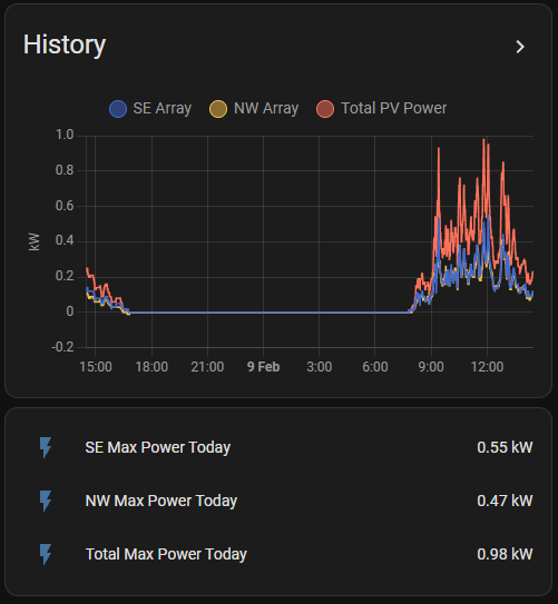

reef
Posts: 131
Location: East Yorkshire
Thanks Dave.
Rather annoyingly it's dull and generation has stopped, so I can't see if it's working yet. Fingers crossed! :D
reef
Posts: 131
Thanks again Dave, that works perfectly. :)
