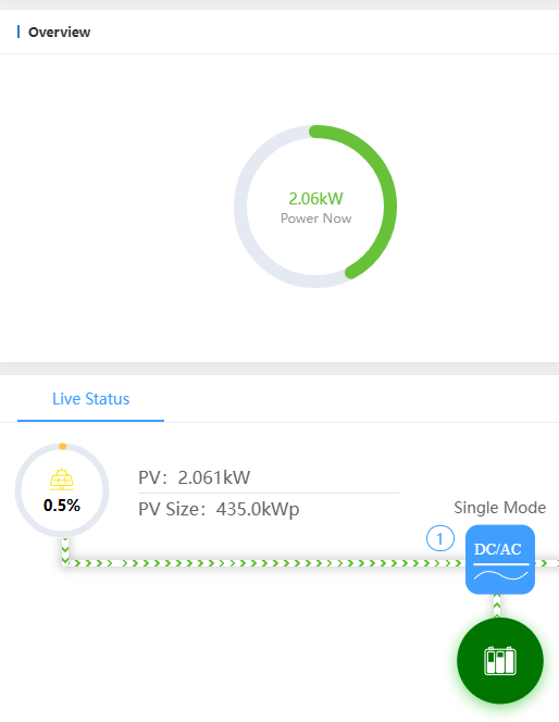

Can anybody let me know what the 0.5% on the desktop version is telling me?
I can see it represents the % power being produced v the PV size is 0.5%, but surely this is never likely to rise much higher.
Just intrigued, as it seems a little odd and meaningless.

It is showing you the ratio between the current pv power and the size of your array.
But you seem to have set your arrays generation power to 435kWp (very impressive but i'm guessing entered wrong) - to change it edit your site and enter your array maximum size mine is 6.25kwp (i.e. 6.25 kWp at full power)

Dave Foster wrote: Thu Jan 30, 2025 3:22 pm It is showing you the ratio between the current pv power and the size of your array.
Thanks Dave, that makes some sense now. The 435kWp was set by the installer, which I never queried as it is 10 panels x 435W = 4350W.
I will change it to 6.25Kwp as suggested.
If you have 10 @ 435, change it to 4.35kWp or you'll never see 100%
