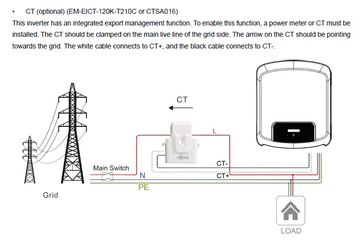

I found the installation/user manual for the inverter online and in the small print it mentions an optional CT clamp but implies that the clamp is only required for limiting any exported power to the grid to a maximum of 5 kW so would not be required for my system which has a maximum output of only 3.6 kW. The installers left a CT clamp and a communication connector for plugging into the inverter but did not fit the clamp and did not connect it to the inverter. I did not expect it to make any difference but I tried fitting the clamp and connecting it to the inverter as shown in the user manual. As I expected, it made absolutely no difference to the readings shown on the FoxCloud2.0 app so I have removed the clamp and disconnected it from the inverter.

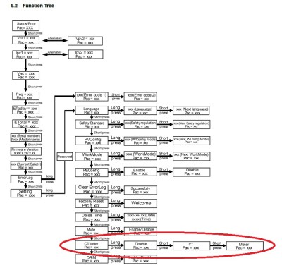

I agree with you that a CT clamp is obviously necessary to measure the current, even though the Inverter manual implies that a CT clamp is only required for the export management function, so I have refitted the CT clamp onto the line cable into the house from the outside meter as the user manual suggests (see below) The placement suggests to me that the CT clamp is measuring the current to or from the grid, rather than the load current, but I suppose that the load current can be derived by subtracting the current sent to the grid from the current output from the inverter (or adding the current received from the grid to the current output from the inverter).

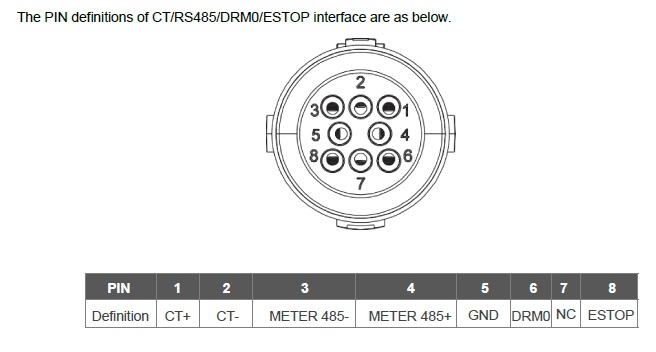

I also checked the connection from the CT clamp to the communication socket on the inverter to ensure that the CT+ wire is connected to pin 1 and the CT- wire is connected to pin 2 (the manual says that the CT+ wire is white and the CT- wire is black, but the wires from the CT clamp supplied are red and black, so I assumed that the red wire was the CT+).
However, connecting the CT clamp again made no difference to the zero values shown on the FoxCloud2.0 app, so I am wondering if the CT clamp is disabled by the inverter and I need to configure the inverter's configuration setting.

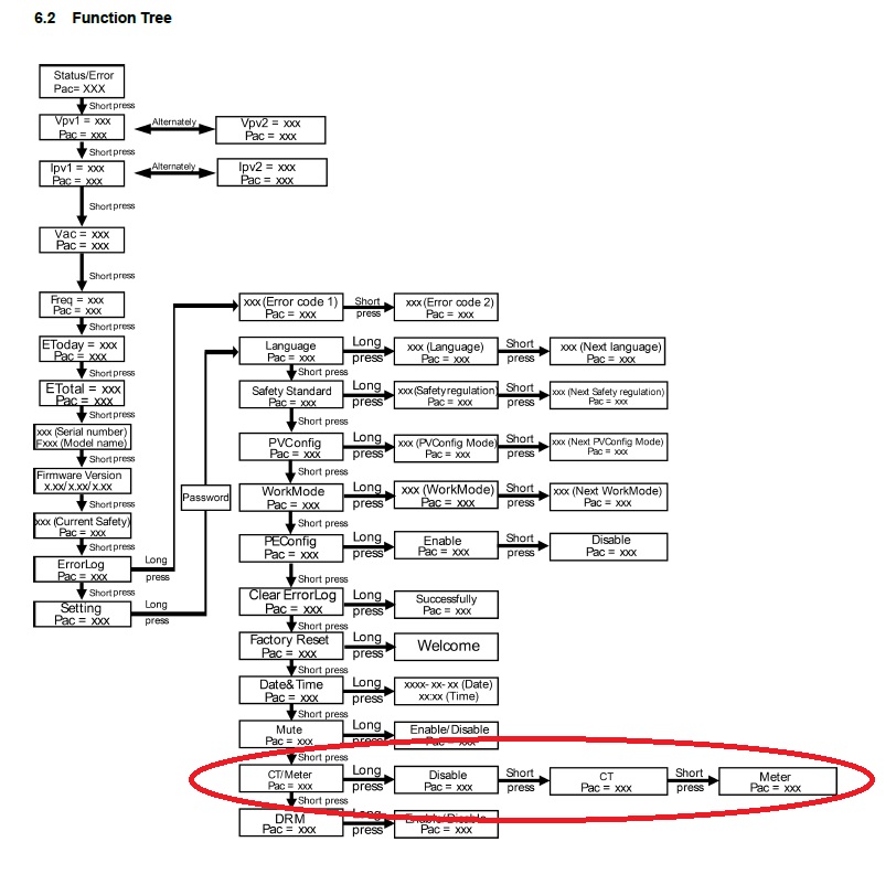

Oh yes, you will need to enable it on the inverter.

Thanks again Will.
I checked the inverter configuration (luckily, the default password was still valid) and, sure enough, the CT clamp function was shown as disabled, so I enabled it.
Just as I had finished doing so, the light level outside reduced enough for the inverter to go offline, so I will check tomorrow to see what difference the configuration change has made.
