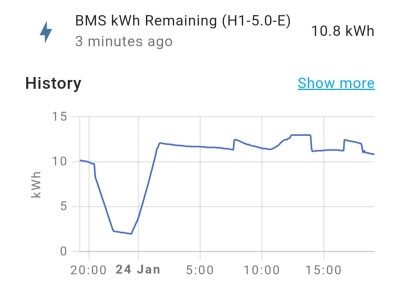

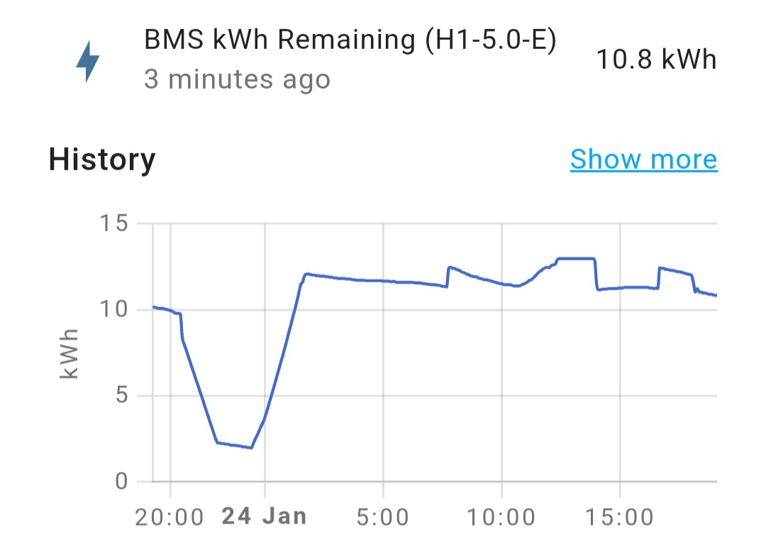

As Dave mentions above, the capacity will reduce as the batteries get colder. I have 6 HV25 batteries at 92% SOH, so about 13.2kWh usable, however at this time of year it's more like 11kWh when they are cold. Here's a trace showing how the BMS has to re-adjust the expected remaining capacity as the temperature changes. From around 2am they are at or near 100% SOC the whole time:
