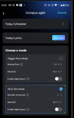

Hello. I am on the Octopus Agile tariff and use the Fox ESS app to automatically set charging according to 'Time Slot Mode' where it will automatically select the cheapest periods to charge.

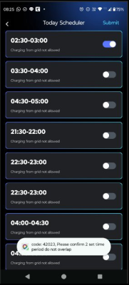

Around once per week, I get a problem where the 'Today Scheduler' screen gets populated with many time slots including duplicated ones. When this occurs no time slots can be enabled and I get the error message:
"code: 42023. Please confirm 2 set time period do not overlap".
I am unable to remove the duplicate slots.
I think this occurs when some cheap slots are before midnight and some after midnight, spanning 2 days. As there are many days when this problem does not occur.
