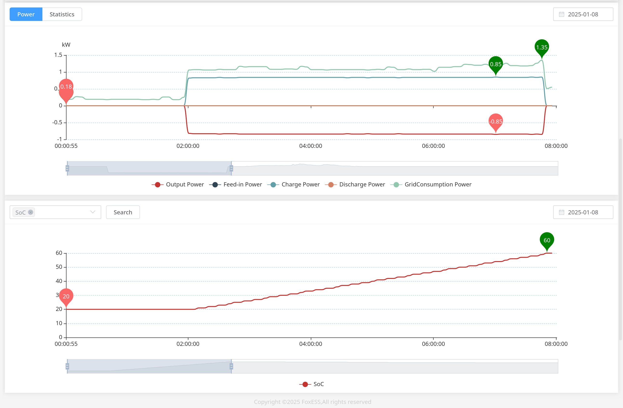

On the morning of the 8th, it started charging as expected at 02:00 (20%), but continued until 07:50 (60%), 2h 50m past the end of the cheap rate period:
The 60% SoC seems to be a common theme here. My concern is that the system is choosing to charge the battery from the grid outside of the cheapest rate period.

The charge power is really low, that only happens when the BMS is throttling the charge because of temperature (or at minSoC which you are not), the V2 app will show the lowest cell temp which is what everything triggers from - on the 4th it was reporting 1.5C and at 0C the batteries stop charging all together so much of this is the BMS trying to maintain it's operation.
As soon as the ambient temperature rises you will see your charge rates recover, I can't see what inverter spec you have but at 20C the batteries will charge from grid at just under the inverters rated capacity i.e. 5kW would charge at approx 4.8kWh.
If the batteries are outside they will be affected by cold weather (mostly affecting the charge rate) but when they fall below 0C they will stop discharging soon after - a lot of people build an insulated enclosure for this time of year which helps stabilise the temperature - there is a link here viewtopic.php?p=5465 to an example of what other users have used but if you search for insulation there will be quite a few hits.
