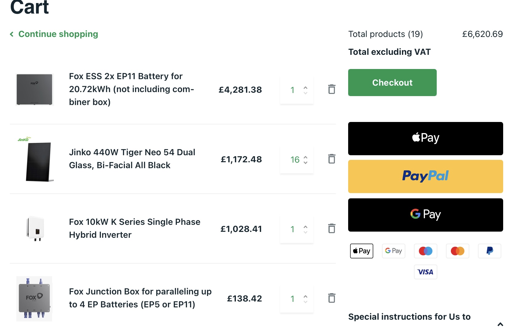

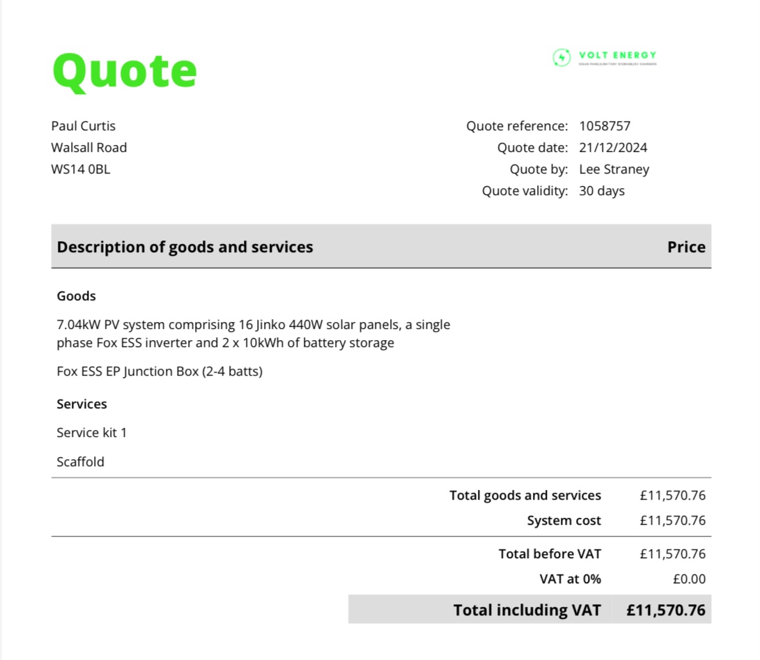

Just had a quote, obviously he will have to uninstall the old inverter and batteries, get the DNO, installation and scaffolding (£600 he told me) so almost £5,000 labour, is that the going rate? what do you guys think of it?
No that's not entirely correct (despite what the datasheet says) it must always be mounted to a wall, but when floor mounted they are only floor mounted in as far as they rest their weight on the floor - they still have to be fixed to a wall mount, and the battery hung on the mounts (as an anti-topple - these are 100kg batteries and will make a mess if they tip over).
That’s good news then, I was thinking of using a bracket to hold them steady, but I probably couldn’t wall mount then off of the floor because my car port is made of wood, though the beams are thick.Dave Foster wrote: ↑Sun Dec 22, 2024 9:20 amNo that's not entirely correct (despite what the datasheet says) it must always be mounted to a wall, but when floor mounted they are only floor mounted in as far as they rest their weight on the floor - they still have to be fixed to a wall mount, and the battery hung on the mounts (as an anti-topple - these are 100kg batteries and will make a mess if they tip over).
It's a very good quote if thats including the install. Under £12k for 16 panels, 10kW inverter and 20kWh of batteries is excellent.
