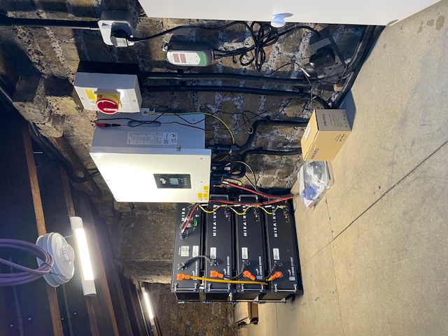

Thanks. Ah, I thought you had them split into two stacks, e.g. 3+BMS and another 3 next to it. But upright might also help to spread the load.
Mine looks like this.
