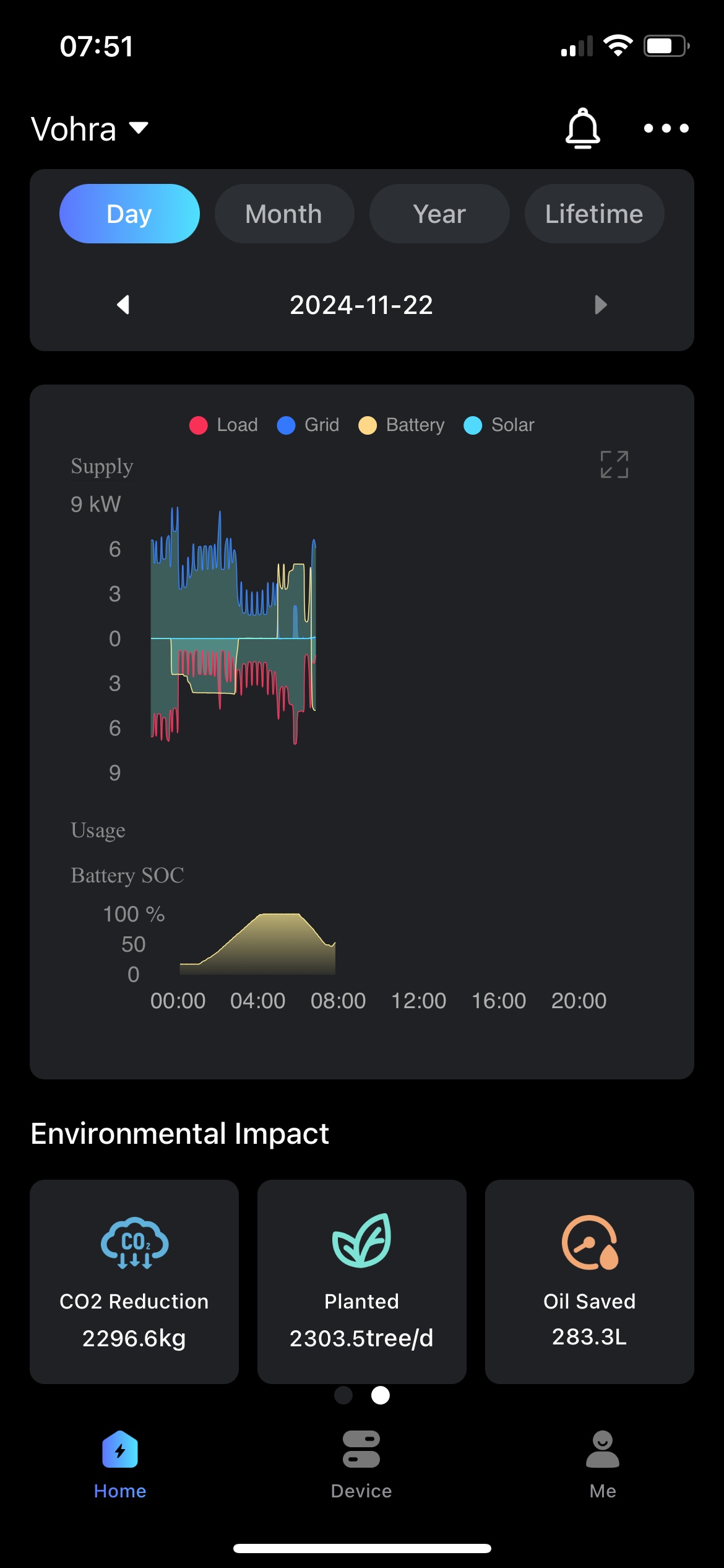

I have been charging our batteries overnight on the slightly cheaper Octopus Flux tariff. The last 2 nights I have noticed that the batteries have charged up to 100% then discharged to about 40 to 50%. This is happening during the night when there is very little draw from the grid as most energy sucking devices are switched off.
Is this normal ??? Are the batteries faulty ?
We have not had this problem before , there only difference over the last few days is that the outside temperature has been sub zero. The batteries are in our garage.
I have tried to attach an image
Any thoughts regarding this ?

That graph is showing quite a substantial load being drawn over night - do you have any heaters running, or an EV charging.

No heaters on at night . I figured the big draw is the batteries charging over night from 0100 to 0600.

huminga1 wrote: Fri Nov 22, 2024 10:44 pm Hi Dave,
No the batteries charging doesn't show as load (it shows as 'battery' instead), you have something switching on in your house which explains why the battery is draining - given it's cold at the moment do you have any kind of heater, greenhouse, garage, space heater that will now be coming on.
It's easier to see the load if you log into the website foxesscloud.com, and you will see it at the bottom of the first page - click on the label to remove output power and that will just show your grid consumption and load power over 24 hours. - you can scroll backwards through the date on the right and hopefully see where it started.

Thank you so much for responding . I'll have a look at this. I cant think what could be on..... Would the oil central heating kicking in about 6.30 am do it ?
Anyway, Ill have a good look at it and many many thanks for the advice, really appreciated.
