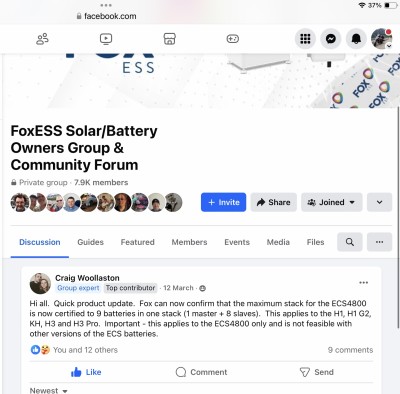

According to their uk service director in March this year, the ECS batteries can be scaled to 1+8 batteries on the KH inverter (see image for the post that confirms it). But the ECS4800’s are now called the EQ4800 and I was told it is only the EQ4800 that scales to 9.
I’d send this post to Fox UK service and ask for them to confirm.

That's great thank you. I'll ping them this post and see what they say.
Thanks again.
