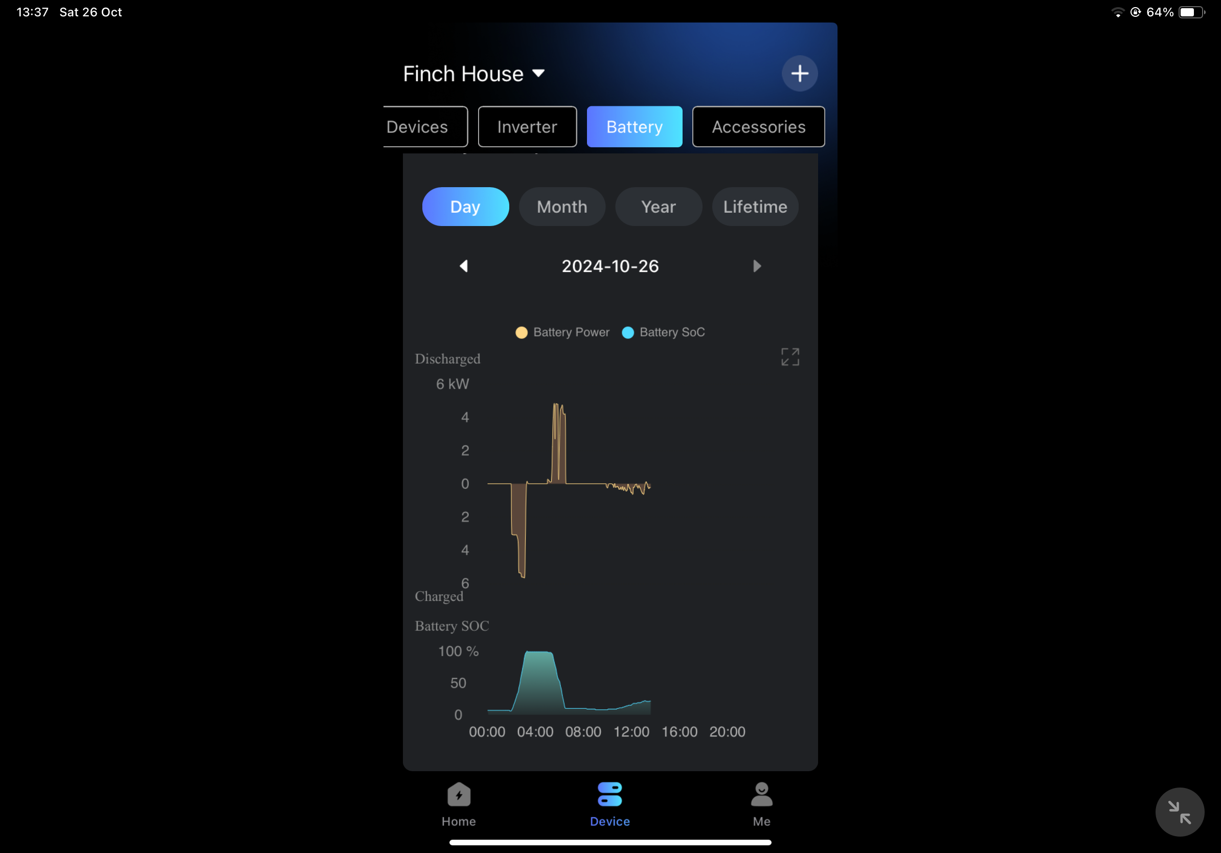

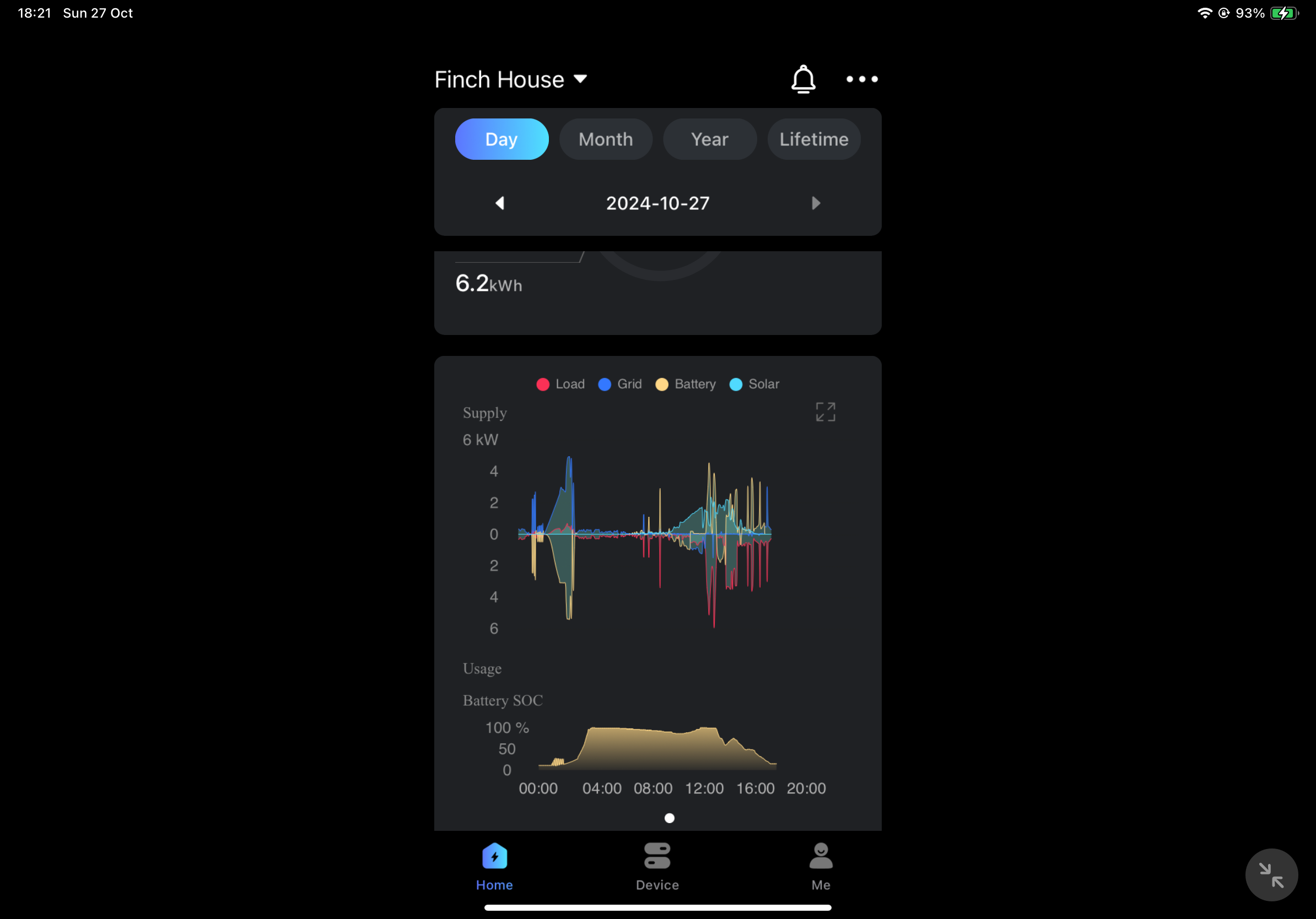

Hi Dave thanks for coming back so quickly. I know very little about the system. We already had solar panels on a new build house, then the battery was added and the inverter upgraded to fit with the battery. I have attached a pic of this morning.
Re: Battery discharging to 10% in an hour
Also, we don’t have an ev charging and no large appliances. Heating/ hot water on air source heat pump running 24/7 but nothing kicks in early morning that I can find
Yes that looks very much like the CT clamp is pointing in the wrong direction - you have 2 options, call the installer and ask them to rectify it, or you could locate and turn the clamp around yourself, it's not too difficult,

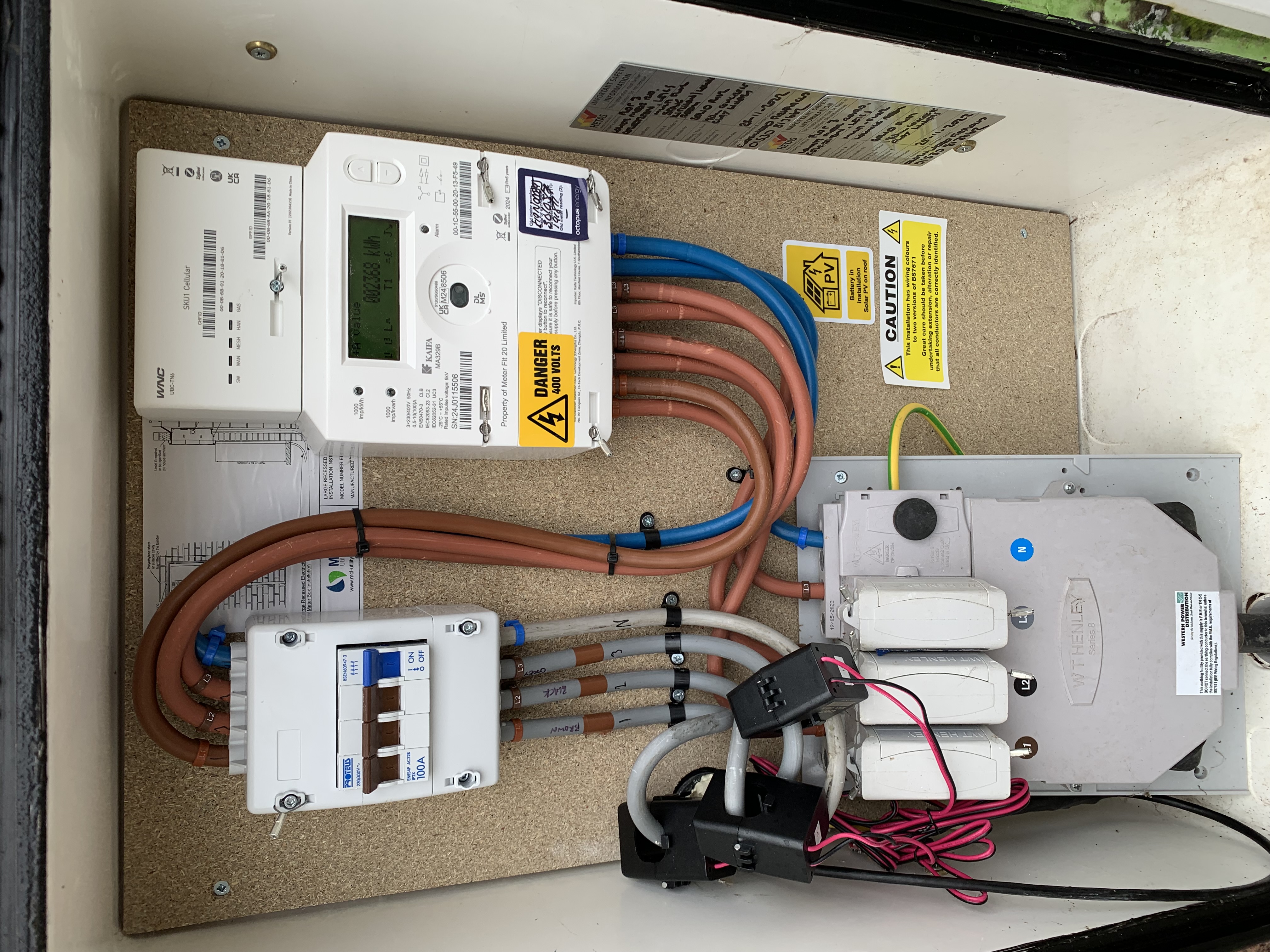

Have just checked the smart meter and can’t see anything that looks like the Ct clamp shown?
Ahh ok, it's a 3 phase house - basically the same principle but you have 3 CT clamps that measure the load on each phase.
It could be one CT clamp, 2 or all 3 that are the wrong way round, so yes best to call your installer and they can test each phase to make sure it is reading correct.

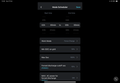

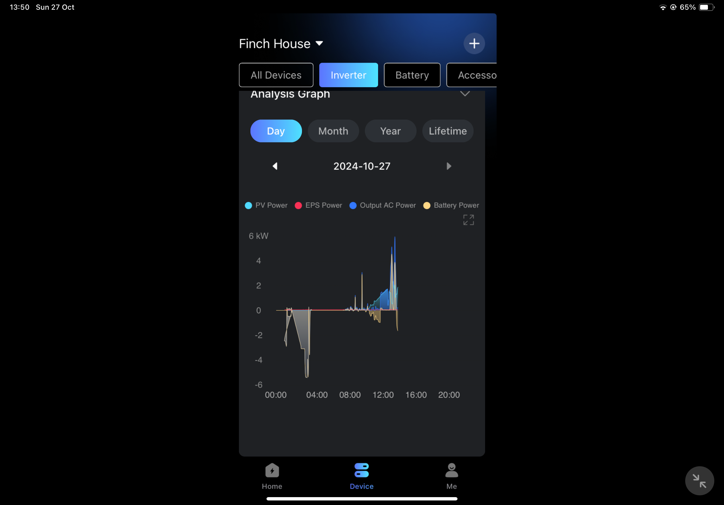

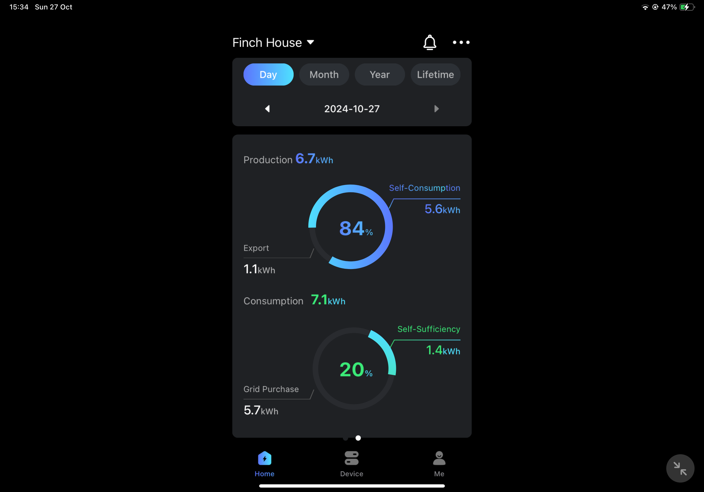

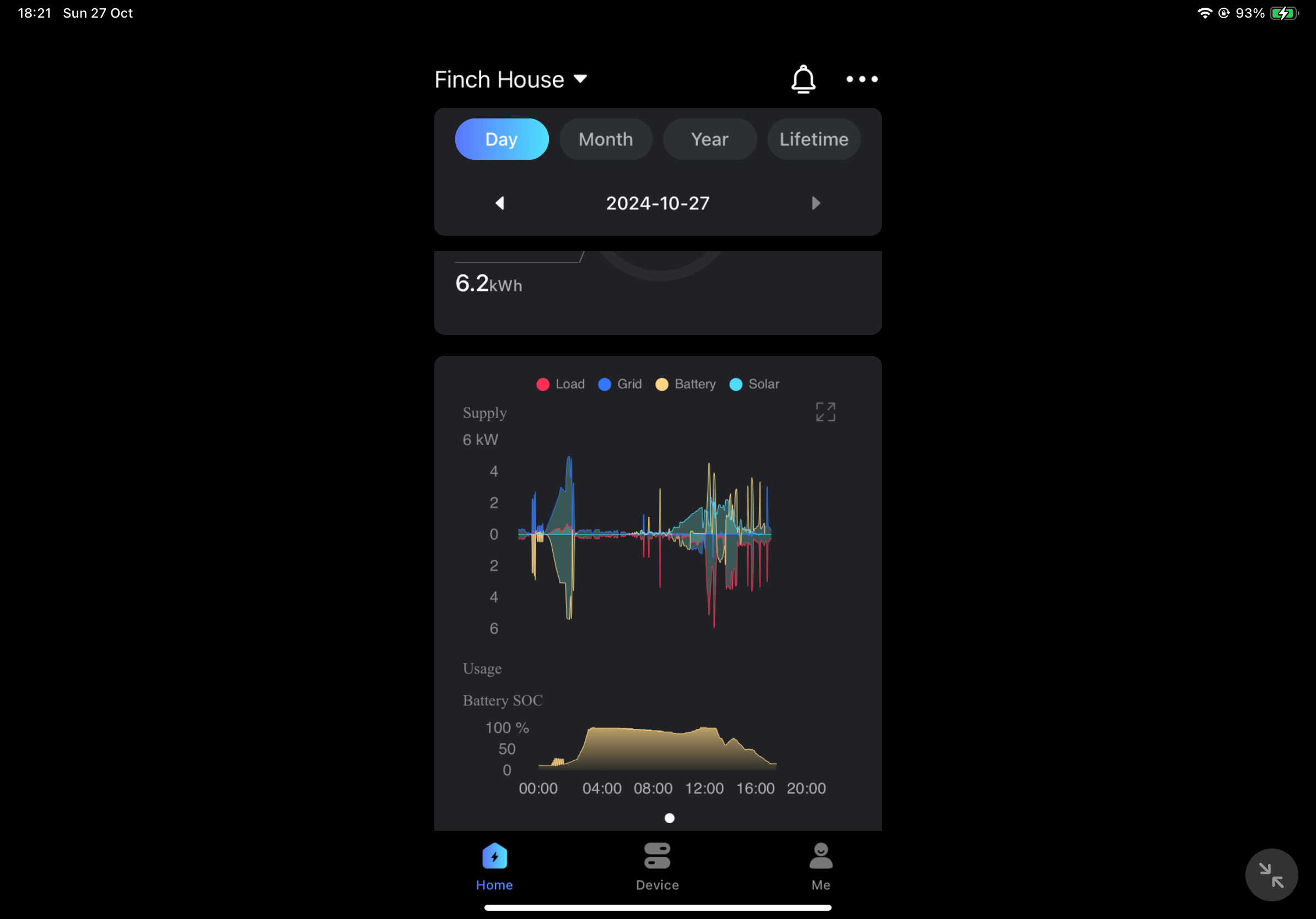

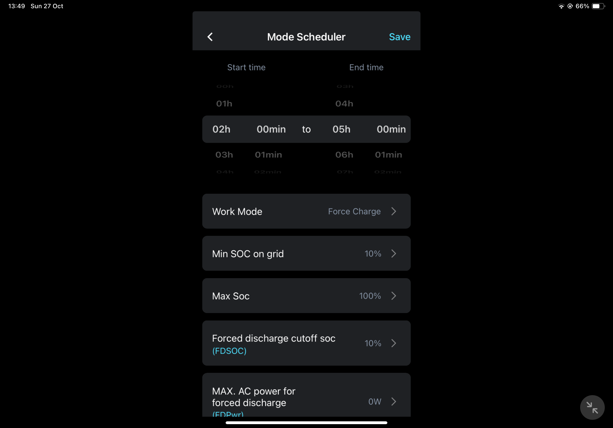

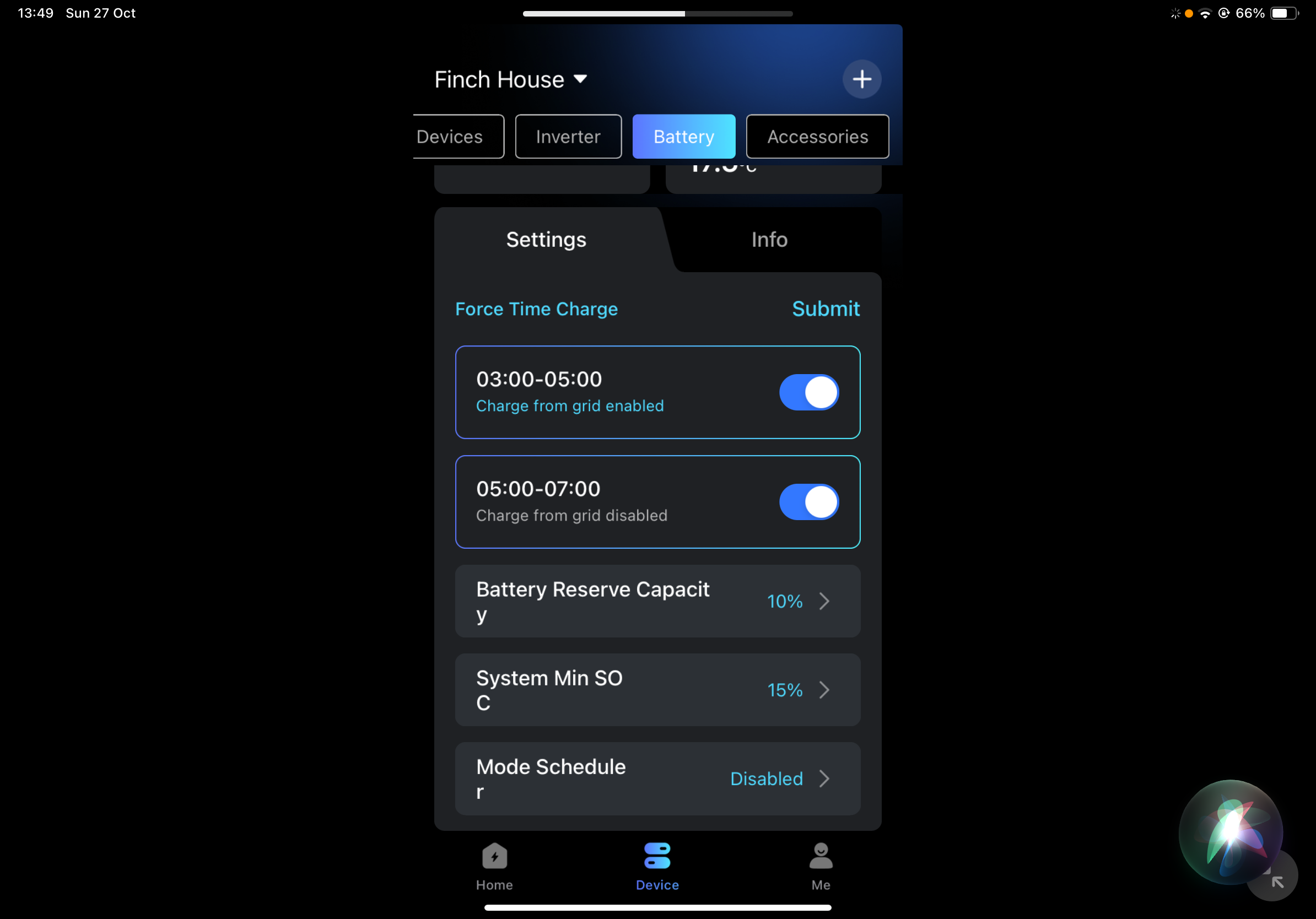

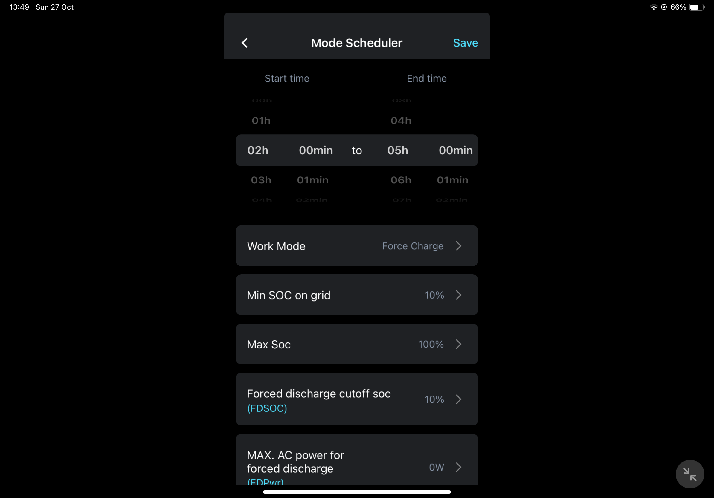

Ok so I have been doing some more digging since yesterday and come up with a sort of solution till tomorrow. The set up I had when the battery was discharging itself is in the third pic, and then I tried a different set up last night where the battery did not discharge itself and still had plenty of charge this morning. 1st and 2nd pics
Is there anything wrong with the settings on the mode scheduler or do you still think it is probably the CT clamp?
You’ve set it to charge the battery between 3 & 5am, and then not to use the battery at all from 5 til 7 which will stop it discharging - but the big question remains why was the battery discharging after 5am when there is no house load, that is usually a sign of reversed CT clamp if there was no load present.

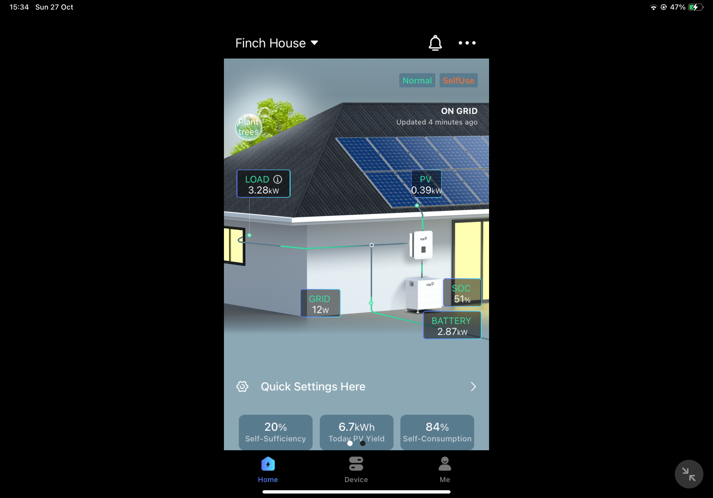

Can you post a shot of your energy flow (the overview page that shows the house) and also on that page if you swipe left and post the graph at the bottom of that page (as it shows house load).
Hi Dave, these have just been taken

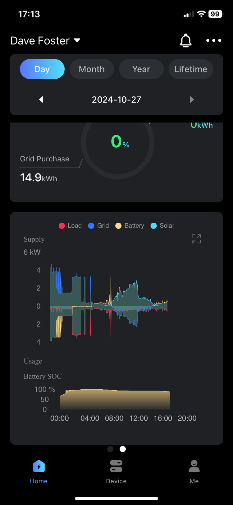

On that first image, when you swipe left can you scroll up the page and you should find a graph at the bottom of the page that looks like this -
That will be really useful to see as it shows your house load, solar, grid use and battery together

Here it is
I can’t see much wrong with that trace, the load appears to be showing correctly which it wouldn’t if the CT’s were the wrong way round and the battery is taking charge when there is spare solar and you are exporting (a little) as well.
It is possible that one CT phase is wrong but i’m not seeing evidence there.
I would be inclined to let it run like this and see how the system performs over the next few days.

Should i run the mode scheduler rather than the way I have it now as at least I have full battery in the morning at the moment when i didn't when running the mode scheduler? Can you see anything that is taking a big load early morning?
No I think it’s best to leave it the way it is, the charge periods can only charge or hold the discharge, whereas the mode scheduler can really change the behaviour as well as force the batteries to discharge.
There’s no obvious load at 5am so hopefully a few days of running like this will give you some confidence in the system.
