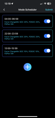

So I have solar panels and a battery with Octopuses Cosy tariff.
Now that Octopus have 3 periods where its cheaper to charge the battery I have had to enable the mode scheduler to put 3 time periods to charge the battery from the grid.
This works great between 04:00-06:59 and 22:00-23:59 as there is no sunlight but between 13:00-15:59 I need it to chrage the battery/supply the load from PV first and then grrid.
I currently have all 3 of these periods set to force charge. How can I set the daytime period to force charge from sunlight and then grid?

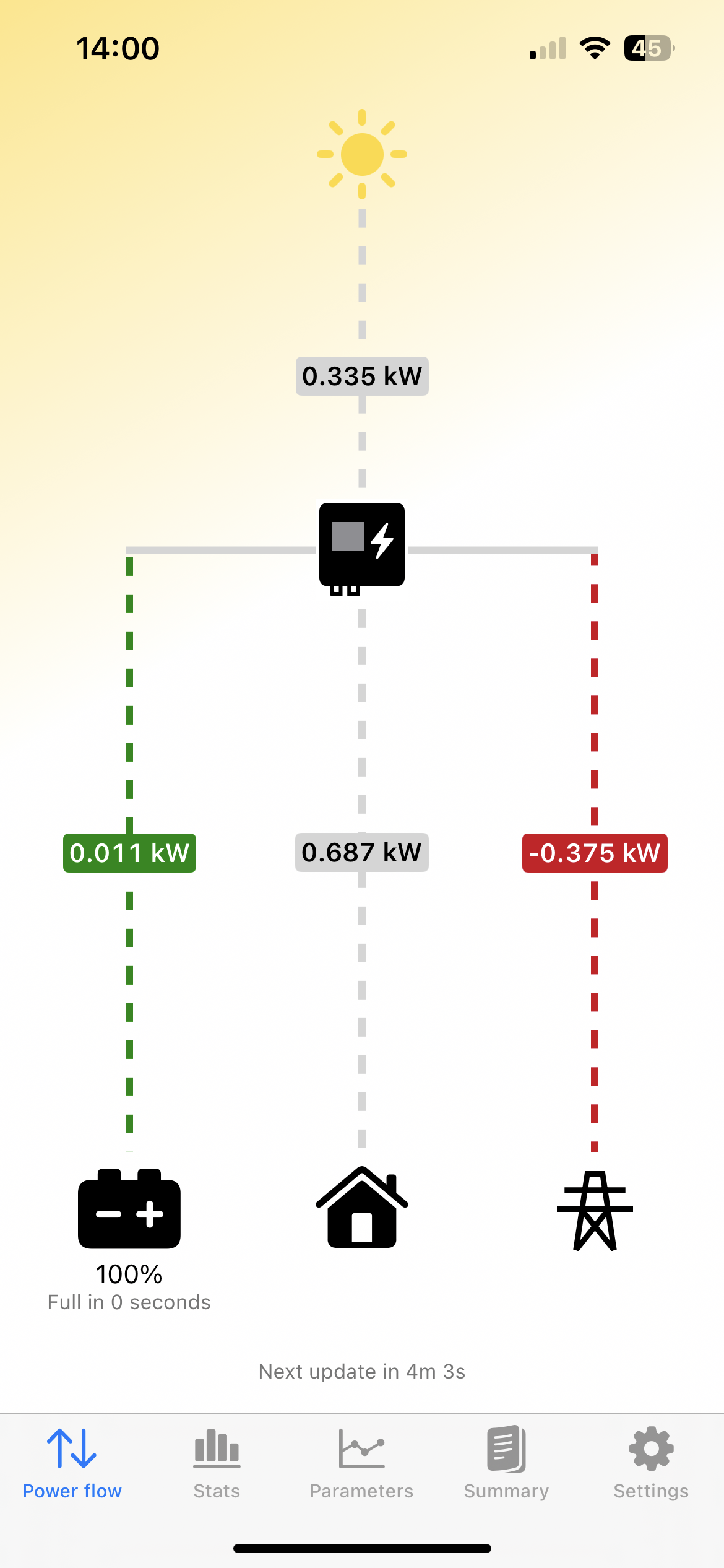

I have just changed this schedule over to Backup. Seems to be drawing from PV and grid to charge the battery. Does this seem right? Is it the best option?

As far as backup work mode goes, that prioritises battery over export so it will use the PV to charge your battery and it won't discharge the battery either.

Hi Dave, thanks for the reply!
So backup mode kind of works for now but probably not the best solution.
Version ARM is showing as 1.70 and master is 1.63. If there is a firmware update to help with this, that would be great!
