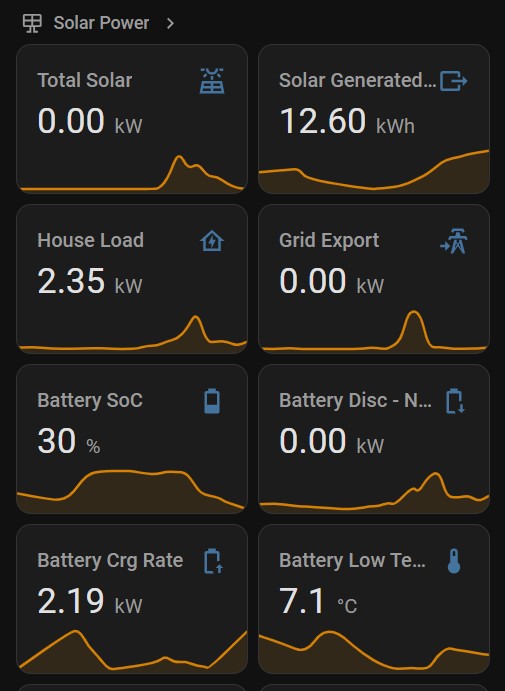

Ah brilliant - thanks! Just watching the you-tube on the subject having just found it - needs to be front page of the forum methinks!!
Maybe another thread about temperatures of batteries - we've had a rude awakening to temp problems, now mostly sorted with heating mats, but given current weather in the UK, I think a lot of folk would benefit.
Thanks again for the help!

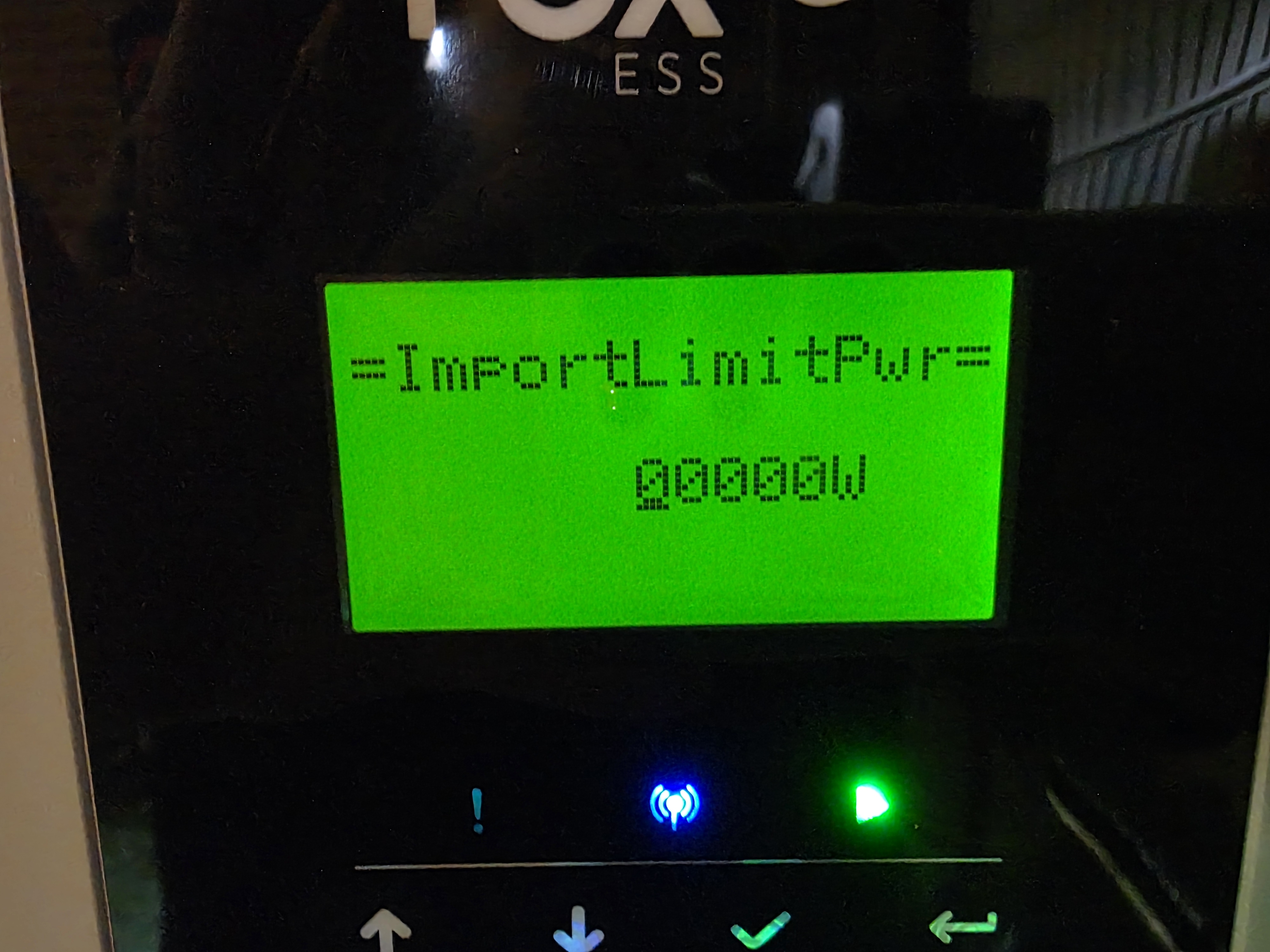

Dave Foster wrote: ↑Mon Jan 12, 2026 9:53 am If you've had a recent firmware upgrade, it's worth checking to see if that has reset your import power limit, check that at your inverter panel, in Settings (password =0,0,0,0), on-grid, Export Control and see if you have an item called ImportLimitPwr - if you have what is it set to ? (should be at least 6000 watts)
Was just looking through some of the forum posts, and came across this one ..... I have never "checked" this setting before, as everything has been working (apart from battery heatint issues). I have had a few firmware updates over the last week or so ... so took a look .. and mind is showing, as below ... should I be setting this? What is this preventing?

albie999 wrote: ↑Wed Jan 14, 2026 1:56 pm
This setting controls the maximum amount of power the inverter is allowed to demand from the grid, when set to zero it won’t be able to take anything, so you won’t get any battery charging, i’m guessing no battery heating from grid also (but that has a mind all of it’s own).
On a normal system it should never be set to 0, at a minimum it should be set to the same size as your inverter in watts, but often bigger if you have EV’s, water heaters or heat pumps fitted - in essence whatever the size of your incoming fuse is i.e. 80A multiple that by 253V.
if you have no reason to limit the demand from your grid, it really should be set as high as it will let you, the default (not set) is supposed to be 30,000 although this doesn’t seem to work on all firmware versions and so you may want to set a value as high as you can such as 15000 (watts).

Just enable charge from grid for 10 mins to test .. and all seems to be charging fine

That earlier post (with screenshots) was withouth changing anything on the inverter ... so with the 00000 set ... should that have worked?
Re: Battery not importing from grid
albie999 wrote: ↑Wed Jan 14, 2026 6:51 pm That earlier post (with screenshots) was withouth changing anything on the inverter ... so with the 00000 set ... should that have worked?
Technically no, it shouldn't have worked… but there is also an ImportLimitCur (usually set to 100A) which may be taking precedence - are you running latest inverter firmware ?

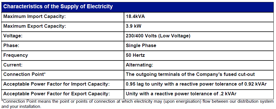

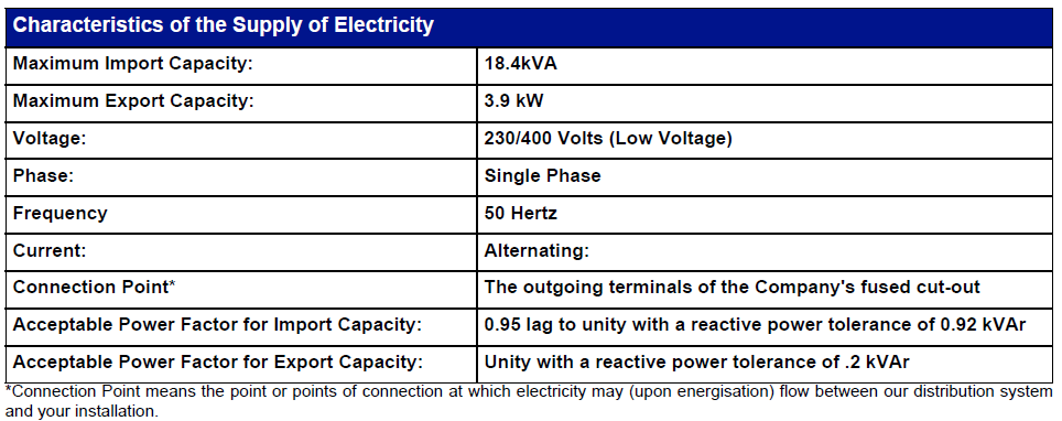

The G99 calculated the grid Voltage as 230V
So 18.4kVA is calculated as 230V x 80 Amp = 18400W
I would set a tentative 63 Amp value (or around 60 Amp) for your current limit, and if that works in testing, you can set your ImportPwr to 23000 W

MaterialBarracuda48 wrote: ↑Sun Apr 05, 2026 1:12 pm

r4w wrote: ↑Sun Apr 05, 2026 1:42 pm Isn't the G99 only for export? I saw in a few posts in this thread that Dave said that the power is 253V x fuse capacity. But if I use 230V x 48 (previous setting), that is exactly 11KWh, so maybe that is a safer way to calculate that. I doubt I will ever reach 20KWh at any given time, so I could play it safe by setting it to circa 86A / 20000 KWh. Does that make sense?
It is for export, but as you can see they have included the import value, and the calculations use 230V.
The 253V is max grid power, but not used to calculate the values you input to the system.
Up to you what you input, it's only used to throttle the inverter down.
