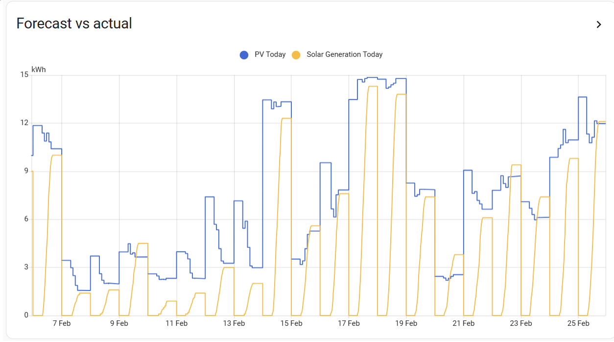

So here you can see the forecast being refined as the day progresses (blue), versus the actual generation (yellow). You can request the forecast up to 10 times per day. So perhaps once every 3 hours overnight, and once every couple of hours during the day.
From Solcast, the single figure will be in sensor.solcast_pv_forecast_forecast_today or sensor.solcast_pv_forecast_forecast_tomorrow.

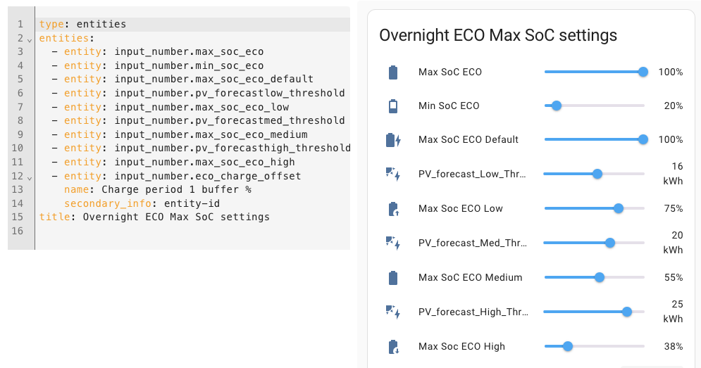

Had exactly same thoughts as yourself Hugh, I created a few helpers to play with slider input numbers for boundaries and set desired Max SoC % levels for the ECO 2am-5am period to avoid charging overnight just to start exporting the next morning
a snippet of my automation:
I'm using Octopus FLUX so ECO is a fixed off peak rate 2am-5am

I've gone for a simple solution with an automation running before midnight using
Code: Select all
entity_id: sensor.solcast_pv_forecast_forecast_tomorrow
Code: Select all
alias: "Energy: set Max SoC ECO based on tomorrow's PV forecast"
description: Sets the Max SoC ECO according to the forecast for tomorrow
triggers:
- at: "22:15:00"
trigger: time
conditions: []
actions:
- choose:
- conditions:
- condition: numeric_state
above: input_number.pv_forecast_high_threshold. <<<<<<< this boundary for kWh forecast from the slider input on the dash
sequence:
- target:
entity_id: input_number.max_soc_eco <<<<<<< this value gets set a the number.max_soc on the inverter somewhere else triggered at 2am
data:
value: "{{ states('input_number.max_soc_eco_high') | float(0) }}". <<<<<<< this % from the slider input on the dash
action: input_number.set_value
- conditions:
above: input_number.pv_forecast_med_threshold
.... med, low and a default .. logging etc
thanks again!
